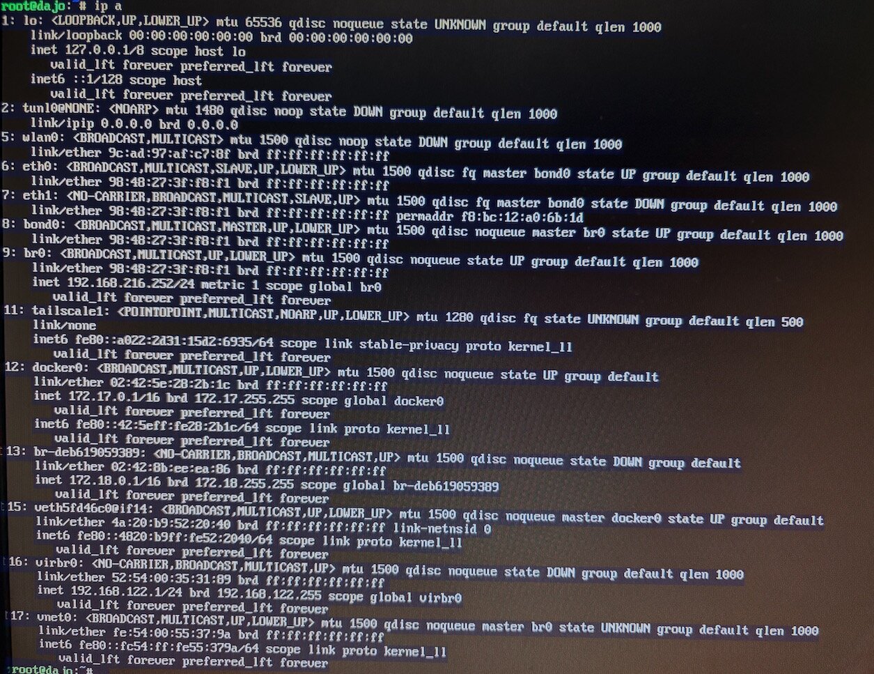

  1. I am sure. My router assigns from .2 to .99 Any ideas from the diagnostics?
  2. attached. thank you dajo-diagnostics-20260224-1859.zip
  3. i have a built in NIC and a 4-port intel gigabit NIC. I THINK i use the built-in NIC for a ubuntu VM that i use as a Mullvad gateway. and I THINK i use the Intel 4-port NIC for the Unraid machine itself (192.168.216.252), (only one cable plugged into the 4-port external Intel NIC)
  4. Hi, all, I rarely have to do any maintenance because Unraid just works. I am a linux newbie. I tinker. a couple of days ago i lost power and ever since I cannot ping my Unraid machine. I know it'sa config issue that can easily be fixed. I am including a ip a command taken with a phone, yes, techy: I can reboot into gui if needed and be on the console itself, but i cannot access 192.168.216.252 (Unraid ip) from another machine or SSH into it Please help me get back into Unraid. Thank you!
