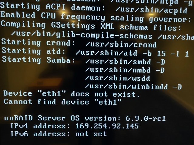

  3. Thanks Squid. I enabled IOMMU in bios, booted up to the below screen (IP should be 192.*.*.*), and logged in. Updated OP to have the new diagnostic file.
