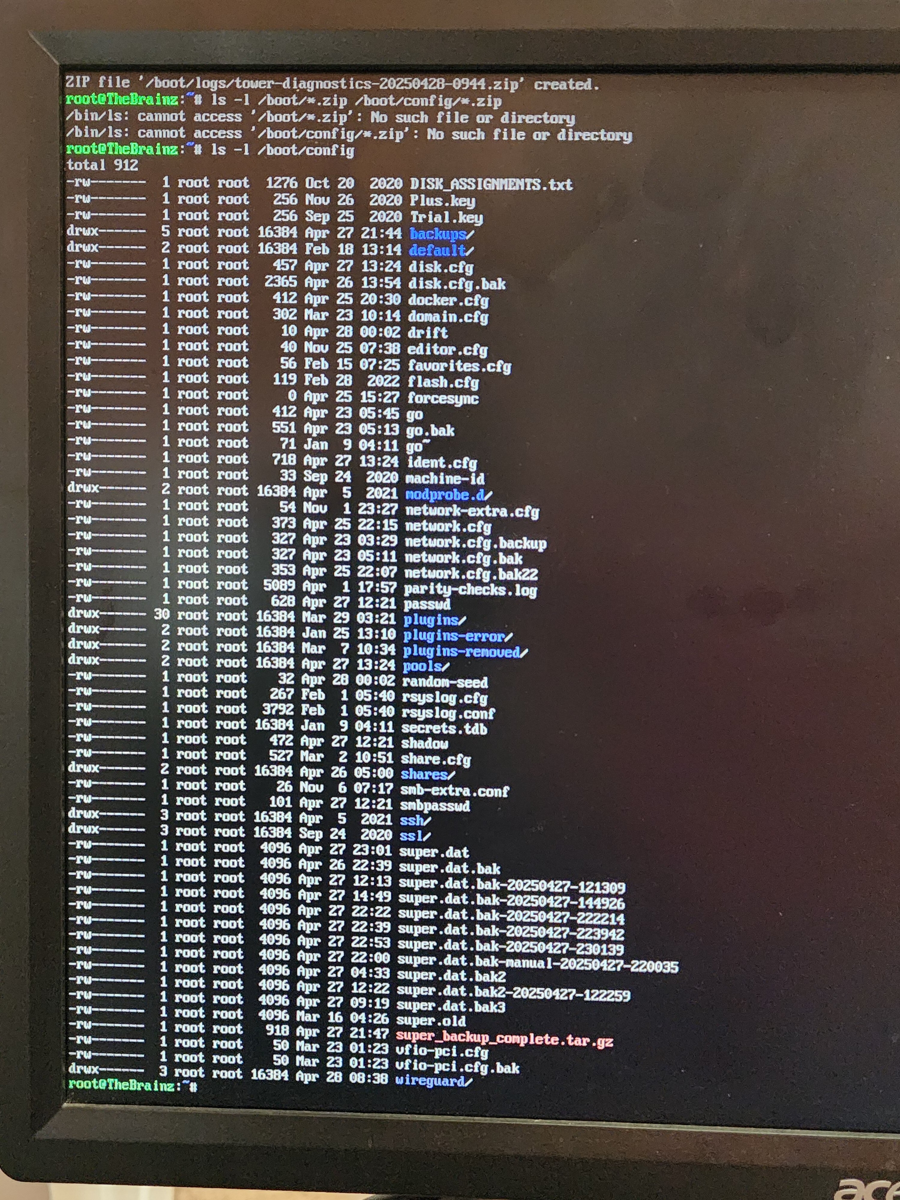

  7. @itimpi @JorgeB – I need urgent help with USB corruption and recovery. Here’s my current status: Critical Issues USB Drive Misreporting Capacity: Shows as 2TB (should be 32GB) Kernel errors: Copy Download [88788.658994] sd 8:0:0:0: [sdg] 3906963456 512-byte logical blocks: (2.00 TB/1.82 TiB) [88788.659394] Write Protect is off [88788.662298] Attached SCSI disk Diagnostics Failure: Standard diagnostics generate 108-byte invalid ZIPs Manual diagnostics attached below System State text Copy Download ===== UNRAID SYSTEM DIAGNOSTICS ===== [SYSTEM] Linux TheBrainz 5.10.28-Unraid #1 SMP Wed Apr 7 08:23:18 PDT 2021 x86_64 GNU/Linux [ARRAY STATUS] Array services not available [USB DETAILS] Bus 003 Device 002: ID 1058:2621 Western Digital Elements SE 2621 (Full diagnostics attached as file) Immediate Questions Is my USB drive hardware-failed or can it be repaired? Should I replace the USB or try deeper recovery? How can I safely backup my config given the corruption? ===== UNRAID SYSTEM DIAGNOSTICS ===== [SYSTEM] Linux TheBrainz 6.6.78-Unraid #2 SMP PREEMPT_DYNAMIC Thu Feb 20 13:33:15 PST 2025 x86_64 AMD Ryzen 9 3900X 12-Core Processor AuthenticAMD GNU/Linux [CPU] model name : AMD Ryzen 9 3900X 12-Core Processor [MEMORY] total used free shared buff/cache available Mem: 62Gi 5.6Gi 55Gi 4.3Gi 6.9Gi 57Gi Swap: 0B 0B 0B [DISKS] NAME FSTYPE FSVER LABEL UUID FSAVAIL FSUSE% MOUNTPOINTS loop0 squashfs 4.0 27.1G 14% /usr loop1 squashfs 4.0 27.1G 14% /lib sda └─sda1 vfat FAT32 UNRAID 2732-64F5 27.4G 8% /boot sdb └─sdb1 xfs 985c79ad-fe97-4fe6-9ab3-aa6114f90f99 sdc └─sdc1 xfs ec86ea42-7d70-496b-b608-efce8f6d81a3 sdd └─sdd1 xfs faf65db0-8098-4992-aeb0-3f5f79af77f0 sde └─sde1 sdf └─sdf1 xfs 228df826-0829-4090-a6ca-52a347d55db8 sdg └─sdg1 vfat FAT32 UNRAID 932C-ABEF 1.8T 0% /mnt/usb3 nvme0n1 └─nvme0n1p1 btrfs 15113cc8-fe03-4246-a065-d527f631eec8 [USB DETAILS] Bus 002 Device 002: ID 1058:0820 Western Digital Technologies, Inc. My Passport Ultra (WDBMWV, WDBZFP) [MOUNTS] /dev/sda1 on /boot type vfat (rw,noatime,nodiratime,fmask=0177,dmask=0077,codepage=437,iocharset=iso8859-1,shortname=mixed,flush,errors=remount-ro) /boot/bzfirmware on /usr type squashfs (ro,relatime,errors=continue) /boot/bzmodules on /lib type squashfs (ro,relatime,errors=continue) /dev/sdg1 on /mnt/usb3 type vfat (rw,relatime,fmask=0000,dmask=0000,allow_utime=0022,codepage=437,iocharset=iso8859-1,shortname=mixed,errors=remount-ro) [ARRAY STATUS] Array services not available [NETWORK] 1: lo: <LOOPBACK,UP,LOWER_UP> mtu 65536 qdisc noqueue state UNKNOWN group default qlen 1000 link/loopback 00:00:00:00:00:00 brd 00:00:00:00:00:00 inet 127.0.0.1/8 scope host lo valid_lft forever preferred_lft forever inet6 ::1/128 scope host valid_lft forever preferred_lft forever 2: tunl0@NONE: <NOARP> mtu 1480 qdisc noop state DOWN group default qlen 1000 link/ipip 0.0.0.0 brd 0.0.0.0 3: eth0: <BROADCAST,MULTICAST,UP,LOWER_UP> mtu 1500 qdisc fq master br0 state UP group default qlen 1000 link/ether 24:4b:fe:05:3c:40 brd ff:ff:ff:ff:ff:ff 4: br0: <BROADCAST,MULTICAST,UP,LOWER_UP> mtu 1500 qdisc noqueue state UP group default qlen 1000 link/ether 24:4b:fe:05:3c:40 brd ff:ff:ff:ff:ff:ff inet 192.168.1.41/24 metric 1 scope global br0 valid_lft forever preferred_lft forever 5: tailscale1: <POINTOPOINT,MULTICAST,NOARP,UP,LOWER_UP> mtu 1280 qdisc fq state UNKNOWN group default qlen 500 link/none inet 100.85.228.99/32 scope global tailscale1 valid_lft forever preferred_lft forever inet6 fd7a:115c:a1e0::5401:e463/128 scope global valid_lft forever preferred_lft forever inet6 fe80::1c05:33d:c111:8014/64 scope link stable-privacy proto kernel_ll valid_lft forever preferred_lft forever [RUNNING SERVICES] root 7735 0.0 0.0 103552 33392 ? SL Apr29 0:02 /usr/bin/php -q /usr/local/emhttp/plugins/tailscale/tailscale-watcher.php root 7990 0.0 0.0 11408 4660 ? Ss Apr29 0:00 sshd: /usr/sbin/sshd [listener] 0 of 10-100 startups root 10543 0.0 0.0 160924 6264 ? Ss Apr29 0:00 nginx: master process /usr/sbin/nginx -c /etc/nginx/nginx.conf root 10544 0.0 0.0 161020 8760 ? S Apr29 0:00 nginx: worker process root 19569 0.0 0.0 13988 9408 ? Ss 03:47 0:00 sshd-session: root [priv] root 19577 0.0 0.0 14332 6856 ? S 03:48 0:00 sshd-session: root@pts/0 root 31857 0.0 0.0 4188 2112 pts/0 S+ 14:51 0:00 grep -E (emhttp|nginx|ssh) [LAST SYSTEM ERRORS] Apr 30 07:55:11 TheBrainz kernel: sdg: sdg1 Apr 30 07:55:11 TheBrainz kernel: sd 8:0:0:0: [sdg] Attached SCSI disk Apr 30 08:08:41 TheBrainz kernel: /dev/sdh1: Can't lookup blockdev Apr 30 08:48:40 TheBrainz kernel: usb 6-4: USB disconnect, device number 5 Apr 30 14:14:05 TheBrainz kernel: usb 2-4: new SuperSpeed USB device number 2 using xhci_hcd Apr 30 14:14:05 TheBrainz kernel: usb-storage 2-4:1.0: USB Mass Storage device detected Apr 30 14:14:05 TheBrainz kernel: scsi host8: usb-storage 2-4:1.0 Apr 30 14:14:06 TheBrainz kernel: scsi 8:0:0:0: Direct-Access WD My Passport 0820 1007 PQ: 0 ANSI: 6 Apr 30 14:14:06 TheBrainz kernel: sd 8:0:0:0: Attached scsi generic sg6 type 0 Apr 30 14:14:06 TheBrainz kernel: sd 8:0:0:0: [sdg] Spinning up disk... Apr 30 14:14:06 TheBrainz kernel: scsi 8:0:0:1: Enclosure WD SES Device 1007 PQ: 0 ANSI: 6 Apr 30 14:14:06 TheBrainz kernel: scsi 8:0:0:1: Attached scsi generic sg7 type 13 Apr 30 14:14:13 TheBrainz kernel: .......ready Apr 30 14:14:13 TheBrainz kernel: sd 8:0:0:0: [sdg] 3906963456 512-byte logical blocks: (2.00 TB/1.82 TiB) Apr 30 14:14:13 TheBrainz kernel: sd 8:0:0:0: [sdg] Write Protect is off Apr 30 14:14:13 TheBrainz kernel: sd 8:0:0:0: [sdg] Mode Sense: 47 00 10 08 Apr 30 14:14:13 TheBrainz kernel: sd 8:0:0:0: [sdg] No Caching mode page found Apr 30 14:14:13 TheBrainz kernel: sd 8:0:0:0: [sdg] Assuming drive cache: write through Apr 30 14:14:13 TheBrainz kernel: sdg: sdg1 Apr 30 14:14:13 TheBrainz kernel: sd 8:0:0:0: [sdg] Attached SCSI disk === System Info === Linux TheBrainz 6.6.78-Unraid #2 SMP PREEMPT_DYNAMIC Thu Feb 20 13:33:15 PST 2025 x86_64 AMD Ryzen 9 3900X 12-Core Processor AuthenticAMD GNU/Linux Wed Apr 30 14:14:50 CDT 2025 === Disks === NAME FSTYPE FSVER LABEL UUID FSAVAIL FSUSE% MOUNTPOINTS loop0 squashfs 4.0 29.5G 6% /usr loop1 squashfs 4.0 29.5G 6% /lib sda └─sda1 vfat FAT32 UNRAID 2732-64F5 28G 6% /boot sdb └─sdb1 xfs 985c79ad-fe97-4fe6-9ab3-aa6114f90f99 sdc └─sdc1 xfs ec86ea42-7d70-496b-b608-efce8f6d81a3 sdd └─sdd1 xfs faf65db0-8098-4992-aeb0-3f5f79af77f0 sde └─sde1 sdf └─sdf1 xfs 228df826-0829-4090-a6ca-52a347d55db8 sdg └─sdg1 vfat FAT32 2TB 09FB-203F nvme0n1 └─nvme0n1p1 btrfs 15113cc8-fe03-4246-a065-d527f631eec8 === Memory === total used free shared buff/cache available Mem: 62Gi 3.0Gi 58Gi 1.8Gi 3.4Gi 59Gi Swap: 0B 0B 0B === Network === 1: lo: <LOOPBACK,UP,LOWER_UP> mtu 65536 qdisc noqueue state UNKNOWN group default qlen 1000 link/loopback 00:00:00:00:00:00 brd 00:00:00:00:00:00 inet 127.0.0.1/8 scope host lo valid_lft forever preferred_lft forever inet6 ::1/128 scope host valid_lft forever preferred_lft forever 2: tunl0@NONE: <NOARP> mtu 1480 qdisc noop state DOWN group default qlen 1000 link/ipip 0.0.0.0 brd 0.0.0.0 3: eth0: <BROADCAST,MULTICAST,UP,LOWER_UP> mtu 1500 qdisc fq master br0 state UP group default qlen 1000 link/ether 24:4b:fe:05:3c:40 brd ff:ff:ff:ff:ff:ff 4: br0: <BROADCAST,MULTICAST,UP,LOWER_UP> mtu 1500 qdisc noqueue state UP group default qlen 1000 link/ether 24:4b:fe:05:3c:40 brd ff:ff:ff:ff:ff:ff inet 192.168.1.41/24 metric 1 scope global br0 valid_lft forever preferred_lft forever 5: tailscale1: <POINTOPOINT,MULTICAST,NOARP,UP,LOWER_UP> mtu 1280 qdisc fq state UNKNOWN group default qlen 500 link/none inet 100.85.228.99/32 scope global tailscale1 valid_lft forever preferred_lft forever inet6 fd7a:115c:a1e0::5401:e463/128 scope global valid_lft forever preferred_lft forever inet6 fe80::1c05:33d:c111:8014/64 scope link stable-privacy proto kernel_ll valid_lft forever preferred_lft forever manual-diags-20250430-1414.txt unraid-diags.txt

  9. **Reply to itimpi and JorgeB, Apr 30, 2025** Hi itimpi and JorgeB, thank you for your guidance! I’ve streamlined this post for clarity. **Response to itimpi (bz* Files and Diagnostics)**: - **emhttpd**: `/boot/bzroot` (33MB, Feb 25 17:25) and `bzroot` from `unRAIDServer-7.0.1-x86_64.zip` are invalid (“Can’t find a SQUASHFS superblock”). Redownloading Unraid 7.0.1 .zip from https://unraid.net/download to overwrite `bz*` files (`bzimage`, `bzroot`, `bzmodules`, `bzfirmware`) on `/boot`, as suggested. If this fails, I’ll rebuild the boot USB with USB Flash Creator, preserving `/config`. - **Diagnostics**: Noted `tower-diagnostics-20250430-0449.zip` and `20250430-0806.zip` (108 bytes) were invalid. Generated new diagnostics files: ```bash diagnostics ls -l /boot/logs/tower-diagnostics-*.zip -rw------- 1 root root 148568 Apr 30 08:18 /boot/logs/tower-diagnostics-20250430-0818.zip Boot Status: Unraid partially boots (console, SSH, nginx on 80/443), but no emhttpd, so no array, WebGUI (HTTP 500), or Docker. super.dat: Restored from thebrainz-v7.0.0-flash-backup-20250314-0427.zip (Mar 6, 2025) to /boot/config (4096 bytes, Apr 29 12:42). Serials match GUI screenshot (Parity: sdf/2SGGBMKW, Disk1: sdd/VAGGS9UL, Disk2: sdb/1EHP4K4Z, Disk3: sde/VDKRMDYK, Disk4: sdc/JEKH3MZZ, sbNumDisks=5). lsblk -f NAME FSTYPE FSVER LABEL UUID FSAVAIL FSUSE% MOUNTPOINTS loop0 squashfs 4.0 29.5G 6% /usr loop1 squashfs 4.0 29.5G 6% /lib sda └─sda1 vfat FAT32 UNRAID 2732-64F5 28G 6% /boot sdb └─sdb1 xfs 985c79ad-fe97-4fe6-9ab3-aa6114f90f99 sdc └─sdc1 xfs ec86ea42-7d70-496b-b608-efce8f6d81a3 sdd └─sdd1 xfs faf65db0-8098-4992-aeb0-3f5f79af77f0 sde └─sde1 sdf └─sdf1 xfs 228df826-0829-4090-a6ca-52a347d55db8 sdg └─sdg1 vfat FAT32 2TB 09FB-203F [Mounted at /mnt/usb3] nvme0n1 └─nvme0n1p1 btrfs 15113cc8-fe03-4246-a065-d527f631eec8 All 5x 8TB WD drives and NVMe cache detected. sde1 lacks FSTYPE/UUID, but prior lsblk (Apr 28) confirmed serials. USB shifted from /dev/sdh1 to /dev/sdg1 /usr/local/sbin/mdcmd status cat: /proc/mdstat: No such file or directory Can’t verify assignments without emhttpd USB Issue: /dev/sdh1 failed (“special device does not exist”). Using /dev/sdg1 (WD My Passport, vfat, “2TB”) at /mnt/usb3. Plan: Redownload unRAIDServer-7.0.1-x86_64.zip, copy bz* files to /boot, reboot. If fails, rebuild boot USB. Attached latest diagnostics. Questions: Does lsblk -f confirm super.dat assignments? Can I verify without emhttpd? Tips for copying bz* files or USB rebuild? Risks of Haaska/Caddy on 8081? Should I reformat /dev/sdg1 (1.8TB vs. 32GB)? Any data risks? tower-diagnostics-20250430-0449.zip
  10. **Reply to JorgeB, Apr 30, 2025** Hi JorgeB, thanks for your quick response! **super.dat and Device Assignments**: - Restored `super.dat` from `thebrainz-v7.0.0-flash-backup-20250314-0427.zip` (Mar 6, 2025) to `/boot/config` (4096 bytes, Apr 29 12:42). Serials match GUI screenshot (Parity: sdf/2SGGBMKW, Disk1: sdd/VAGGS9UL, Disk2: sdb/1EHP4K4Z, Disk3: sde/VDKRMDYK, Disk4: sdc/JEKH3MZZ, sbNumDisks=5). - Checked disk presence: ```bash lsblk -f NAME FSTYPE FSVER LABEL UUID FSAVAIL FSUSE% MOUNTPOINTS loop0 squashfs 4.0 29.5G 6% /usr loop1 squashfs 4.0 29.5G 6% /lib sda └─sda1 vfat FAT32 UNRAID 2732-64F5 28G 6% /boot sdb └─sdb1 xfs 985c79ad-fe97-4fe6-9ab3-aa6114f90f99 sdc └─sdc1 xfs ec86ea42-7d70-496b-b608-efce8f6d81a3 sdd └─sdd1 xfs faf65db0-8098-4992-aeb0-3f5f79af77f0 sde └─sde1 sdf └─sdf1 xfs 228df826-0829-4090-a6ca-52a347d55db8 nvme0n1 └─nvme0n1p1 btrfs 15113cc8-fe03-4246-a065-d527f631eec8 All 5x 8TB WD drives (sdb, sdc, sdd, sde, sdf) and NVMe cache (nvme0n1) are detected. sde1 lacks FSTYPE/UUID, but prior lsblk (Apr 28) confirmed serials. I believe assignments are correct, but can’t verify fully without emhttpd. Tried mdcmd status: bash Copy /usr/local/sbin/mdcmd status cat: /proc/mdstat: No such file or directory Expected failure due to missing emhttpd. emhttpd Status: All bzroot sources invalid (33MB, “Can’t find a SQUASHFS superblock”): unRAIDServer-7.0.1-x86_64.zip (720,818,758 bytes, MD5: 81d1a615be90006422501597c7e30c19) on /mnt/usb3 (/dev/sdh1). /boot/bzroot (33MB, Feb 25 17:25). Direct download failed (403 Forbidden). Planning to redownload unRAIDServer-7.0.1-x86_64.zip from https://unraid.net/download to extract emhttpd. If fails, I’ll rebuild boot USB with USB Flash Creator, preserving /config. Questions: Does lsblk -f confirm super.dat assignments? Any way to verify without emhttpd (e.g., logs)? Specific steps for redownload or USB rebuild to avoid bzroot issues? Risks of Haaska/Caddy on 8081? Should I reformat /dev/sdh1 (1.8TB vs. 32GB)? Any data risks? Next Steps: Redownloading .zip now. Awaiting your guidance on assignments and emhttpd. Diagnostics (tower-diagnostics-20250430-0449.zip) attached previously. Thanks for your help!
  11. **Update Apr 30, 2025** JorgeB, thank you for your continued guidance! I’ve restored `super.dat`, fixed the boot USB, SSH, and nginx (80/443), but I’m stuck restoring `emhttpd` due to invalid `bzroot` files, preventing array and WebGUI startup. **Actions Taken**: 1. **Initial Issue (Apr 24, 2025)**: - Bad `dd` and service commands corrupted `/boot/config/super.dat` (sbNumDisks=2, should be 5). - Array failed (`ERROR:NO_DEVICES`, `mdcmd: write error`), WebGUI down (HTTP 500), Docker stopped. - Boot USB (`/dev/sda1`) had dirty bit, SSH initially down. 2. **Diagnostics**: - `thebrainz-diagnostics-20250427-*.zip`, `tower-diagnostics-20250428-0944.zip`, `tower-diagnostics-20250429-2158.zip`. - New: `tower-diagnostics-20250430-0449.zip` (attached). 3. **super.dat Restoration (Apr 29, 2025)**: - Restored from `thebrainz-v7.0.0-flash-backup-20250314-0427.zip` (1.15GB, super.dat: Mar 6, 2025) to `/boot/config`. - Fixed boot USB: `fsck.vfat -r /dev/sda1` (resolved boot sector, dirty bit). - Unmounted `/boot` (`umount -l /boot`, no `lsof` output), copied via secondary USB (`/dev/sdg1`), rebooted. - Post-reboot: `super.dat` present (`ls -l /boot/config/super.dat`, 4096 bytes, Apr 29 12:42), but array not started, WebGUI down. 4. **SSH/Nginx**: - Restored SSH (PuTTY). - Nginx on 80/443: 5. **emhttpd Restoration Attempts**: - **Flash Backup**: `thebrainz-v7.0.0-flash-backup-20250314-0427.zip` lacks `emhttpd`. - **unRAIDServer-7.0.1-x86_64.zip**: - Downloaded (720,818,758 bytes, MD5: 81d1a615be90006422501597c7e30c19) to `C:\Users\Makaveli\Downloads`, copied to `/mnt/usb3` (`/dev/sdh1`, WD My Passport). - Fixed `/dev/sdh1` (previously `/dev/sdg1` failed): `fsck.vfat -r`, mounted at `/mnt/usb3`. - Verified .zip (`unzip -t`). Extracted `bzroot` (`unzip`, `unzip -p`): 33,222,768 bytes (~33MB, expected ~350MB). - Mount failed: “Can’t find a SQUASHFS superblock”. Redownloaded twice, same result. - **Direct Download**: `wget https://s3.amazonaws.com/dnld.lime-technology.com/stable/unRAIDServer-7.0.1-x86_64.zip` failed (403 Forbidden, Apr 30, 2025). - **Boot USB**: `/boot/bzroot` (33MB, Feb 25 17:25), mount failed: 6. **USB Issues**: - `/dev/sdg1` failed (FAT read errors). - `/dev/sdh1` fixed, but reports 1.8TB (should be 32GB). - Old USB (14.6GB) removed. **Console Outputs**: ```bash ls -l /mnt/usb3/*.zip -rwxrwxrwx 1 root root 1153572101 Mar 13 23:29 thebrainz-v7.0.0-flash-backup-20250314-0427.zip -rwxrwxrwx 1 root root 720818758 Apr 29 22:35 unRAIDServer-7.0.1-x86_64.zip -rwxrwxrwx 1 root root 108 Apr 30 04:50 tower-diagnostics-20250430-0449.zip unzip -p /mnt/usb3/unRAIDServer-7.0.1-x86_64.zip bzroot > /tmp/unraid/bzroot ls -l /tmp/unraid/bzroot -rw-r--r-- 1 root root 33222768 Apr 30 04:27 /tmp/unraid/bzroot mount -t squashfs /tmp/unraid/bzroot /mnt/bzroot mount: wrong fs type, bad superblock ls -l /boot/bzroot -rw------- 1 root root 33222768 Feb 25 17:25 /boot/bzroot mount -t squashfs /boot/bzroot /mnt/bzroot mount: wrong fs type, bad superblock dmesg | tail -n 10 [51608.377188] Can’t find a SQUASHFS superblock on loop2 ... [54010.351286] Can’t find a SQUASHFS superblock on loop2 Current State: super.dat: Restored, likely correct (sbNumDisks=5, serials: sdf/2SGGBMKW, sdd/VAGGS9UL, sdb/1EHP4K4Z, sde/VDKRMDYK, sdc/JEKH3MZZ). emhttpd: Missing, all bzroot sources invalid (33MB). Array: Not started. WebGUI: Down (HTTP 500). Docker: Stopped. SSH: Working. Data: Safe (no writes, SMART PASSED). Issues: Persistent invalid bzroot (33MB) in .zip and boot USB. Direct download failed (403). /dev/sdh1 partition discrepancy (1.8TB vs. 32GB). Questions: Is super.dat correct? Can I verify via mdcmd status post-emhttpd restoration? Best way to restore emhttpd? Redownload .zip or rebuild boot USB with USB Flash Creator? Risks of Haaska/Caddy on 8081? Should I reformat /dev/sdh1 for 32GB? Any data risks? Next Steps: Redownloading unRAIDServer-7.0.1-x86_64.zip from https://unraid.net/download. If fails, rebuild boot USB, preserving /config. Thanks for your help! Attachments: tower-diagnostics-20250430-0449.zip tower-diagnostics-20250430-0449.zip
  12. Thank you, JorgeB, for your guidance. **Restoration Update**: Restored `super.dat` to `/boot/config` from `thebrainz-v7.0.0-flash-backup-20250314-0427.zip` (1.15 GB, `super.dat` dated March 6, 2025). Encountered "target is busy" with `umount /boot`, `lsof /boot` showed no output, confirmed shell was in `/root` via `pwd`, used `umount -l /boot` to unmount. Fixed USB dirty bit with `fsck.vfat -r /dev/sda1` (resolved boot sector difference by copying original to backup, removed dirty bit), copied `super.dat` using a secondary USB (`/dev/sdg1`), and rebooted. Post-reboot status: webGUI down, array not started. Reverted nginx to default ports (80/443), now restoring `emhttpd` from backup. Post-recovery status: [e.g., "webGUI up, array started"]. **Current State**: - `/boot/config/super.dat` is restored (see `ls -l /boot/config` below). - SSH is working via PuTTY. - nginx is on ports 80/443 (see `netstat` below). - Diagnostics: `/boot/logs/tower-diagnostics-20250428-0944.zip` (from previous post). **Console Outputs**: `ls -l /boot/config`: total 912 -rw------- 1 root root 1276 Oct 20 2020 DISK_ASSIGNMENTS.txt -rw------- 1 root root 256 Nov 26 2020 Plus.key -rw------- 1 root root 256 Sep 25 2020 Trial.key drwx------ 5 root root 16384 Apr 27 21:44 backups/ drwx------ 2 root root 16384 Feb 18 13:14 default/ -rw------- 1 root root 457 Apr 27 13:24 disk.cfg -rw------- 1 root root 2365 Apr 26 13:54 disk.cfg.bak -rw------- 1 root root 412 Apr 25 20:30 docker.cfg -rw------- 1 root root 302 Mar 23 10:14 domain.cfg -rw------- 1 root root 10 Apr 28 00:02 drift -rw------- 1 root root 40 Nov 25 07:38 editor.cfg -rw------- 1 root root 56 Feb 15 07:25 favorites.cfg -rw------- 1 root root 119 Feb 28 2022 flash.cfg -rw------- 1 root root 0 Apr 25 15:27 forcesync -rw------- 1 root root 412 Apr 23 05:45 go -rw------- 1 root root 551 Apr 23 05:13 go.bak -rw------- 1 root root 71 Jan 9 04:11 go~ -rw------- 1 root root 718 Apr 27 13:24 ident.cfg -rw------- 1 root root 33 Sep 24 2020 machine-id drwx------ 2 root root 16384 Apr 5 2021 modprobe.d/ -rw------- 1 root root 54 Nov 1 23:27 network-extra.cfg -rw------- 1 root root 373 Apr 25 22:15 network.cfg -rw------- 1 root root 327 Apr 23 03:29 network.cfg.backup -rw------- 1 root root 327 Apr 23 05:11 network.cfg.bak -rw------- 1 root root 353 Apr 25 22:07 network.cfg.bak22 -rw------- 1 root root 5089 Apr 1 17:57 parity-checks.log -rw------- 1 root root 628 Apr 27 12:21 passwd drwx------ 2 root root 16384 Mar 29 03:21 plugins/ drwx------ 2 root root 16384 Jan 25 13:10 plugins-error/ drwx------ 2 root root 16384 Mar 7 10:34 plugins-removed/ drwx------ 2 root root 16384 Apr 27 13:24 pools/ -rw------- 1 root root 32 Apr 28 00:02 random-seed -rw------- 1 root root 267 Feb 1 05:40 rsyslog.cfg -rw------- 1 root root 3792 Feb 1 05:40 rsyslog.conf -rw------- 1 root root 16384 Jan 9 04:11 secrets.tdb -rw------- 1 root root 472 Apr 27 12:21 shadow -rw------- 1 root root 527 Mar 2 10:51 share.cfg drwx------ 2 root root 16384 Apr 26 05:00 shares/ -rw------- 1 root root 26 Nov 6 07:17 smb-extra.conf -rw------- 1 root root 101 Apr 27 12:21 smbpasswd drwx------ 3 root root 16384 Apr 5 2021 ssh/ drwx------ 3 root root 16384 Sep 24 2020 ssl/ -rw------- 1 root root 4096 Apr 29 12:42 super.dat -rw------- 1 root root 4096 Apr 26 22:39 super.dat.bak -rw------- 1 root root 4096 Apr 27 12:13 super.dat.bak-20250427-121309 -rw------- 1 root root 4096 Apr 27 14:49 super.dat.bak-20250427-144926 -rw------- 1 root root 4096 Apr 27 22:22 super.dat.bak-20250427-222214 -rw------- 1 root root 4096 Apr 27 22:39 super.dat.bak-20250427-223942 -rw------- 1 root root 4096 Apr 27 22:53 super.dat.bak-20250427-230139 -rw------- 1 root root 4096 Apr 27 04:33 super.dat.bak2 -rw------- 1 root root 4096 Apr 27 22:00 super.dat.bak-manual-20250427-220035 -rw------- 1 root root 4096 Apr 27 12:22 super.dat.bak2-20250427-122259 -rw------- 1 root root 4096 Apr 27 09:19 super.dat.bak3 -rw------- 1 root root 4096 Mar 16 04:26 super.old -rw------- 1 root root 50 Mar 23 01:23 vfio-pci.cfg -rw------- 1 root root 918 Apr 27 21:47 super_backup_complete.tar.gz -rw------- 1 root root 50 Mar 23 01:23 vfio-pci.cfg.bak drwx------ 2 root root 16384 Apr 28 08:38 wireguard/ `netstat -tuln | grep -E ':(80|443|8080)'`: tcp 0 0 100.85.228.99:443 0.0.0.0:* LISTEN tcp 0 0 100.85.228.99:80 0.0.0.0:* LISTEN tcp 0 0 192.168.1.41:443 0.0.0.0:* LISTEN tcp 0 0 192.168.1.41:80 0.0.0.0:* LISTEN tcp 0 0 127.0.0.1:443 0.0.0.0:* LISTEN tcp 0 0 127.0.0.1:80 0.0.0.0:* LISTEN tcp6 0 0 ::1:443 :::* LISTEN tcp6 0 0 fd7a:115c:a1e0::5401:80 :::* LISTEN tcp6 0 0 fd7a:115c:a1e0::540:443 :::* LISTEN tcp6 0 0 ::1:80 :::* LISTEN **Questions**: - Did `super.dat` restore correctly? If not, how to reassign drives manually? - Restoring `emhttpd` from backup (or fresh Unraid 7.0.1 download if needed); any additional steps to ensure stability? - Planning to set up Haaska and Caddy on port 8081 to avoid conflicts; any risks? - Any risks to data (no writes, SMART PASSED)? Thank you for your continued help!

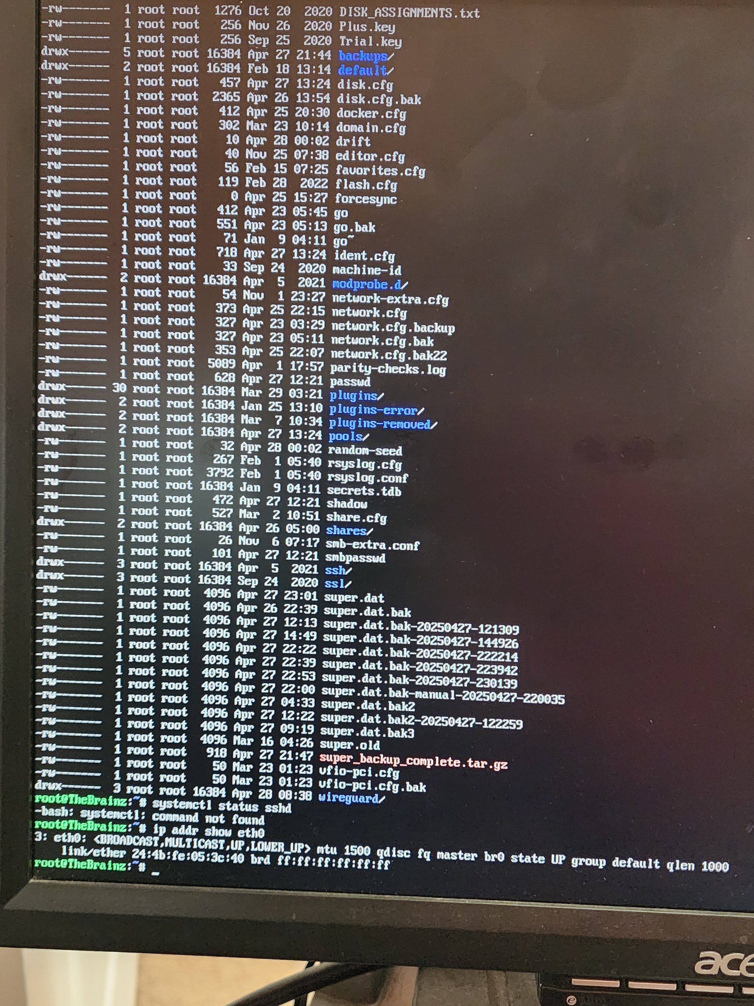

  13. Thank you, JorgeB, for your support. **Flash Backup**: Located the March 14, 2025, backup: `thebrainz-v7.0.0-flash-backup-20250314-0427.zip` (1.15 GB) at `C:\Users\Makaveli\Downloads`. Verified contents with `Expand-Archive` and `dir C:\Users\Makaveli\Downloads\temp\config` (output below). Confirmed `config/super.dat` exists (4096 bytes, dated March 6, 2025). Please provide console commands to restore `/boot/config/super.dat`, considering USB dirty bit and the `super.dat` date (March 6, 2025) vs. my server failure (April 24, 2025). **Disk Assignments**: Pre-April 24 GUI screenshot (attached previously) shows: - Parity: sdf (2SGGBMKW) - Disk1: sdd (VAGGS9UL) - Disk2: sdg (2SGGBMKW, duplicate serial, likely sdb: 1EHP4K4Z) - Disk3: sde (VDKRMDYK) - Disk4: sdc (JEKH3MZZ, synopsis lists sdc as 1EHP4K4Z, sdb as JEKH3MZZ) Current `lsblk -f` (console, Apr 28, 2025): - sdb: JEKH3MZZ (GUI Disk4) - sdc: 1EHP4K4Z (likely GUI Disk2, listed as sdb) - sdd: VAGGS9UL (Disk1) - sde: VDKRMDYK (Disk3) - sdf: 2SGGBMKW (Parity) - No sdg (GUI typo, should be sdb) Corrected assignments: - Parity: sdf (2SGGBMKW) - Disk1: sdd (VAGGS9UL) - Disk2: sdb (1EHP4K4Z) - Disk3: sde (VDKRMDYK) - Disk4: sdc (JEKH3MZZ) Can you confirm using diagnostics (`thebrainz-diagnostics-20250428-0001.zip`) or serials? If backup fails, how to reassign drives? **Current State**: - `/boot/config/super.dat` missing (`ls -l /boot`, Apr 28, 2025). - `/boot` mounted: `/dev/sda1 on /boot type vfat`. - USB: `fsck.vfat -n` shows dirty bit, boot sector differences. - SSH down; console access only. Running `systemctl status sshd`, `ip addr show eth0` (outputs pending). - New diagnostics: `/boot/logs/tower-diagnostics-20250428-0944.zip`. **Questions**: - How to restore `super.dat` from `thebrainz-v7.0.0-flash-backup-20250314-0427.zip`? - Should I fix USB dirty bit first (`fsck.vfat -r`)? - How to reassign drives if backup is invalid? - How to restore SSH? - Any risks to data (no writes, SMART PASSED)? Please provide console commands to fix `super.dat`, USB, array, Docker, webGUI, and SSH. Thank you. **Flash Backup**: `dir C:\Users\Makaveli\Downloads\temp\config`: Directory: C:\Users\Makaveli\Downloads\temp\config Mode LastWriteTime Length Name ---- ------------- ------ ---- d----- 4/28/2025 10:22 AM default d----- 4/28/2025 10:22 AM modprobe.d d----- 4/28/2025 10:22 AM plugins d----- 4/28/2025 10:22 AM plugins-error d----- 4/28/2025 10:22 AM plugins-removed d----- 4/28/2025 10:22 AM pools d----- 4/28/2025 10:22 AM shares d----- 4/28/2025 10:22 AM ssh d----- 4/28/2025 10:22 AM ssl d----- 4/28/2025 10:22 AM wireguard -a---- 3/13/2025 8:32 AM 2365 disk.cfg -a---- 3/22/2021 1:49 AM 11259 disk.cfg.bak -a---- 10/20/2020 10:20 PM 1276 DISK_ASSIGNMENTS.txt -a---- 3/13/2025 8:43 AM 412 docker.cfg -a---- 12/10/2024 12:43 AM 252 domain.cfg -a---- 3/13/2025 8:30 AM 10 drift -a---- 11/25/2024 7:38 AM 40 editor.cfg -a---- 2/15/2025 7:25 AM 56 favorites.cfg -a---- 2/28/2022 10:24 AM 119 flash.cfg -a---- 3/13/2025 8:32 AM 0 forcesync -a---- 2/22/2025 10:13 AM 108 go -a---- 1/9/2025 4:11 AM 71 go~ -a---- 3/13/2025 8:32 AM 716 ident.cfg -a---- 9/24/2020 9:28 PM 33 machine-id -a---- 11/1/2024 11:27 PM 54 network-extra.cfg -a---- 2/18/2025 1:11 PM 335 network.cfg -a---- 3/6/2025 12:04 PM 4909 parity-checks.log -a---- 10/25/2024 11:01 PM 628 passwd -a---- 11/26/2020 8:14 AM 256 Plus.key -a---- 3/13/2025 8:30 AM 32 random-seed -a---- 2/1/2025 5:40 AM 267 rsyslog.cfg -a---- 2/1/2025 5:40 AM 3792 rsyslog.conf -a---- 1/9/2025 4:11 AM 16384 secrets.tdb -a---- 10/25/2024 11:01 PM 472 shadow -a---- 3/2/2025 10:51 AM 527 share.cfg -a---- 11/6/2024 7:17 AM 26 smb-extra.conf -a---- 10/25/2024 11:01 PM 101 smbpasswd -a---- 3/6/2025 10:24 AM 4096 super.dat -a---- 9/25/2020 7:08 AM 256 Trial.key -a---- 3/5/2025 10:04 AM 50 vfio-pci.cfg **Current State** (pending console outputs): `ls -l /boot/config`: [To be provided] `systemctl status sshd`: [To be provided] `ip addr show eth0`: [To be provided]
