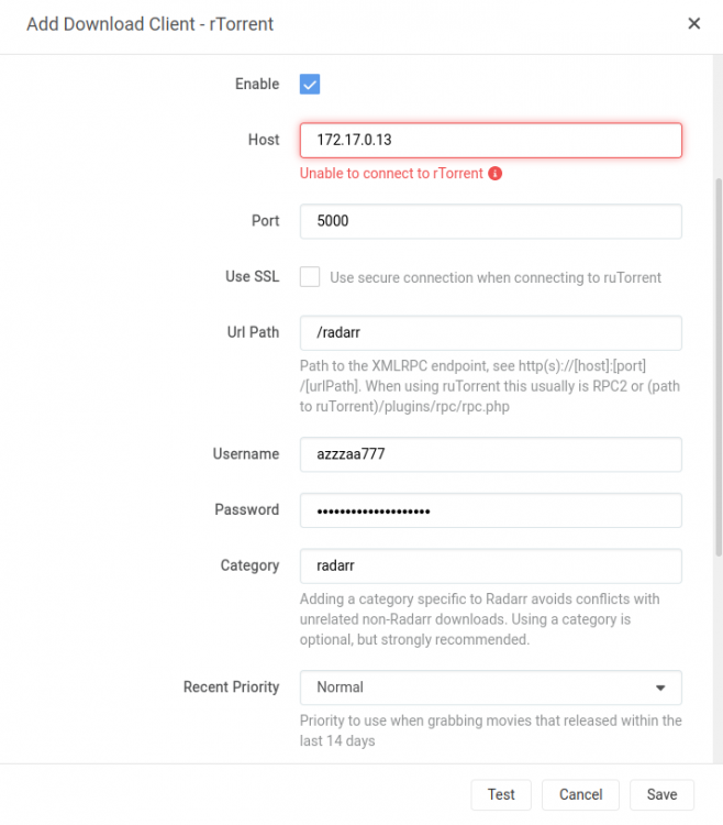

  2. Hello; I had tried this addresses : - My IP Adress in 192.168.X.X - My NAT Docker Adresse 172.17.0.13 and nothing works. Maybe my RPC Path ? how can i find it ?

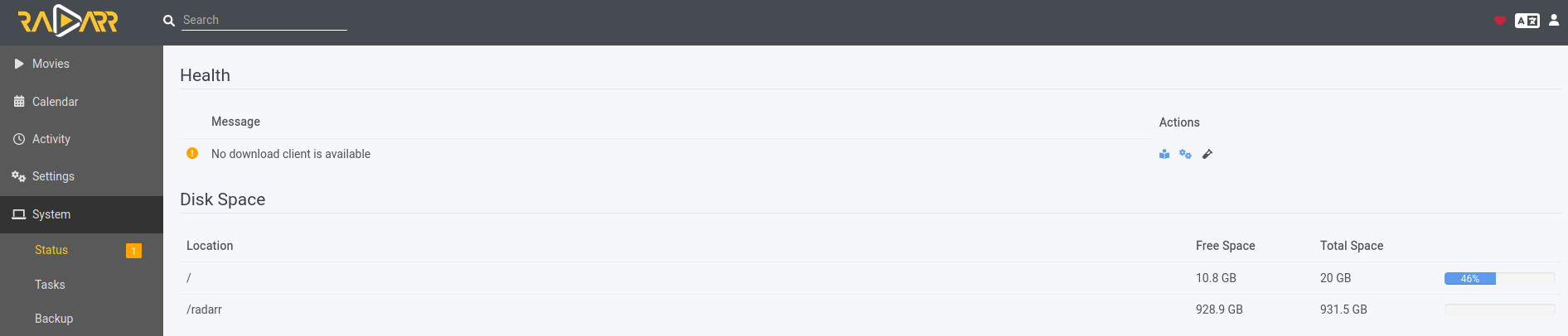

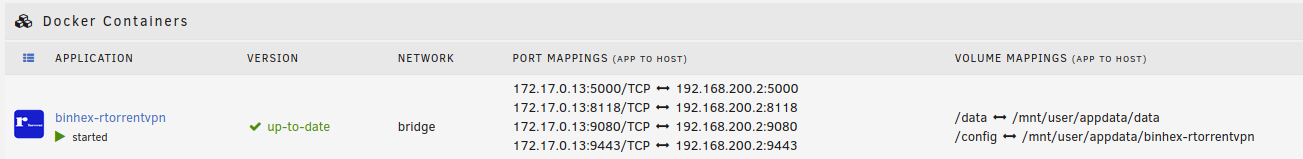

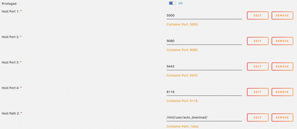

  3. Hello everyone I'm installing a new UNRAID server and i have an issue. I've already binhex-rtorrentvpn and Jackett configured and working. When i'm trying to add a Client downloader to Radarr or Sonarr, it fails ! I had tried this addresses : - My IP Adress in 192.168.X.X - My NAT Docker Adresse 172.17.0.13 What i'm doing wrong ? (All screenshots in attachements) thanks for your help
