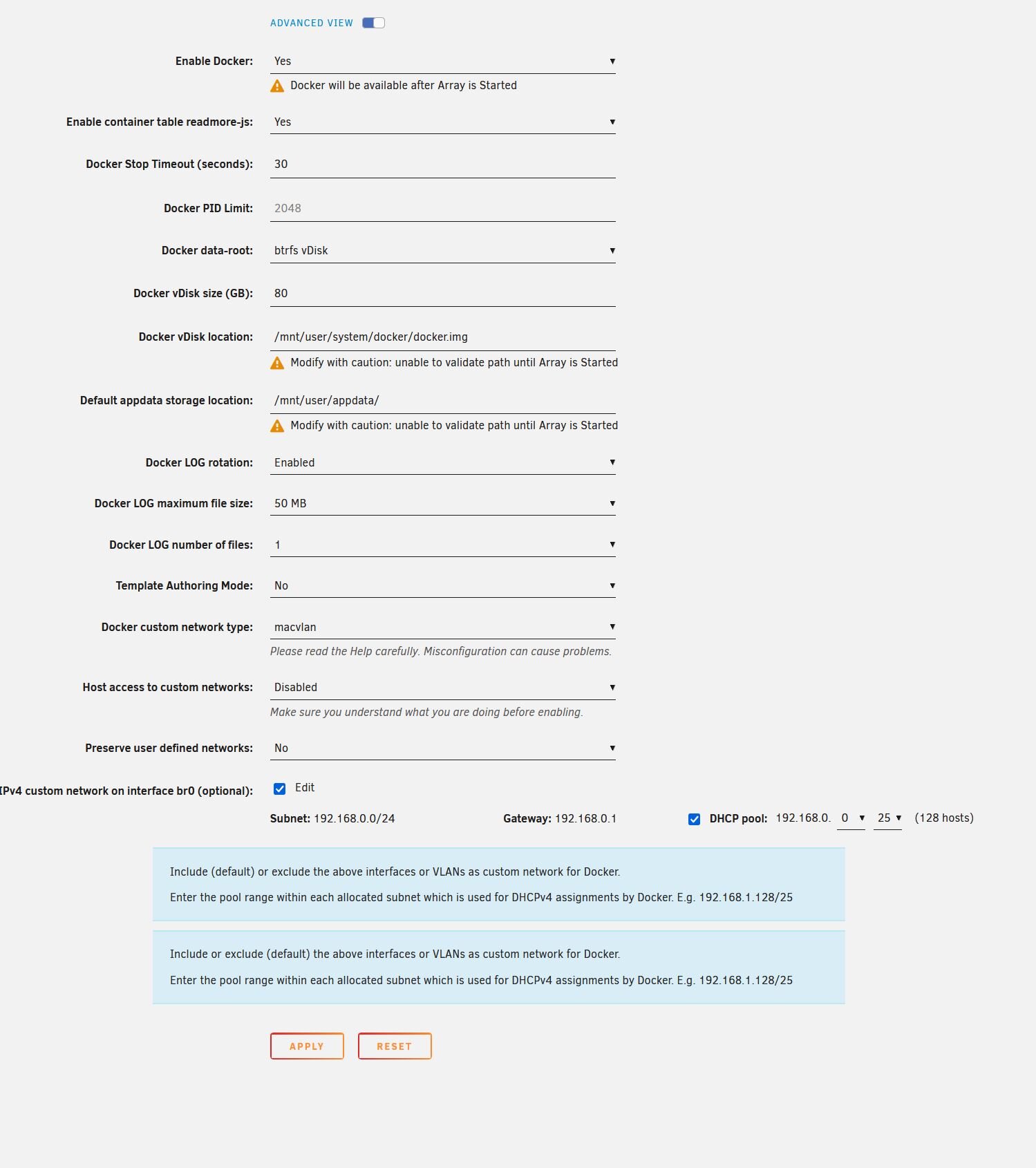

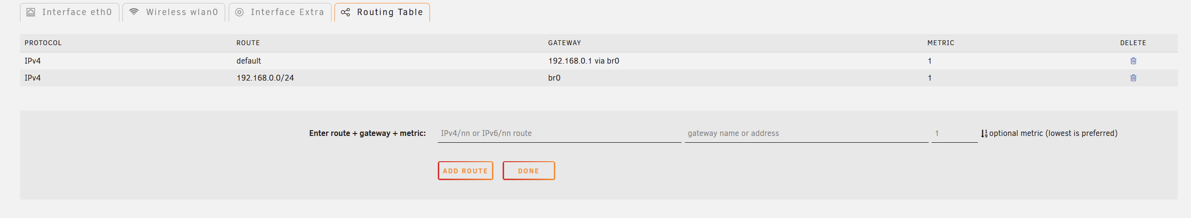

  4. This is the contents of the docker.cfg file in the flash drive:
