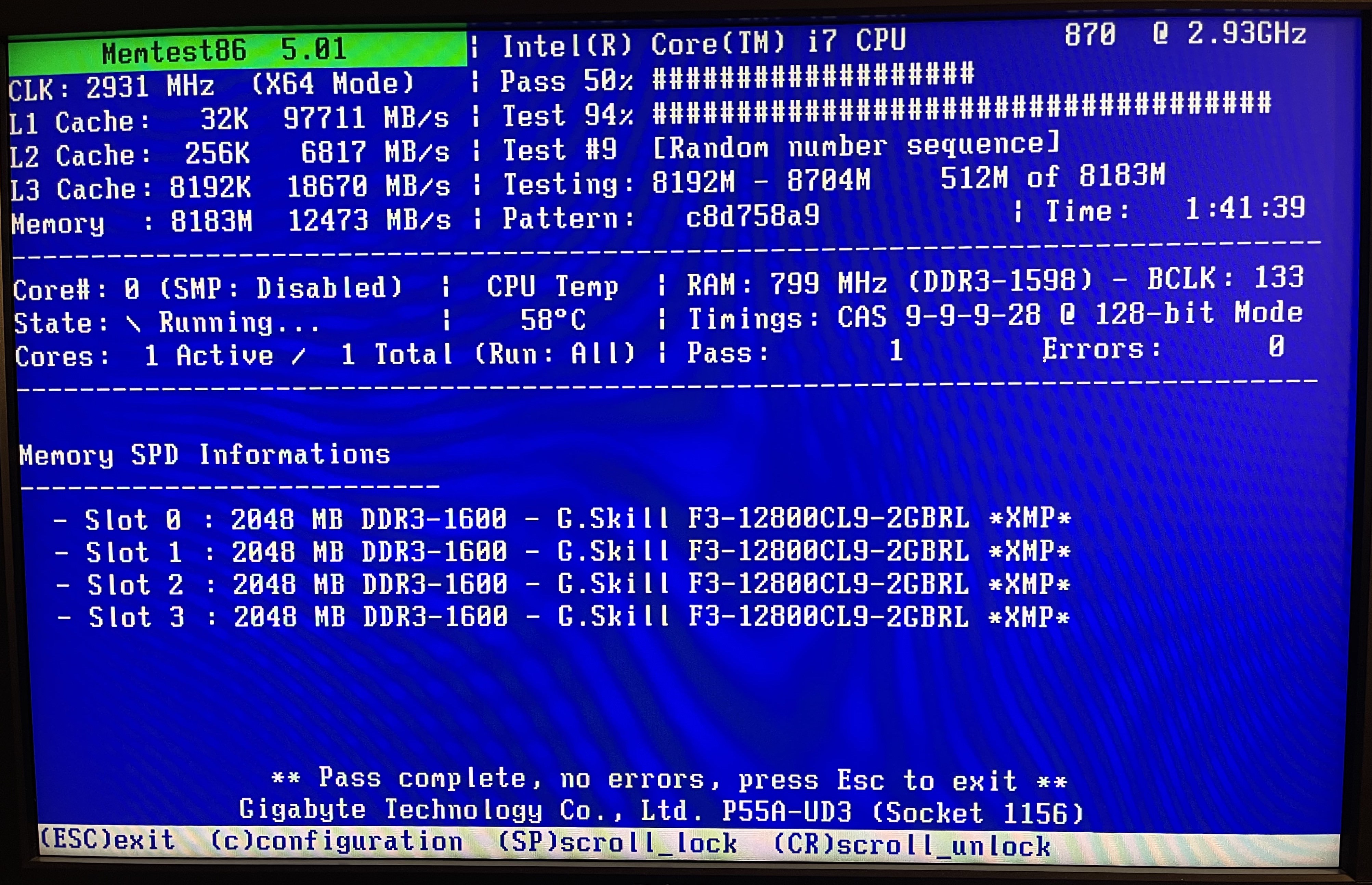

  2. I noticed some strange behaviour. My G.Skill DDR3 RAM ships with an XMP profile of 1600 MT/s CL9-9-9-24 at 1.5v. Its SPD rating is 1333 MT/s at 1.5v. Even though I ran the previous memtests with XMP disabled in the BIOS, it still detected and ran the RAM at 1600 and didn't step down to 1333, and used weird timings of 9-9-9-28, so I guess it was still technically overclocked? I removed some resistors from my Noctua fans to make them run at full speed, I swapped one stick of RAM from Channel A with one from Channel B in case my memory kits were mismatched (they came as 2x2GB and I have 8 GB total), I re-seated each stick and I manually set the memory at 1333 and latency of 9-9-9-24. I ran another memtest for 33 hours and not a single error. Does that mean that the memory is fine and it just doesn't like to run at 1600 in my system? If the memory is now fine and I continue to see issues with parity check errors, where do I look next? Also, when I manually set it at 1333 in BIOS and leave timings on auto, the BIOS actually wants to use something like 8-8-8-24. Should I let it do that or leave them at 9-9-9-24? Thanks!

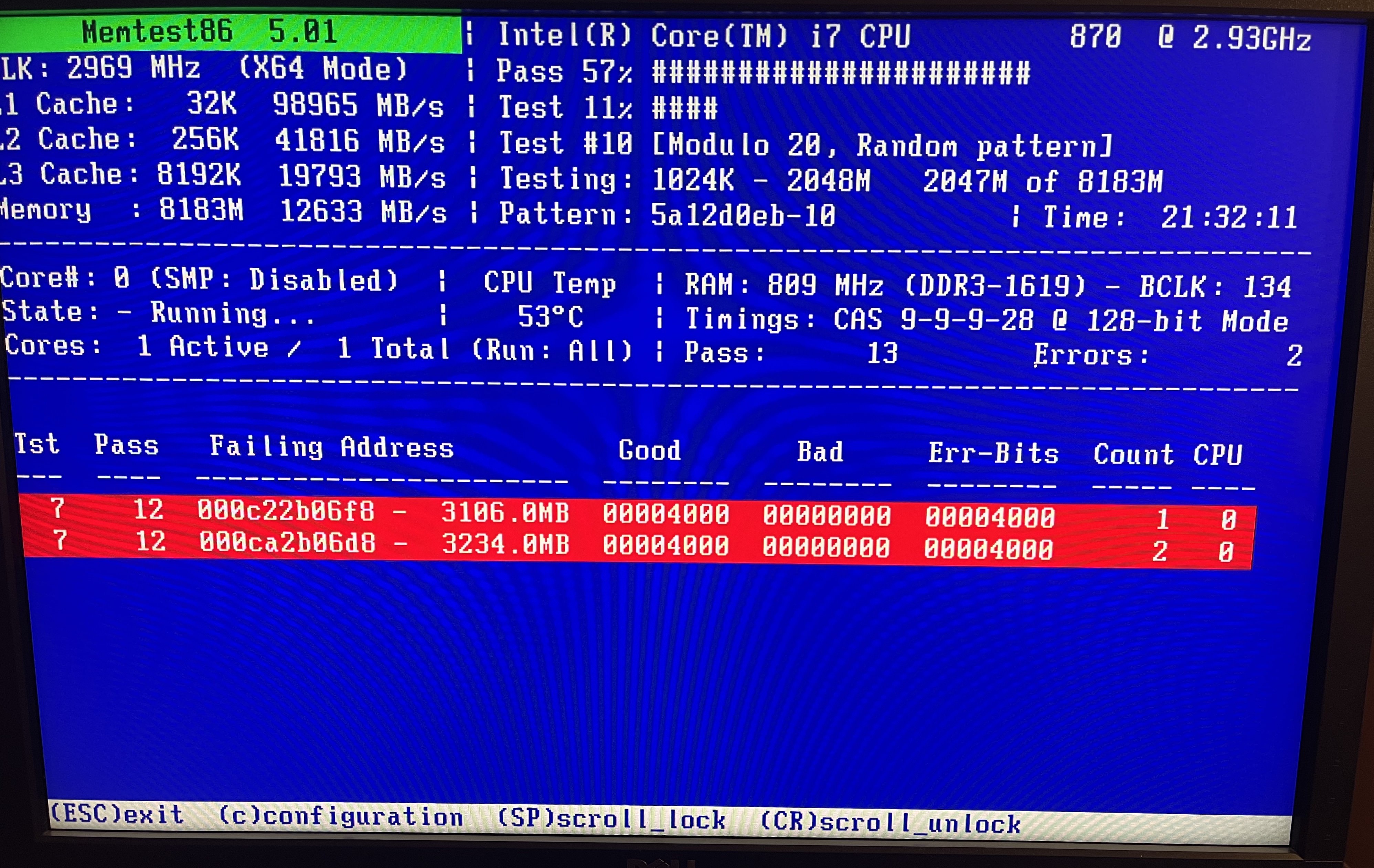

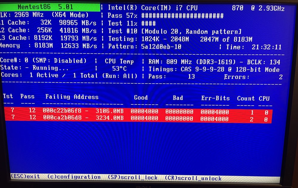

  4. Found two memory errors after running memtest for 20+ hours. Is there an easy way to figure out which of the 4 sticks is bad? Could this actually be a motherboard error or some other component? I was planning a server rebuild at some point in the near future, so not sure if it's worth replacing memory in this one or just scrap the whole thing and build new? Thanks for your tips so far!
