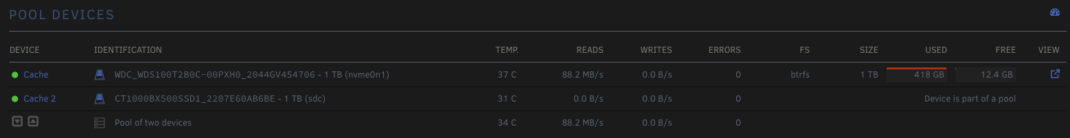

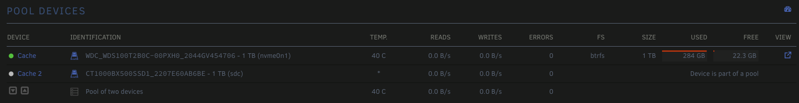

  4. Hi All, I've run into a bit of an issue that I think is stemming from some corruption errors in my cache. Initial symptom was that the cache wasn't being emptied when mover was running. I followed this guide to get everything off of the cache: Backing up the Pool to the Array During the move, I thought I noticed that the pool still wasn't emptying. In fact it was emptying, it just wasn't giving me more free space. Please see attached 2 screen shots taken over a few hours. You'll note that I have 2 x 1 TB Drives in a BTRFS Raid 1. Initially 418GB was Used. Then 284 GB was Used but the Free Space only went up by about 10 GB. Both Drives are identical in size so no funny calculations on the BTRFS side. After some sleuthing I found this thread because I also got the same error message mentioned. BTRFS Pool Too Many Profiles. I've also now run the dev stats command and got this: I had some problems a while ago with bad RAM corrupting my cache, the sdc drive was added after this corruption was solved (or so I thought). So my question is: If I was to remove the NVME drive, zero it, and then re-add it, would that solve my issue? or is there more at play here that I haven't yet found? Do I need to do anything to be able to safely remove the NVME Drive? Results of the Pool Balance are below for reference (I'm not 100% sure how to tell if it is balanced and I can remove a drive) radon-diagnostics-20230419-1456.zip
