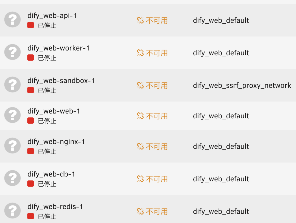

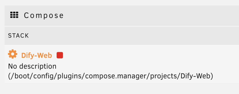

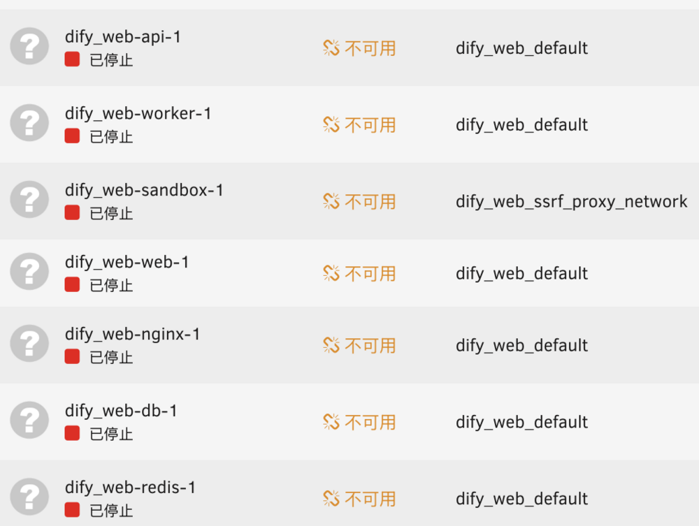

  4. 已经检查: 1. docker compose里面是空的,上次已经down掉了 2. 查看了所有在运行的docker,都是我常用的,不包含上次安装的; 3. 我的所有docker的IP都是172.17.*.*段的,路由表也是这个号段,也很奇怪为什么日志出现了172.18的IP
  5. 前两天安装了一个docker,还发帖咨询怎么删除,自从删除这个docker后,日志中每天都会出现很多如下的报错,看起来是和网络有关,但是又查询不到具体原因,请大家帮忙看看是否遇到过,如何解决,感谢感谢。 Jan 20 14:01:07 MingShun nmbd[22979]: Packet send failed to 172.18.255.255(138) ERRNO=Network is unreachable Jan 20 14:01:07 MingShun nmbd[22979]: [2025/01/20 14:01:07.808483, 0] ../../source3/libsmb/nmblib.c:923(send_udp) Jan 20 14:01:07 MingShun nmbd[22979]: Packet send failed to 172.18.255.255(138) ERRNO=Network is unreachable Jan 20 14:13:15 MingShun nmbd[22979]: [2025/01/20 14:13:15.224124, 0] ../../source3/libsmb/nmblib.c:923(send_udp) Jan 20 14:13:15 MingShun nmbd[22979]: Packet send failed to 172.18.255.255(138) ERRNO=Network is unreachable Jan 20 14:13:15 MingShun nmbd[22979]: [2025/01/20 14:13:15.224164, 0] ../../source3/libsmb/nmblib.c:923(send_udp) Jan 20 14:13:15 MingShun nmbd[22979]: Packet send failed to 172.18.255.255(138) ERRNO=Network is unreachable Jan 20 14:25:17 MingShun nmbd[22979]: [2025/01/20 14:25:17.554246, 0] ../../source3/libsmb/nmblib.c:923(send_udp) Jan 20 14:25:17 MingShun nmbd[22979]: Packet send failed to 172.18.255.255(138) ERRNO=Network is unreachable Jan 20 14:25:17 MingShun nmbd[22979]: [2025/01/20 14:25:17.554285, 0] ../../source3/libsmb/nmblib.c:923(send_udp) Jan 20 14:25:17 MingShun nmbd[22979]: Packet send failed to 172.18.255.255(138) ERRNO=Network is unreachable Jan 20 14:37:19 MingShun nmbd[22979]: [2025/01/20 14:37:19.557647, 0] ../../source3/libsmb/nmblib.c:923(send_udp) Jan 20 14:37:19 MingShun nmbd[22979]: Packet send failed to 172.18.255.255(138) ERRNO=Network is unreachable Jan 20 14:37:19 MingShun nmbd[22979]: [2025/01/20 14:37:19.557686, 0] ../../source3/libsmb/nmblib.c:923(send_udp) Jan 20 14:37:19 MingShun nmbd[22979]: Packet send failed to 172.18.255.255(138) ERRNO=Network is unreachable

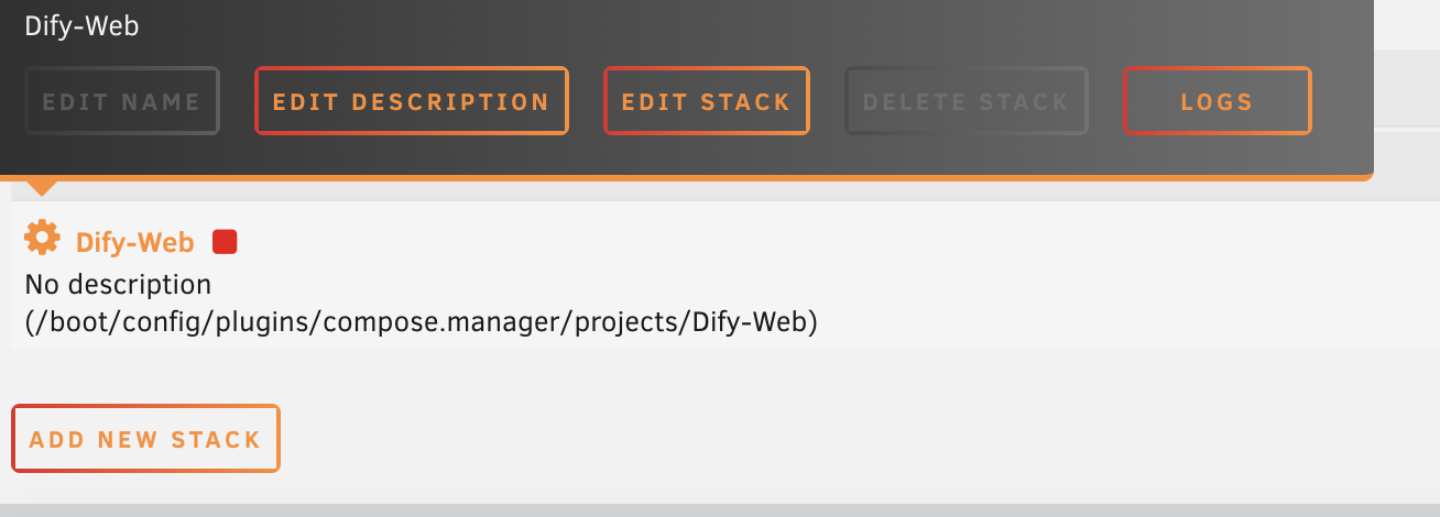

  6. 创建后发现无法使用,准备删除,但是发现删除按钮是灰色的无法点击,如下图: 目前安装的所有相关docker已经手动关闭,仍然无法删除,请问该怎么办?
  7. Thank you so much! Following the Docker start time, I was able to identify the most recent container and stopping it resolved the issue with the logs.

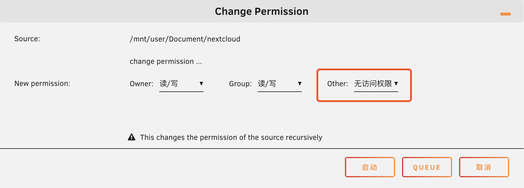

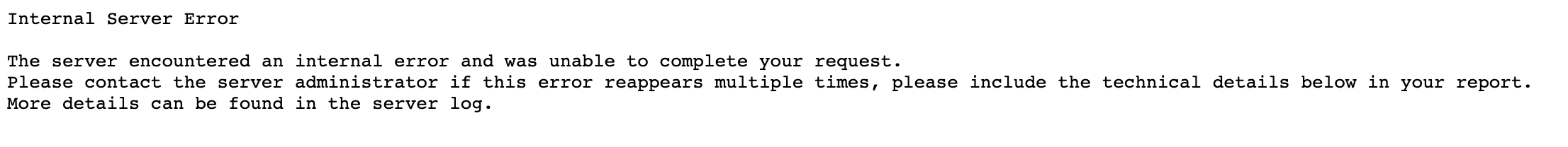

  12. 本来想通过webdav在虚拟群晖备份unraid中Nextcloud的文件,结果提示没权限,就通过Dynamix File Manager把Nextcloud存储的主文件夹设置了other权限可读写,访问Nextcloud首页提示当前权限被其他人访问需要调整回来否则无法访问,就把之前在Dynamix File Manager调整的Other可读写改成了拒绝,最后结果就是Nextcloud首页报错,看了下日志: Dynamix File Manager中只反复设置了几次other的访问权限,其他没设置过: 怀疑是不是设置整个nextcloud的权限时导致权限错乱而无法读取,所以首页就不让访问了。 首页报错如下:
