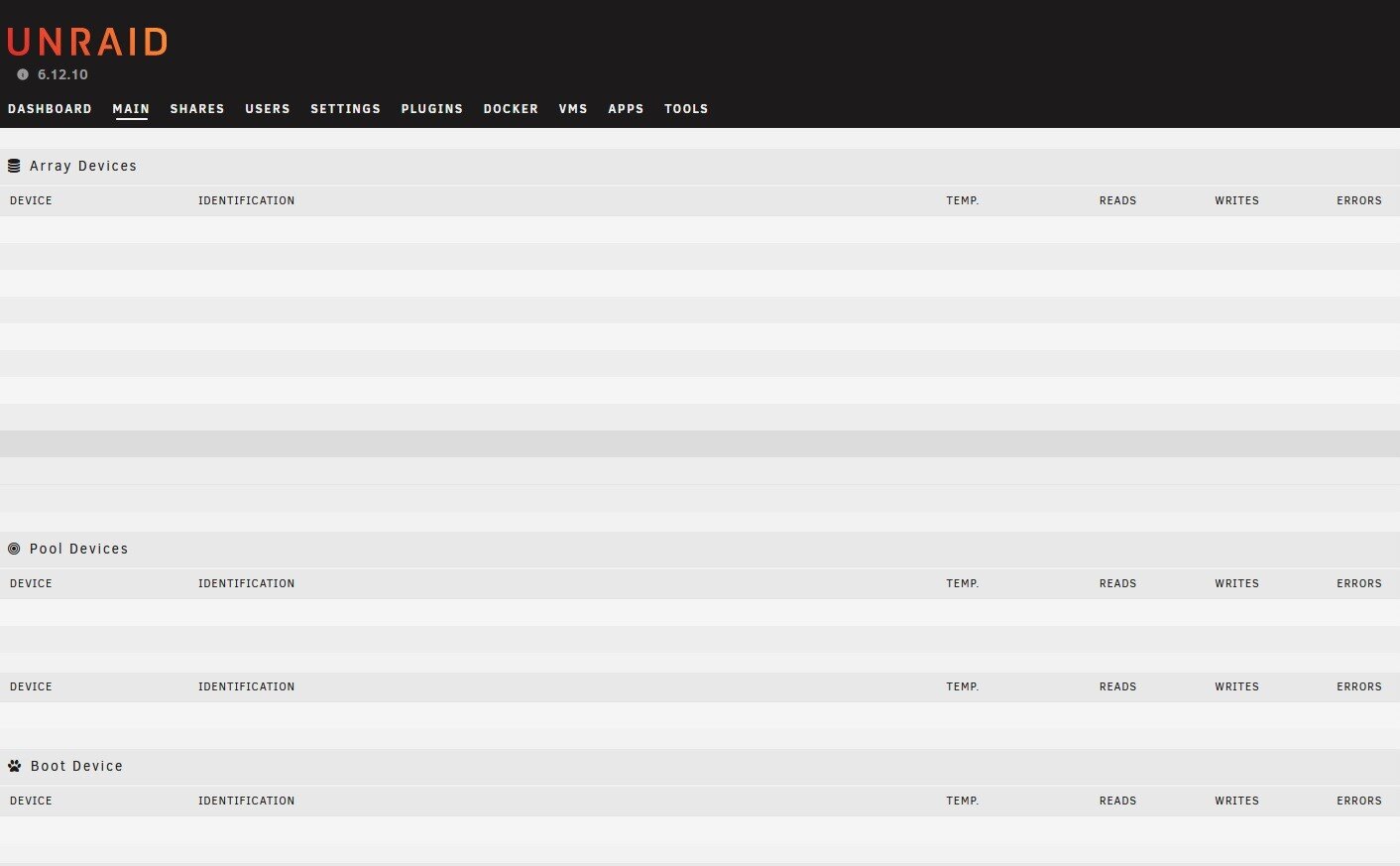

  3. Yes, the issues are still present. I have no pending app installs but I read up on this before posting and I'm not seeing any weirdness on my monitor script. I haven't changed moving the log to the ram yet but for the moment I'm not too worried about that. I've personally made no changes to any kind to any scripts in the system other than what might happen with apps that have been installed. But this only happened after the update with the same apps from before, The only thing I haven't tried is starting off completely fresh install on my system. Also I haven't messed around with coding in years so I honestly wouldn't know how to make many of these changes they are talking about with some how messing up the system more. Is there a way to get working versions of the files? I'm less worried about the log spamming as I am about the fact I cannot see any data about anything on my WebUI about my drives.

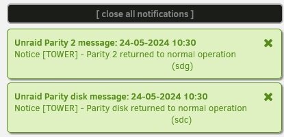

  6. Hello, I've recently recovered from a USB failure while doing an upgrade to Unraid. This was going from 6.12.6 to 6.12.10. I didn't have a copy of where the drives were located so I rebuilt parity because I also didn't have any backups of my flash that were recent. After it finished rebuilding parity, the drives no longer show up in the web UI and I keep getting a notification every minute that the two Parity disks "Have returned to normal operation". I had to move from an old USB drive to a new one was able to copy the key over sadly it seems some of the files were corrupted. After I got the online back up working I tried to restore from it and the issues still persist. I'm assuming it must have backed up the corrupted files. Below are the notifications I get. Below them what I see in the webUI. The server appears to be running normally otherwise. Lastly, I ran Common Problems and it says the flash.cfg is corrupted, I'm not sure how to go about fixing that at this moment since the forum post tells me to ask for help here. tower-diagnostics-20240524-1035.zip
