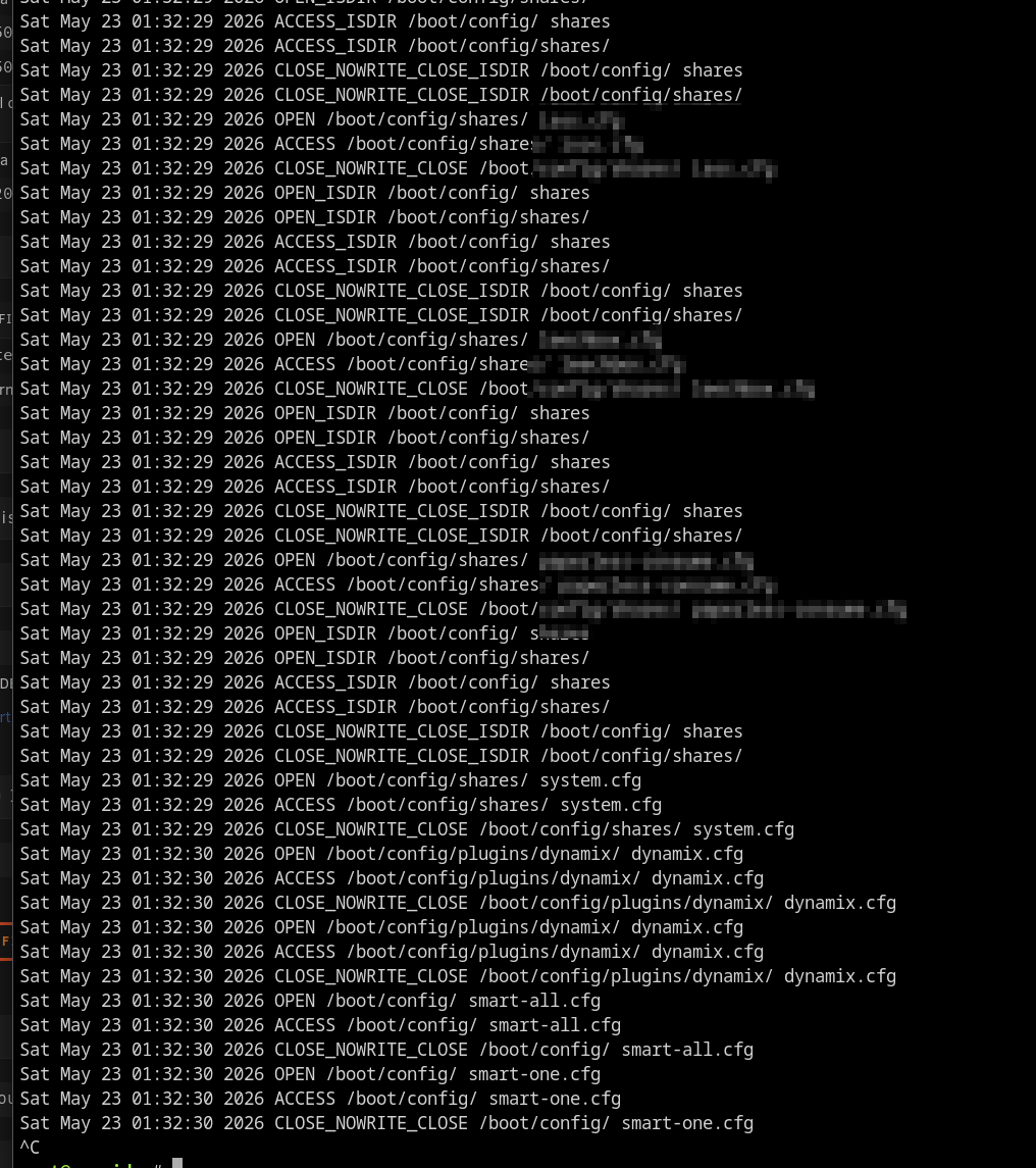

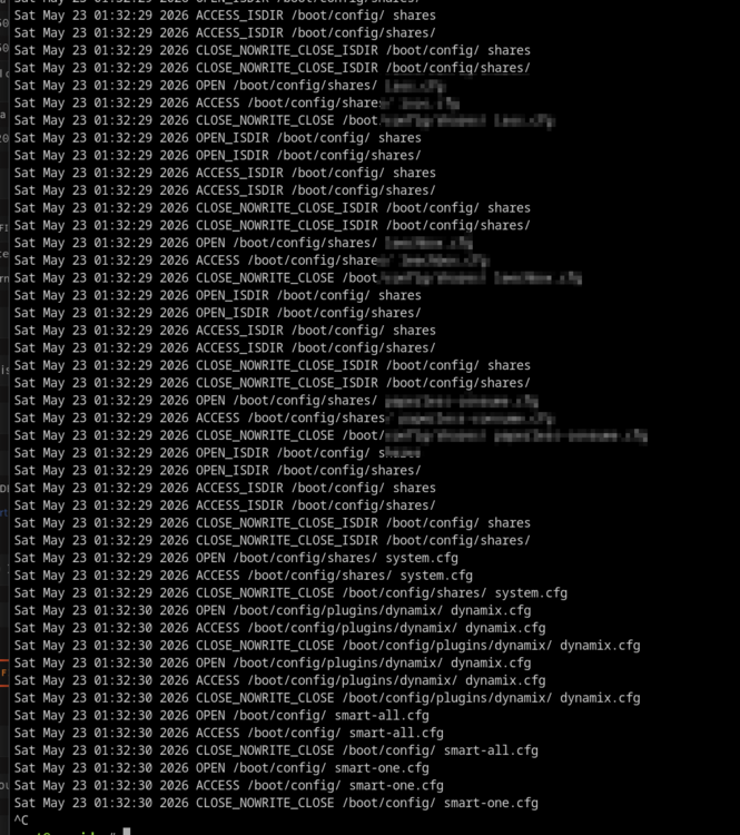

  5. Hi all, I have constant reads of the flash drive on my v7.3.0 server. This is with 10hours uptime: inotifywait --timefmt %c --format '%T %_e %w %f' -mr /boot shows constant reading of config files from shares and plugins: Does anyone have a clue what this could be? Thanks in advance!
