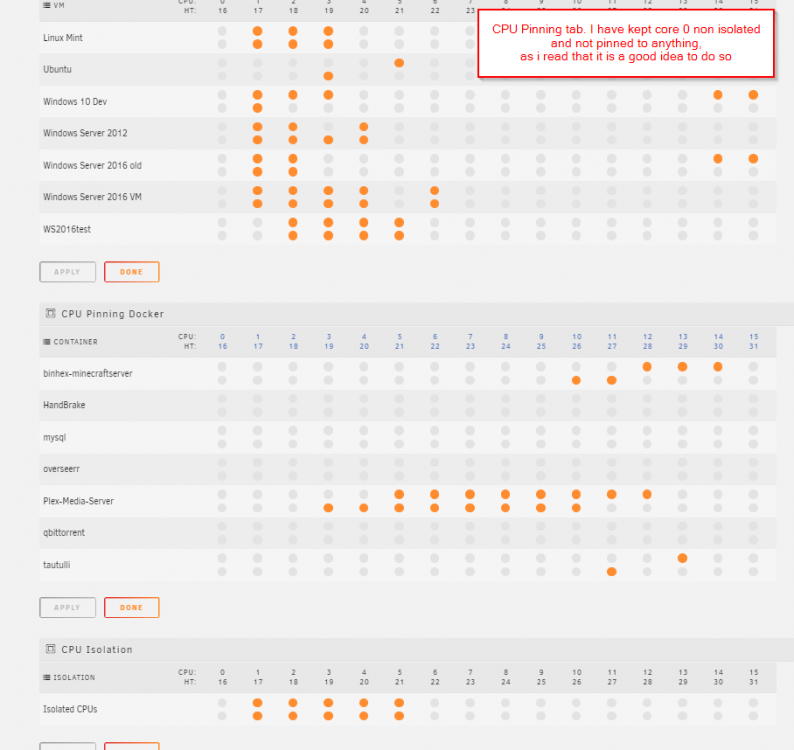

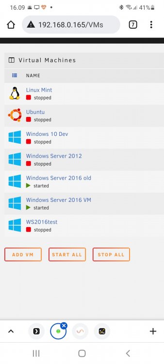

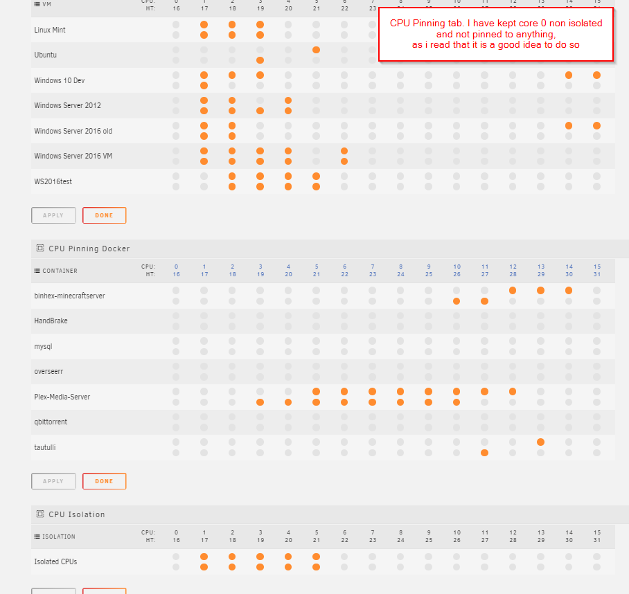

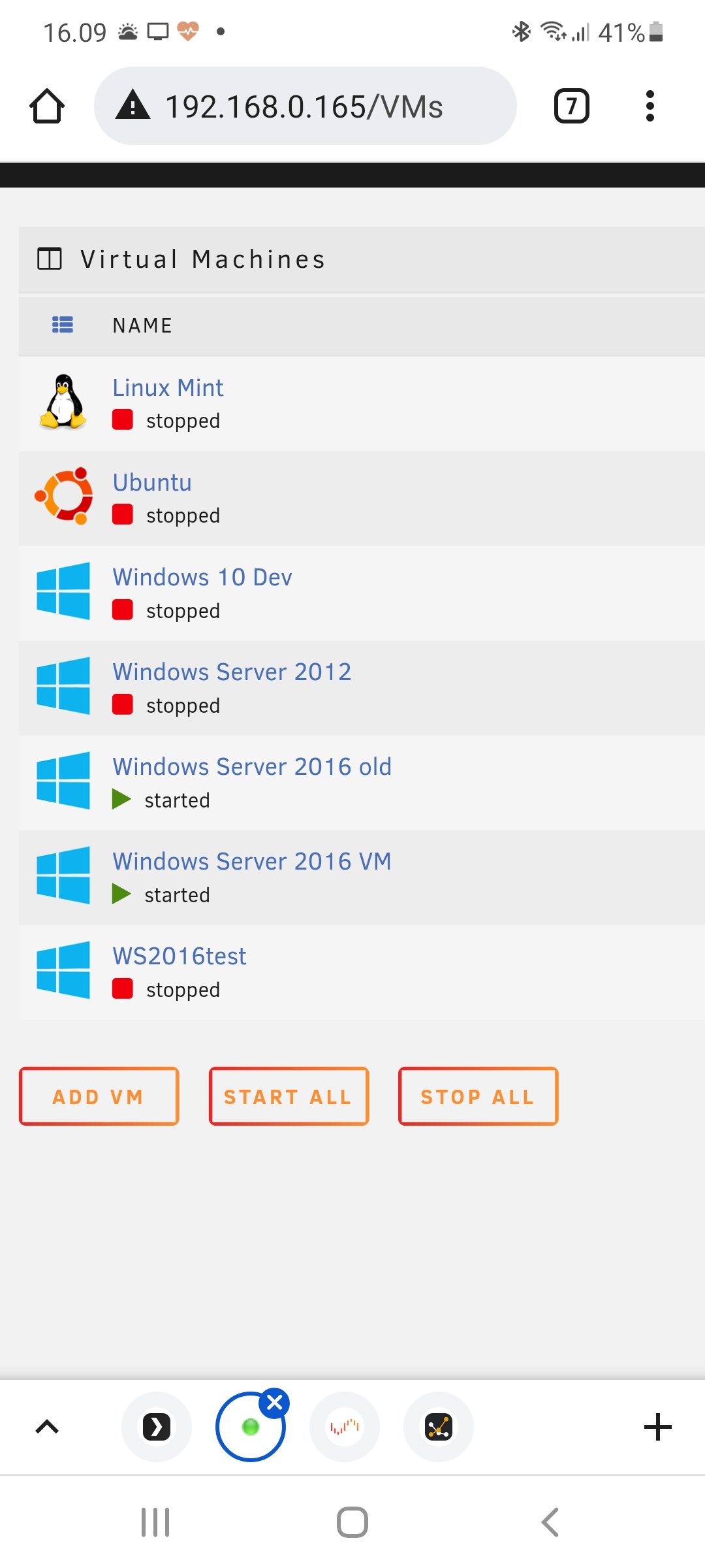

  8. Thanks for your clarification on the CPU pinning system! I was however considering some misconfig of these settings, but everywhere i found topics related to my problem, there was always 1 core that was maxing out and bottlenecking the VM, but I am not experiencing anything of the sorts. No load of any kind on any of the cores, CPU usage is only a few % with no cores showing full or even high usage. Only 2 VMs are running, the Windows Server 2016 old is running an iis/SQL Server and cannot be shut down atm. And the Windows Server 2016 SATA, is the one i am currently testing on. Linux Mint was only to test if the problem would also occur in a Linux VM, just to cross that off the list. I just tried shutting down all dockers and still only running the 2 VMS i mentioned above. Same result, download spends 95% of the time at around 0kb/sec and VM non responsive via RDP It really baffles me if it is not related to the virtualization network stuff, since downloading to the vdisk file aka c drive inside the VM, runs perfectly smooth @ full speed. It is only, and only if i download/copy to the array/cache from inside the VM, the problems occur.

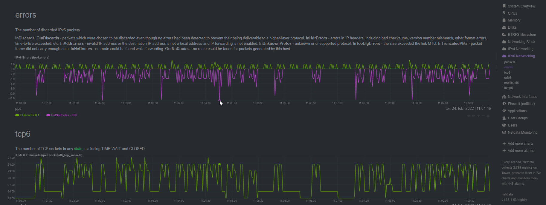

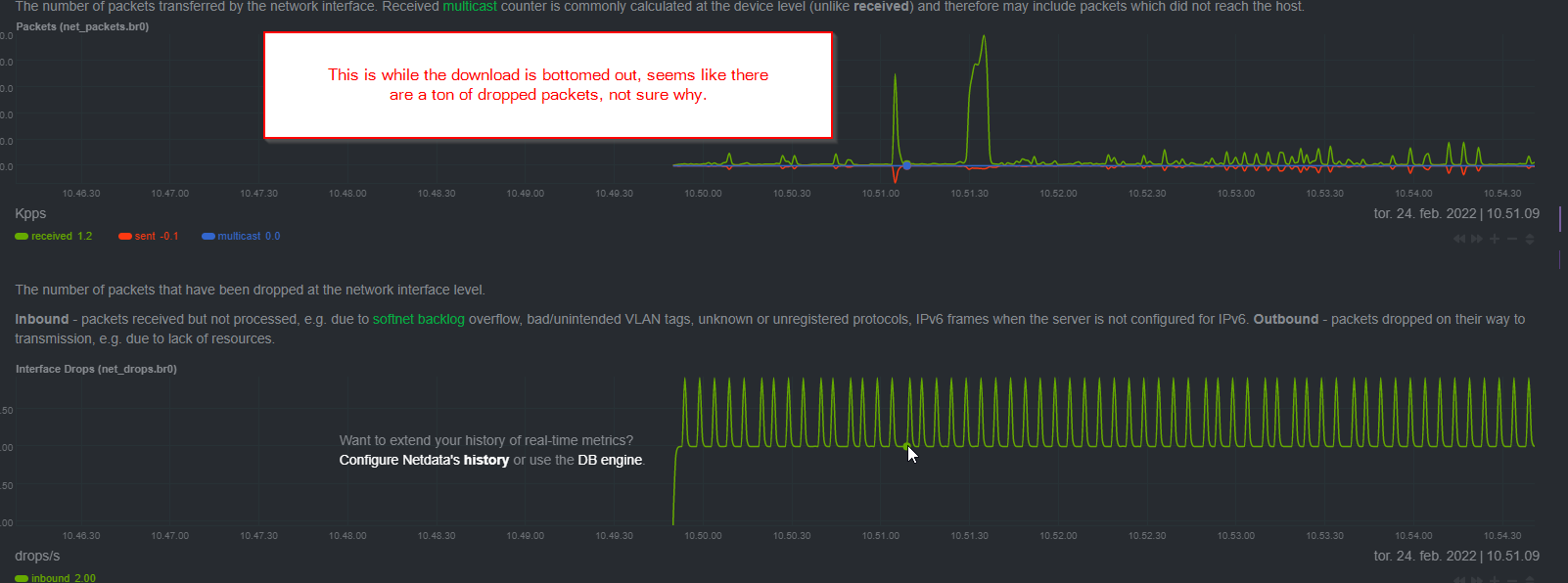

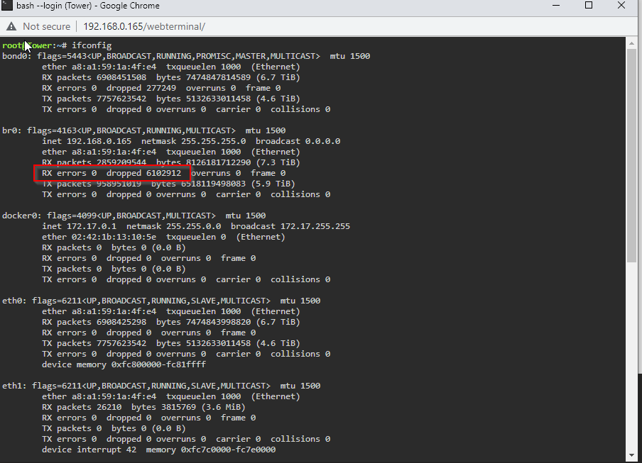

  9. I just found a tool called ifconfig, and running that shows ALOT of dropped packets

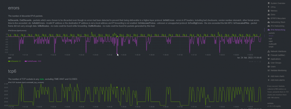

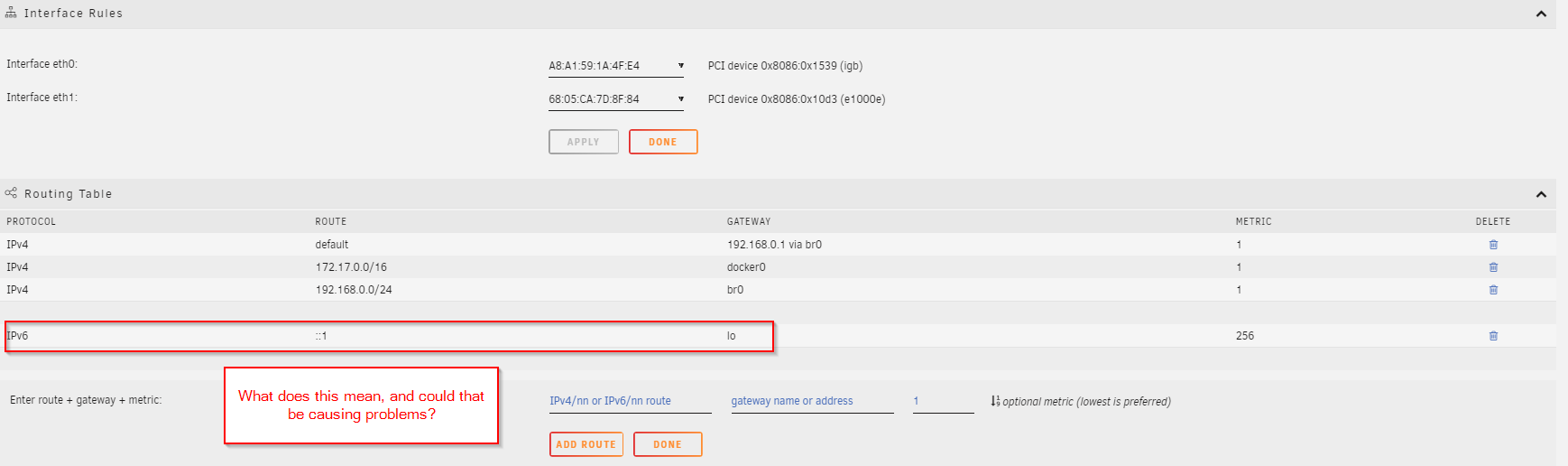

  10. I also saw this, under IPv6 there are lots of discarded packets. I also disabled IPv6 on the VM a while back, to make sure that it didnt cause problems. Also i posted a screenshot of Network Settings, showing something odd with IPv6 route, but im not a network expert so dont know if its relevant.
  11. Holy sh*t that gives a lot of information, didnt know that app, thanks! I dont know what to look for, but i found a lot of packet drops, check the screendump, no idea if its relevant. I will check if i can see anything, if the network error in qbittorrent shows up again soon.

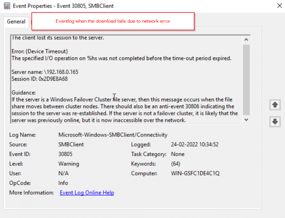

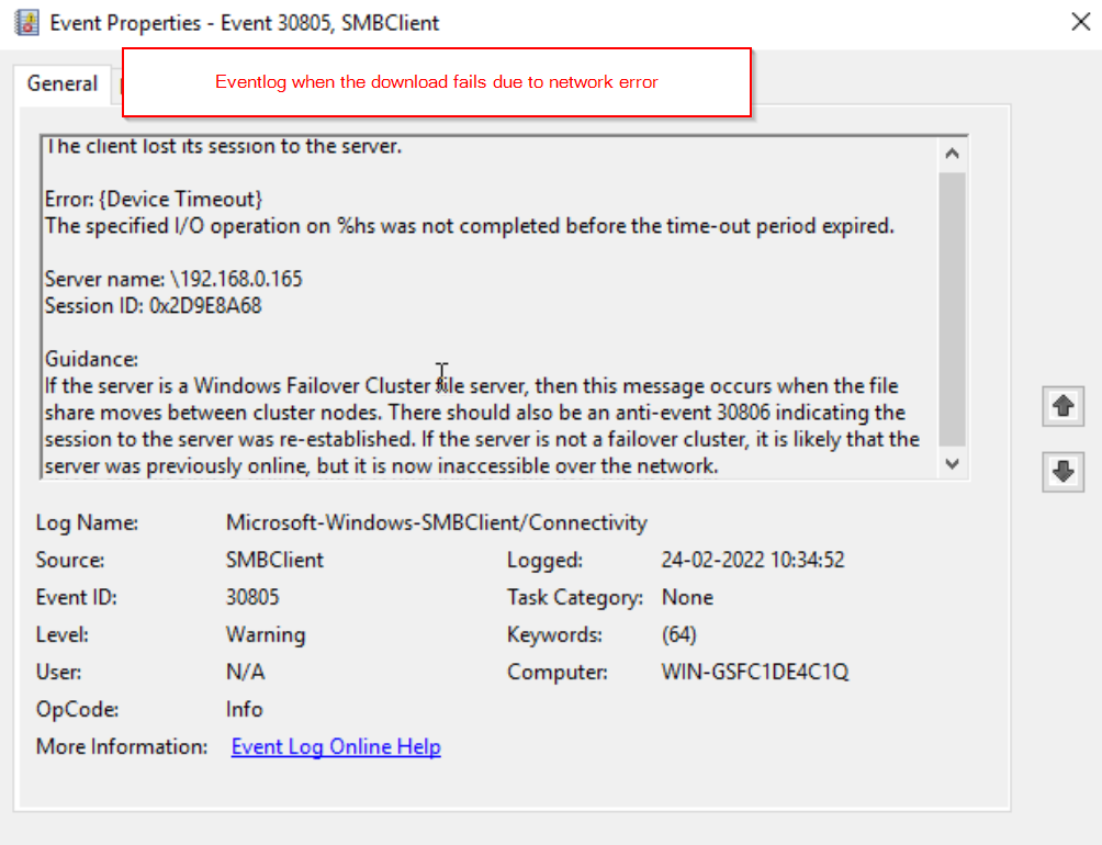

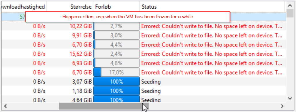

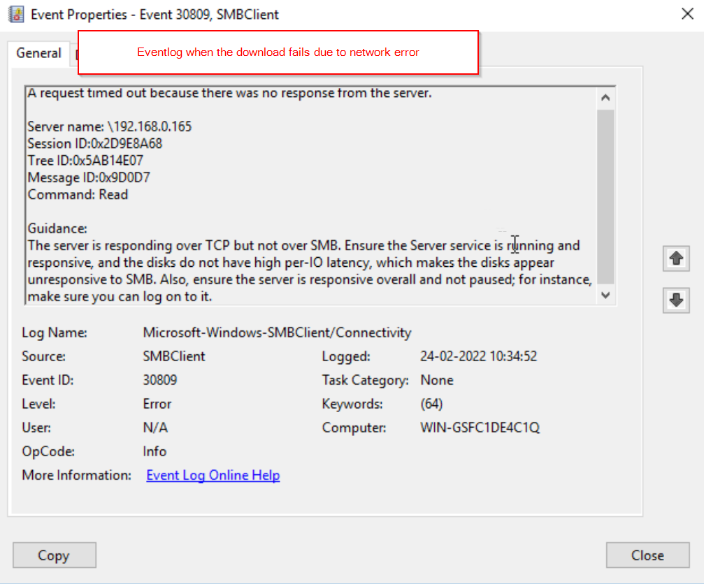

  12. Not sure if it helps, but here are a few screenshots of an error that often happens after a long time of VM being frozen. Also from the eventlog in Windows.

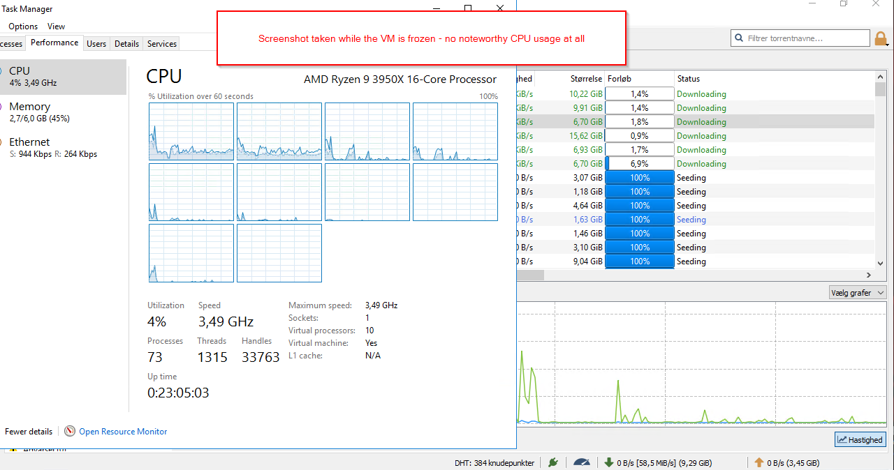

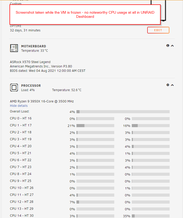

  13. Thanks a lot for the response! I posted a few more screenshots of CPU usage while the VM is frozen, connected via RDP. And as i mentioned earlier, i discovered that connection via UNRAID WEBui VNc (VNC Remote), the stuttering is non existing, but the download speeds are still displaying the same behaviour with the download speed hitting < 1Mbits 98% of the time. tower-diagnostics-20220224-0953.zip
  14. I will post another diagnostics when im at my pc again, with no cpu intensive tasks running
