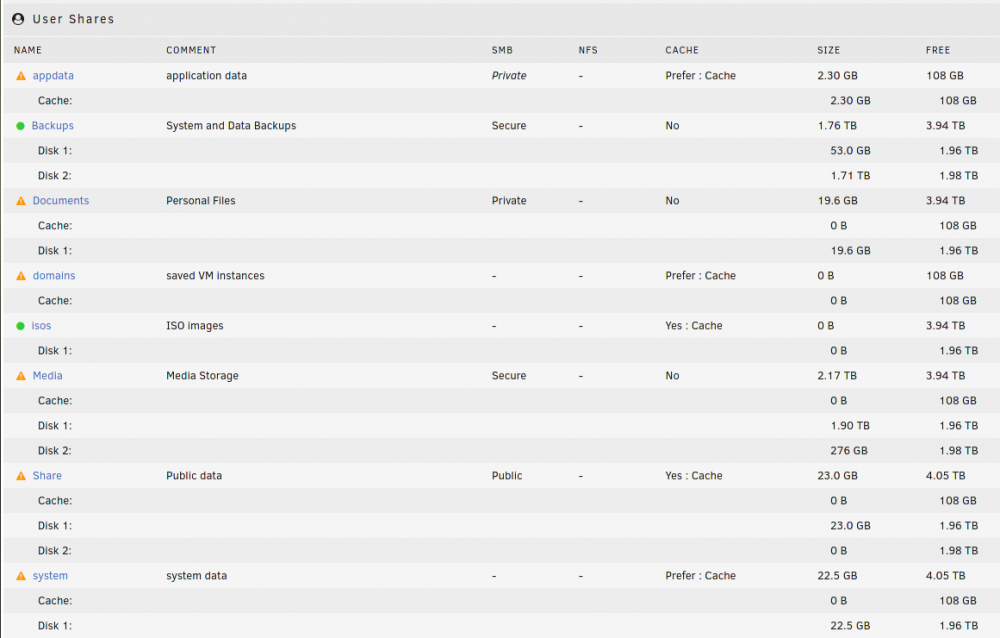

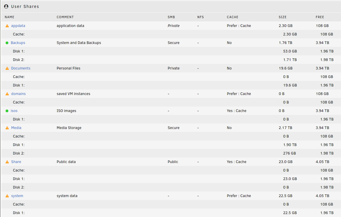

  3. I've spent some time today and managed to get it up and running 'stably' for an hour. I wiped and re-setup the cache drive after replacing the SATA cable (as recommended here). After doing that I copied the data back over to the re-formatted cache. In this case, the warning still appeared by the drives that didn't use the cache. After removing the empty folders on the cache, the warnings went away. If I don't post anything further then this was hopefully just an anomaly that I ran into during my setup and this issue is resolved.
  4. It looks like you're right. The Media and Documents folder have 0B on the cache disk. Do you have any idea what might be causing that? Seeing as the cache isn't enabled for those devices. It may or may not be related, but I just found that my cache disk has become read only. I am currently going through steps to resolve this.

  6. I have setup Unraid (currently on a trial key, v.6.9.2). I have two disks, one cache and one parity. In my 'Shares' tab, I have a few shares that do not use the Cache. Two of these (Documents and Media) show the warning that some or all files are unprotected. I can understand this warning for the shares using the cache, as there is only a single cache disk. But the other drives should only be on disks with a parity. Where can I find more information on this warning, and how can I fix it?
