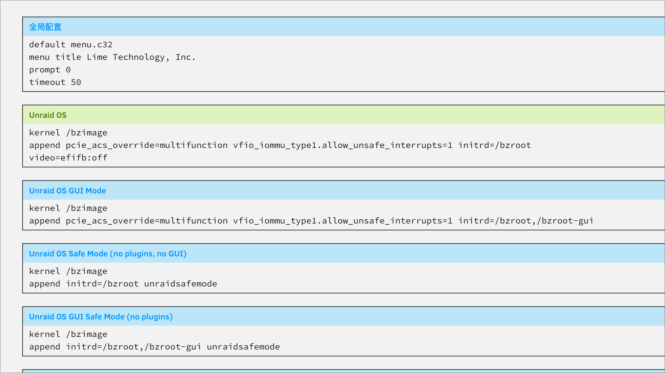

  5. 目前发现似乎通过这种方式可以解决: #fix video for VM echo 0 > /sys/class/vtconsole/vtcon0/bind echo 0 > /sys/class/vtconsole/vtcon1/bind echo efi-framebuffer.0 > /sys/bus/platform/drivers/efi-framebuffer/unbind 放到 /flash/config/go 中 源链接:

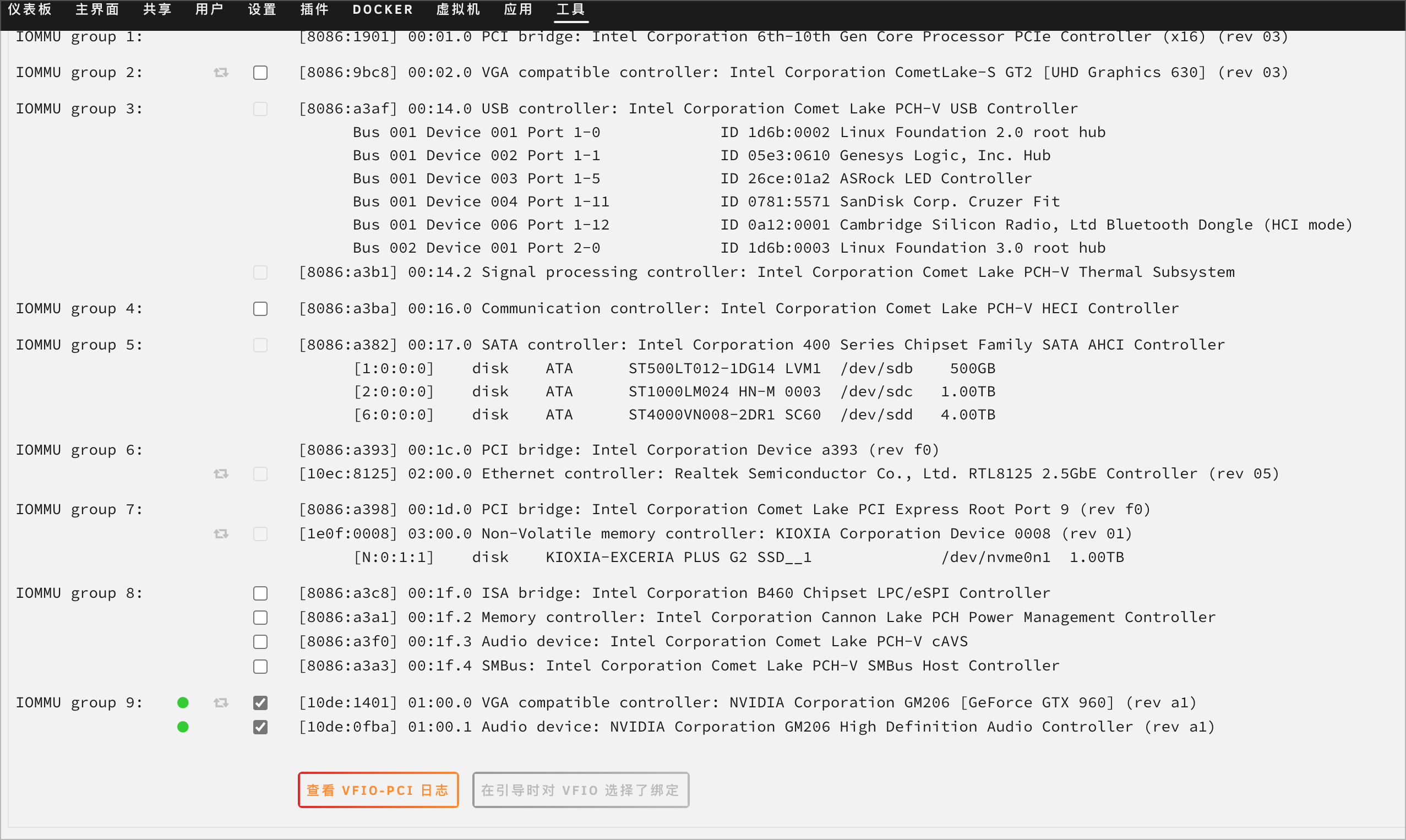

  6. 还是不行。目前是这样,也还是会出现 现在只有重启才有几率不出现这个报错

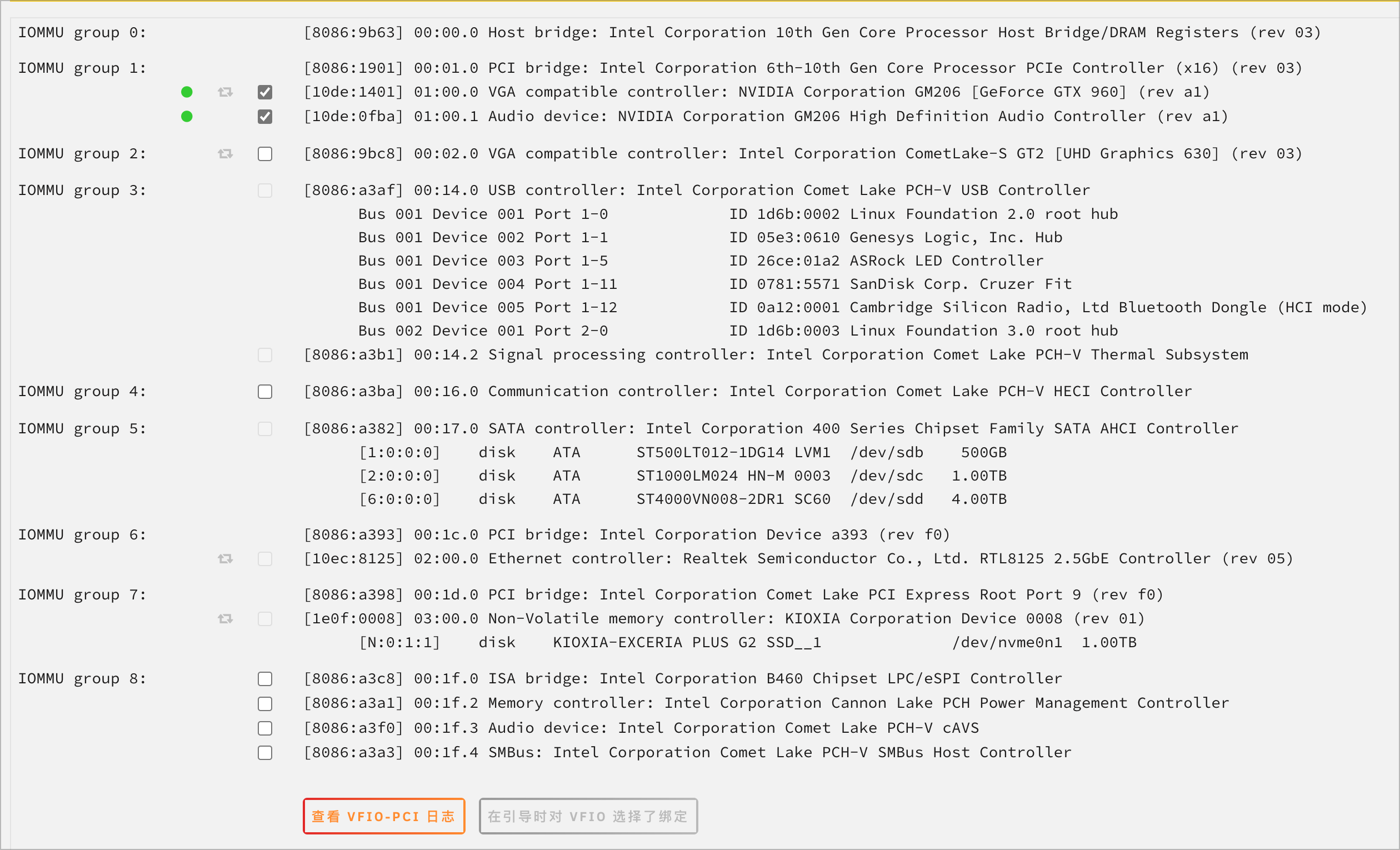

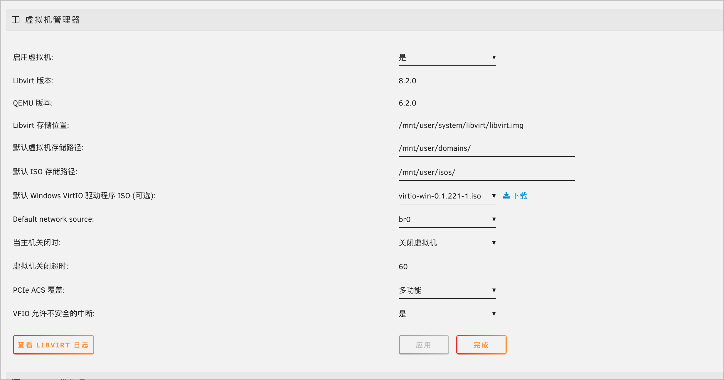

  7. What do you mean “Not in own group. Try different slot” ? Do I need to turn on the computer and replace the graphics card to another slot?
