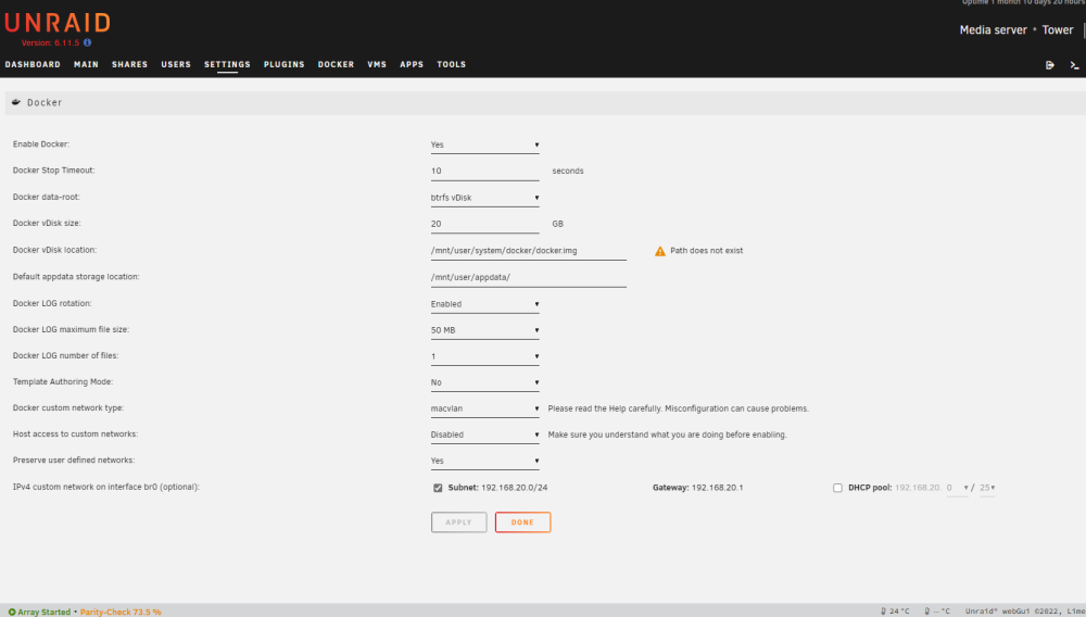

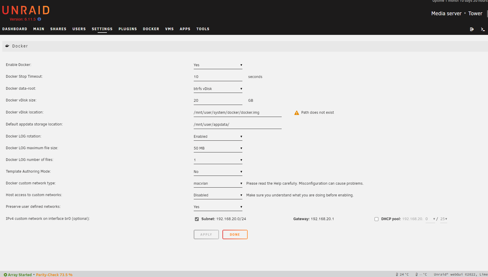

  8. Done and I have managed to mount the disk again. Now I just need to figure out how to restore my VMs and Docker. I am following the FAQ for Docker recreation posted by Squid but the delete button is missing for me. Tells me the docker path doesnt exist so I will just make a new one on cache.

  13. I am given the option to format and remount the drive but I fear that it will just cause me more headaches...

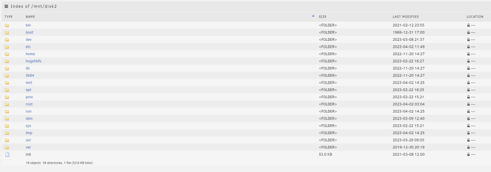

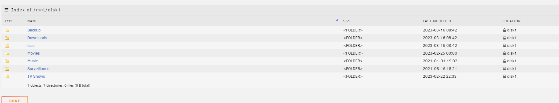

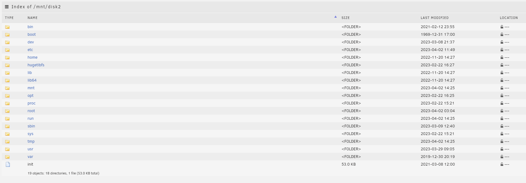

  15. Hoping someone can help me out here. I browsed the forums and the very thorough FAQ but Im a little worried that there is more going on here than I realize. There was no power outage/unclean shutdown but this morning I was unable to access my dockers and when I logged in I was greeted with "unable to write disk2" error and "unable to write to Docker Image" error. I then noticed that my appdata share is missing in the Shares tab but is present if I browse the cache disk manually. When I browse the file system of Disk2 it is present but carries a lot of files I'm not familiar with as if Disk 2 has become some kind of system drive and not a part of the data pool. A start of month scheduled parity check is currently in progress so I'm hoping that this isn't being written to parity. I can't get my docker to restart and haven't tried getting too deep as I'm afraid of data loss. I will be out of town 3 days panicking about this taking out my PFsense VM as well... the gf will kill me if the internet tanks when im gone for 3 days. Diagnostics zip attached as well. tower-diagnostics-20230402-1353.zip
