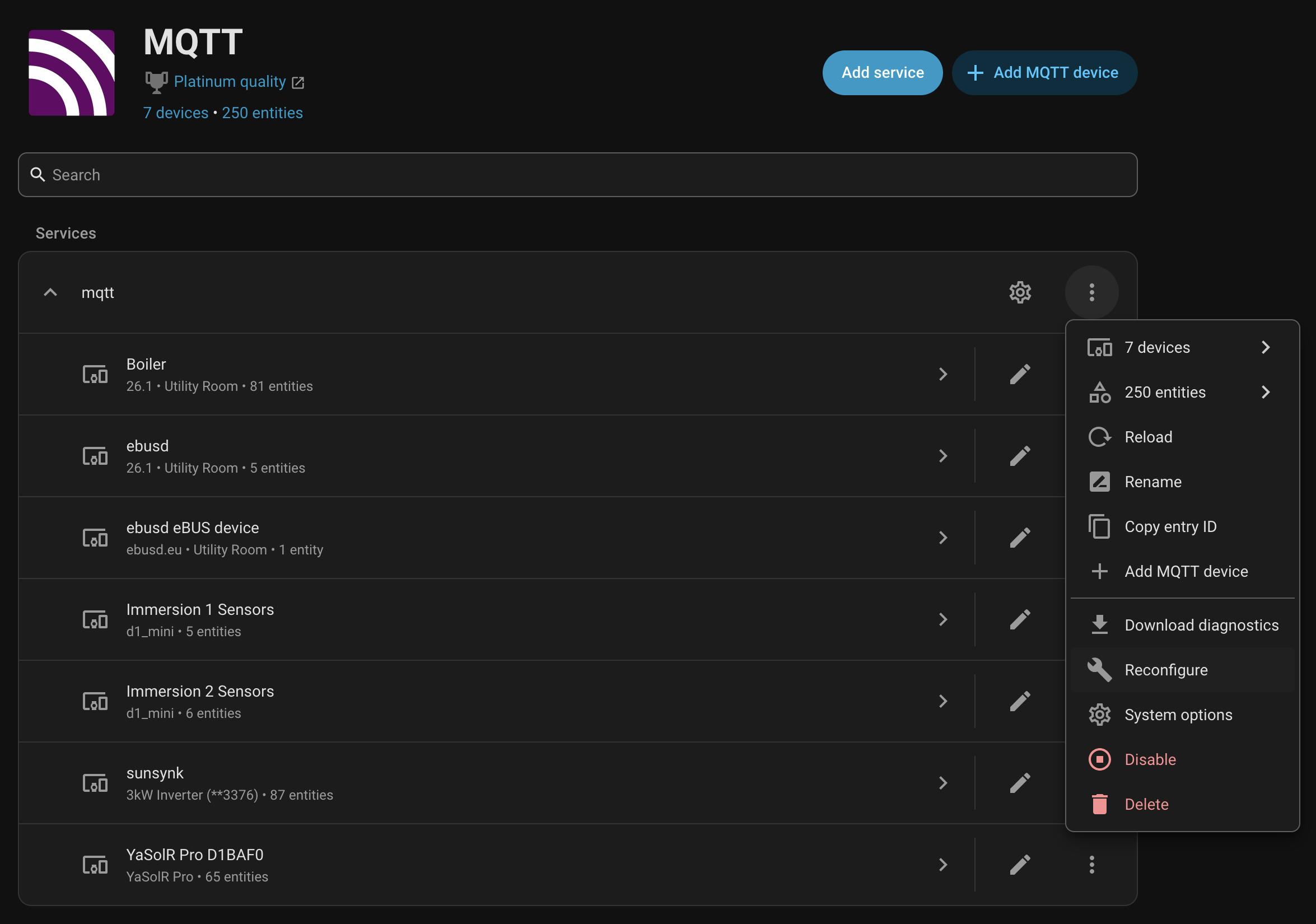

  1. I switched over to the official Mosquitto container, but that didn't resolve the issue. I realised that I had to go and reconfigure the HA MQTT integration and update the protocol version there. That resolved the issue, and I would bet I could have stayed with the spants container.
