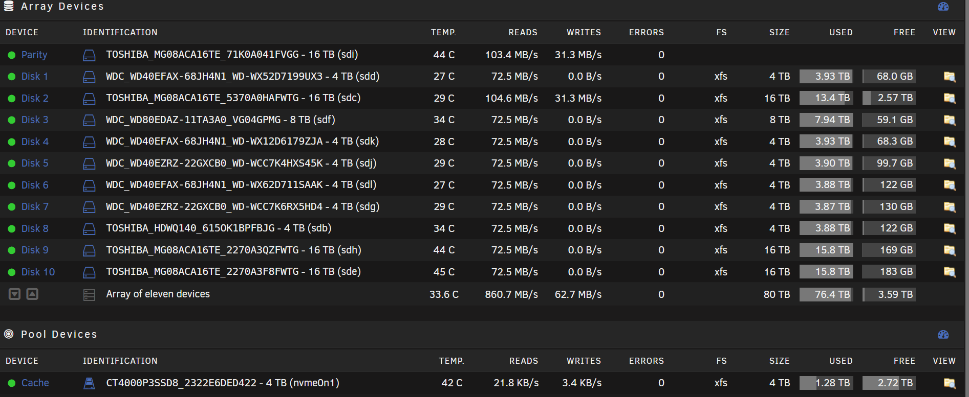

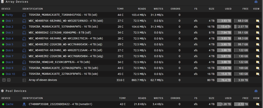

  1. For anyone that stumbles across this in the future: - I ran a non-correcting parity check and found 28,000+ errors. - I then ended up checking the file system for each drive, all of them passed - I ran a correcting parity check and it corrected all of the errors. All data appears to be intact and everything seems to be running fine.
  2. As the title says, it appears that my System share is landing on both the cache pool and the array: Disk 1: Cache: Yes, System is set to prefer cache: There is plenty of free space on the cache drive... What gives? Diagnostics attached below because I know someone is going to ask for them serverus-diagnostics-20231014-1756.zip

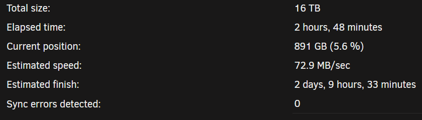

  3. Is there a way to check if the current parity check task is set to 'write corrections to disk'? Also, do those corrections get written as the check moves along? Currently says 17000+ errors detected Wondering if I should just cancel this parity check and investigate further using the check filesystem you mentioned above.

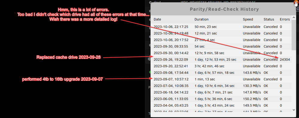

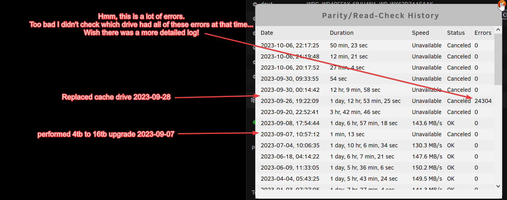

  4. Hi there, Trying to get to the bottom of this + learn a little bit more about RAID5 and Unraid... Everything was fine with this server until we started running out of space. Unfortunately I didn't have many safeguards in place to stop every drive from being filled and it got to the point where Unraid was unstable and I had to manually delete some stuff via network connection using Windows File Explorer. Upgrade drive finally came in the mail about a week ago. 16tb Toshiba to replace one of our 4tb WDs. I unassigned the drive, pulled it out and replace it with the 16tb drive. I booted and re-assigned the drive, then started the parity-sync. A few weeks later, we started having some issues with our NVME cache drive, so we replaced it with a 4tb NVME. I decided to move from btrfs to XFS with our cache drives. Replacement procedure was copy data from cache into a folder I created called "cache_backup", power down, replace drive, start up, format & re-assign, transfer data from array to cache. Restarted the dockers (which rely on the cache) and everything (mostly) worked fine. This server is stored / operating off site from me. I instructed the host of where it lives to power down the server, replace the NVME and let me know when its done. What I didn't notice was that there was a parity check ongoing and there were errors... I have no idea if 'write parity errors to disk' was selected or not. About a week ago, we started experiencing some issues again. The main issue was that parity checks were ridiculously slow (like 400 KB/s instead of the usual 150 MB/s) and a few of our backups that we store on the server weren't loading properly. At this point, I knew about the previous parity errors from the last parity check but by now we had already cycled at least 8tb of data on/off the server. I assumed that we had a dying drive, but after investigating SMART, they all seemed fine. I finally concluded that it was a hardware issue, SATA3_2 and SATA3_5 ports on my motherboard had died. I verified this by plugging those two drives into my SAS card (lsi 9211-8i) and the problem was solved, parity check now performing at ~150 MB/s. At least, for about the first 30 minutes. I started to notice that there was about 30 MB/s of writes happening on both my Parity drive an Disk 2 (the one that was upgraded, I believe) and proportionally higher Reads on both disks. If only there were some way to see what the parity check was doing... Hmm... maybe iotop? TID PRIO USER DISK READ DISK WRITE SWAPIN IO> COMMAND 24031 be/4 root 24.65 M/s 24.75 M/s 0.00 % 98.19 % shfs /mnt/user -disks 2047 -o noatime,allow_other -o remember=0 So, what is shfs doing with all of the disks? Who knows.... Here's a little timeline of what happened over the last few weeks: tl; dr: Parity check is running, getting some writes on two drives but not getting any sync errors. Concerned about what is going on. Unraid won't explicitly tell me anything about an ongoing parity check. serverus-diagnostics-20231006-2358.zip
