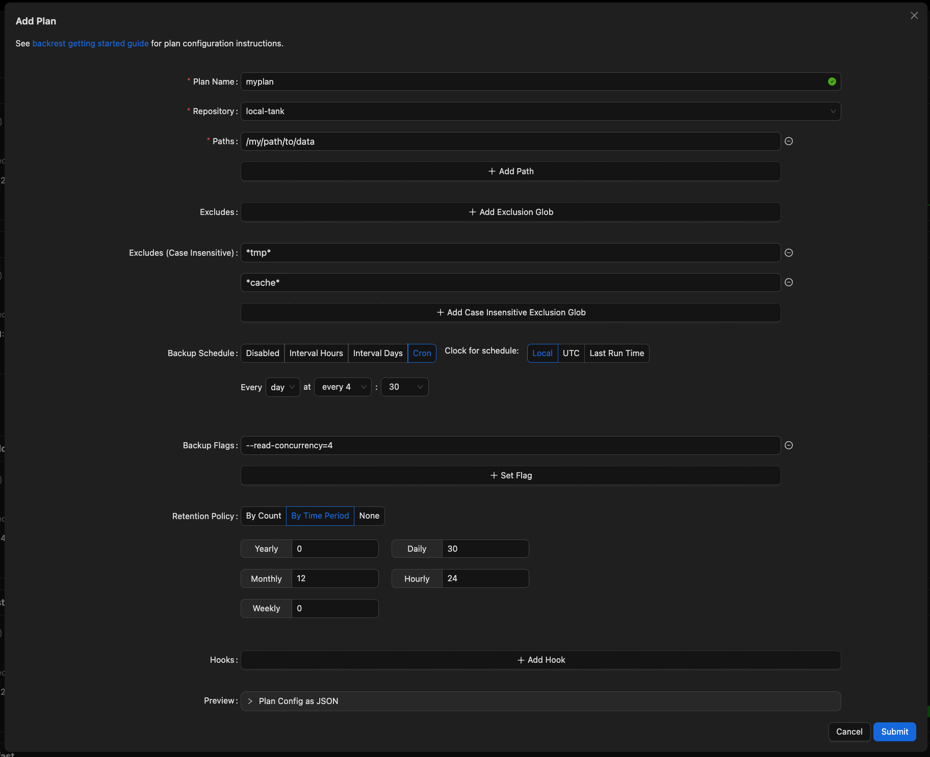

  1. Hey zer0ed, good catch. I've updated the template to make that RW by default. Also added a default /mnt/user/appdata/backrest/tmp:/tmp mount to the template which should solve issues with running out of space in docker.img. Existing users with the template shouldn't need to add it unless they are experiencing excess docker disk size from large chunks during restore/backup, or if they are running out of RAM. @lococola , sorry - didn't see this, the issue is that inside of backrest you want to use the container mounted paths so /backup, /repos, etc. If you want you can just mount /mnt/user/resticbackup:/mnt/user/resticbackup then use the same path inside of backrest.
  2. Hey guys, I think most of the issues here is related to how you set up your plan. See: from https://garethgeorge.github.io/backrest/introduction/getting-started/ For example for my own plan the only difference here is that my path is /backup/some-cool-unraid-folder. The only mapping i have is /mnt/user/backup => /backup. @matt020191 you may want to map /tmp to /tmp or /dev/shm to /tmp if it is filling up the container for some reason. It shouldnt be an issue in most cases unless you are backing up 10+TB in which case the cache/tmp may reach 100s of gigs. Using Docker directory instead of image would also fix this. @xman111 this covers it: https://garethgeorge.github.io/backrest/cookbooks/ssh-remote

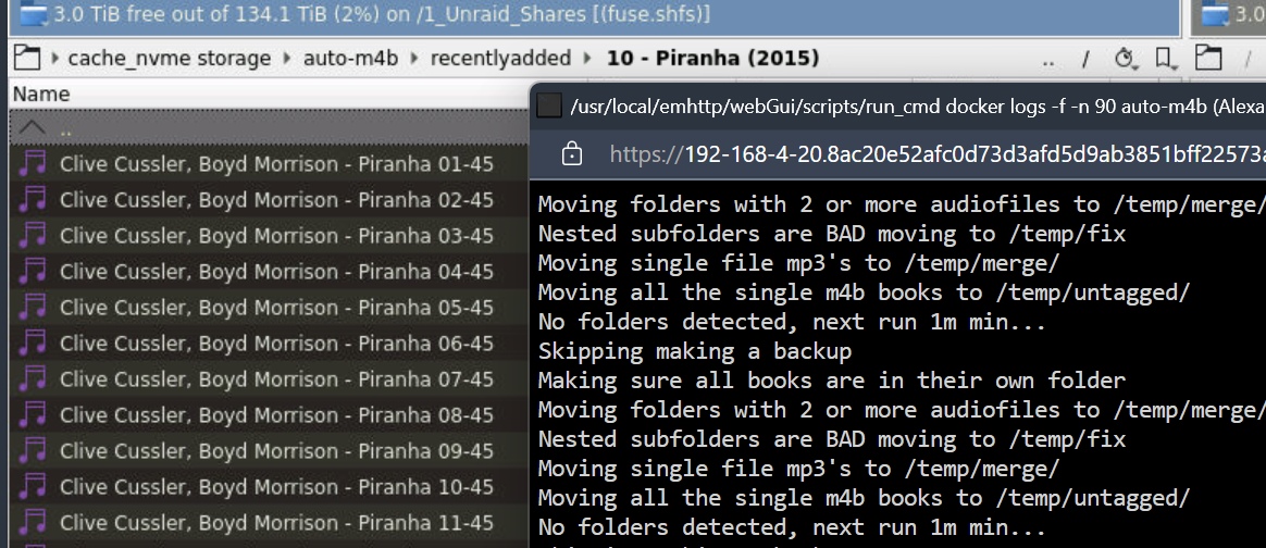

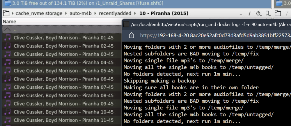

  3. Hey Schubdog, looks like this is due to the m4b-tool package https://github.com/sandreas/m4b-tool/issues/258 that it uses. It may have been fixed though if you force recreate the docker to have it grab the latest binary. Looks like some PHP 8 compat stuff... not sure if auto-m4b dockerfile may need to be updated accordingly.
  4. Do you mean the backrest data? It is specified with a environment variable BACKREST_DATA, default is /data
  5. Hey, did you get this working? I think you should try 777 perms on all of the m4b folders that are mounted.
