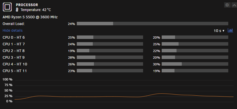

  1. Okay, waiting around for a new version of unraid got me a little impatient... Via the Tools -> Update OS, I reverted back to version 6.12.2. I am happy to report that the encryted datasets can write data much more efficiently now. Here a screenshot of the cpu usage now with the same workload: This is more in line with my expectation. Thanks for the help!

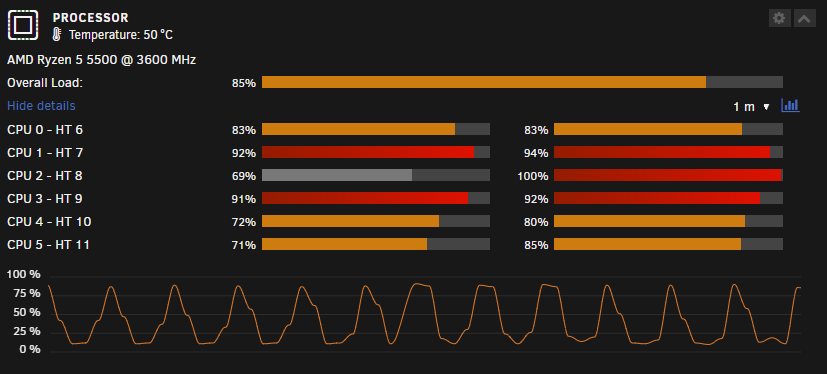

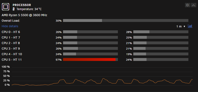

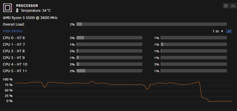

  5. Hi all, I have recently reshuffled my unraid server with zfs. I went from a non-encrypted zpool to a zpool with almost all datasets encrypted. I noticed a quite significant and non stable overhead on my system (see image with overall load = 85%), when copying my data (large photos of +- 30MB each) back onto the new encrypted zpool from another (single) harddisk. As a debugging step I have tried the 'top' command to see what is eating CPU resources, giving me the 'z_wr_iss' process. I read that this process handles the writes to the zpool and also handles the encryption. My CPU is a AMD Ryzen 5 5500, checking for the encryption hardware give me a positive result: root@Deimos:~# grep -m1 -o aes /proc/cpuinfo aes aes root@Deimos:~# grep module /proc/crypto | grep -v kernel | sort | uniq module : aesni_intel module : crc32_pclmul module : crc32c_intel module : crct10dif_pclmul module : ghash_clmulni_intel module : sha512_ssse3 Then I tried to copy that same data to an unencryted dataset to check if this cpu overhead was due to the encryption. The result is shown in the image with overall load = 30%. So it looks like the encryption is adding a significant overhead!!! The system at idle (stopped copy tasks) is shown in the image with overall load = 2% Finding out what encryption is used for my datasets: root@Deimos:/boot# zfs get encryption phobos/nino NAME PROPERTY VALUE SOURCE phobos/nino encryption aes-256-gcm - I read that zfs encryption has only a 1-10% performance hit vs. non-encrypted dataset in terms of speed. I read that this encryption could and/or should be handled by the aesni_intel crypto-acceleration-hardware. I copy with rsync. What I'd like to know: is this large overhead normal behaviour for encryption, or is something misconfigured? Thank you in advance!
