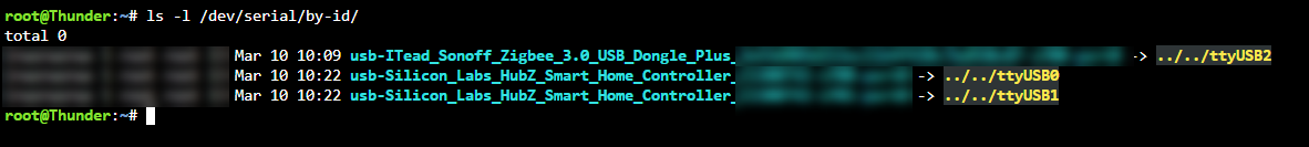

  8. Maybe try a different USB port? When I run the command I can my sonoff 3.0 and my combo Zwave/Zigbee dongle.
