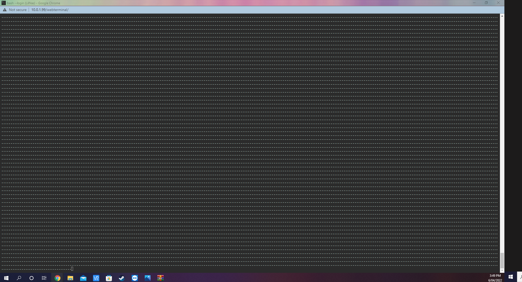

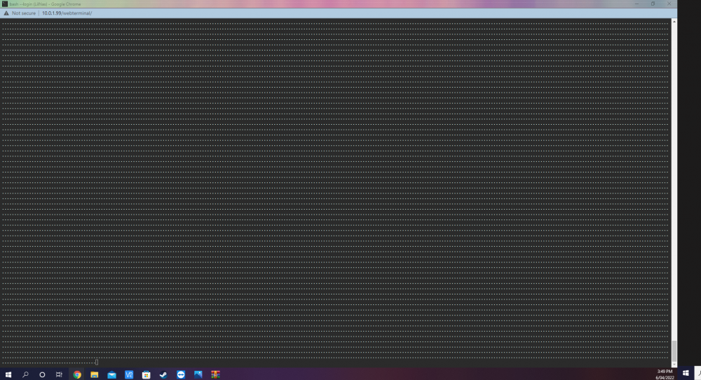

  4. Ok no worries, ill start with the 4tb disk and let it scan overnight, it will eventually have a result right? or if it gets stuck, is it likely to just endlessly search?

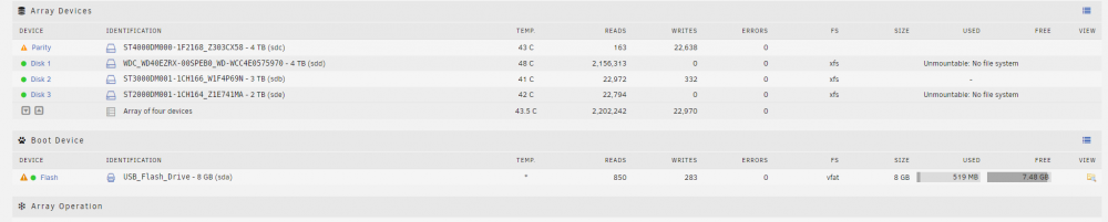

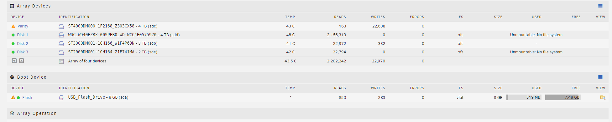

  5. Yes, following some solutions youve given to other users, I used the xfs_repair -v /dev/md7 command (changing MD7 to the number of the drive needing repair EG MD3)
