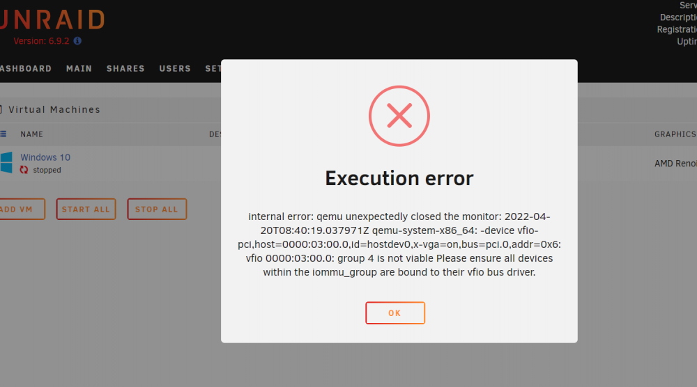

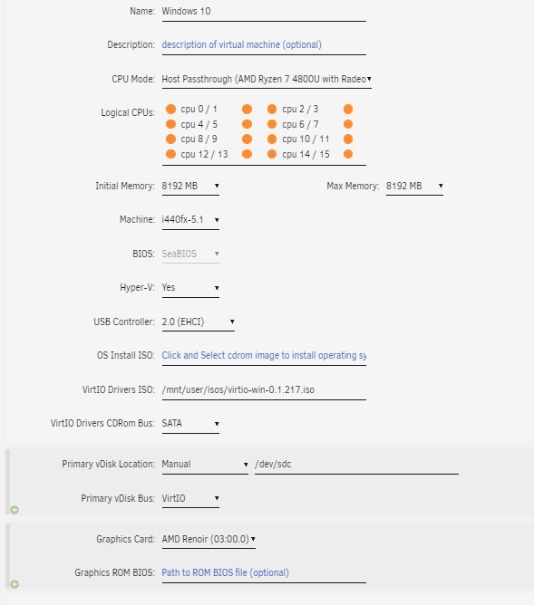

  1. Hi i tried to use https://hub.docker.com/r/seafileltd/seafile-mc instead of https://hub.docker.com/r/seafileltd/seafile (outdated, 3 years old). with the seafile template delivered with the community plugin list. Installations and start works. Opening the seafile site = nginx bad gateway. The old version worked. Any advice?
