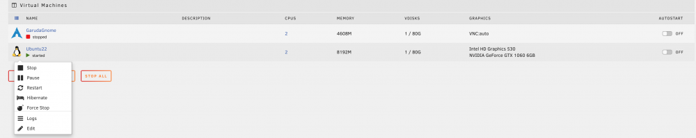

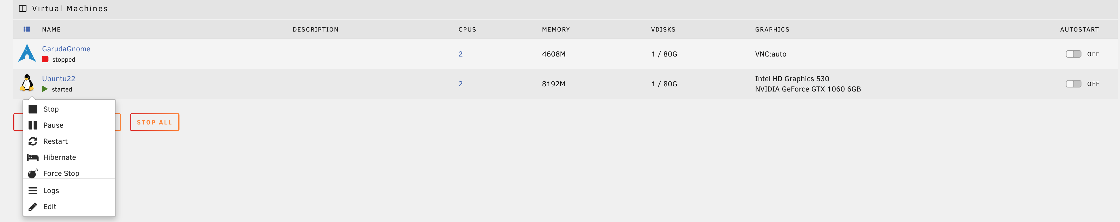

  4. Hi ghost82, Thanks for your response. I'm not sure I follow your instructions completely. 1. Sorry, I uploaded an incorrect diagnostics file that I had downloaded from this forum!!! Attaching the right diagnostic file now. 2. I don't have a matrox g200 graphics card, just Intel integrated graphics and GTX 1060. I created the Ubuntu VM with Intel graphics as the primary and GTX 1060 as the secondary. It has successfully started but how do I connect to it? When I right click on the VM, I don't see an option to "remote" to it. 3. I have ACS Override and "Bind to VFIO at Boot" selected for the Nvidia VGA and audio devices. However, I'm unable to dump the gpu vbios using SpaceInvader's script as I'm getting an error. Appreciate your help. zion-diagnostics-20220724-2356.zip
