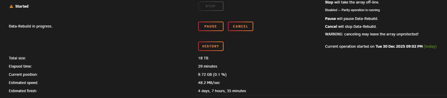

  1. Finaly, I have an acceptable speed for the disk rebuild So, I think my issue was that there was an ongoing scrub job for multiple of my disks at the same time that I wanted to do this disks swap activity. not really sure what was my lesson learned from this. check everything? :') I think this topic can be considered closed.
  2. Updates. Looks like there was some scrub jobs in two of my drives. I stopped it for now and the speed rose to ~40MB Is there a way to do that?
  3. Booting in safe mode and running in maintenance mode will return the speed to what should be 100~200 MB

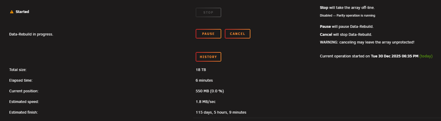

  7. Back again. The parity has been completed successfully. Now, I have swapped one of my data drives to increase the capacity "this was the final goal" unfortunately, I am facing the same issue as the parity. Speed is averaging 1.5-2 MB

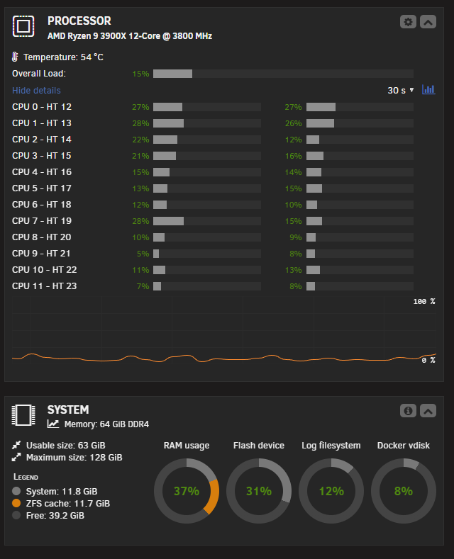

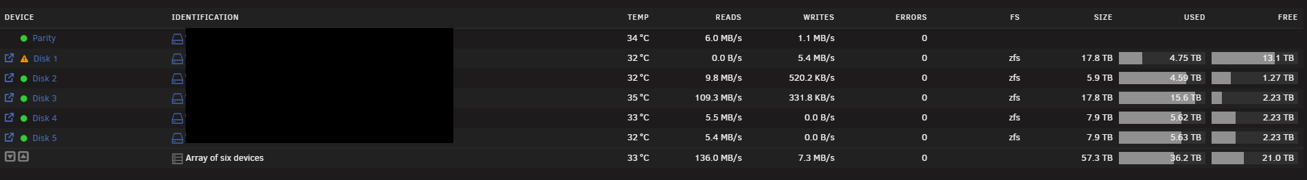

  8. All screenshots were taken while the parity check was running. I disabled docker completely from Settings --> Docker --> Enable Docker "No" I also disabled VMs just in case it will help or not "I am not running any VMs currently"

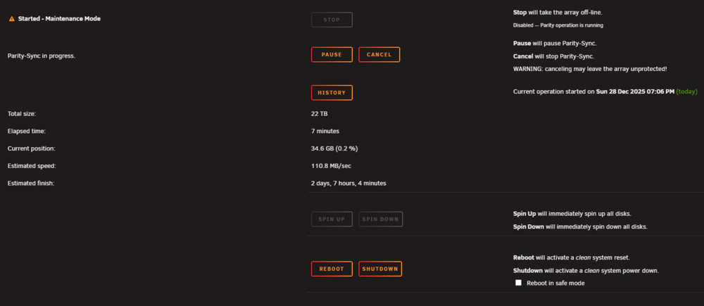

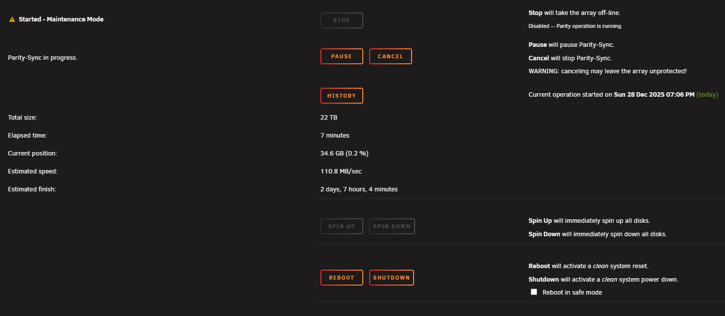

  9. Increasing the zfs memory allocations did not help unfortunately. I have stopped the parity check and started the array in maintenance mode and now the parity sync speed is +- 100MB While it is unfortunate that my services will be down for three days but at least the parity check will not take half a year. Not really sure what was the issue here

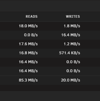

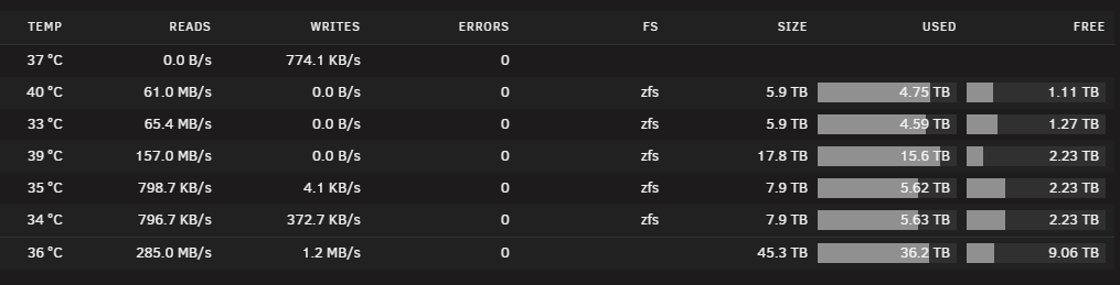

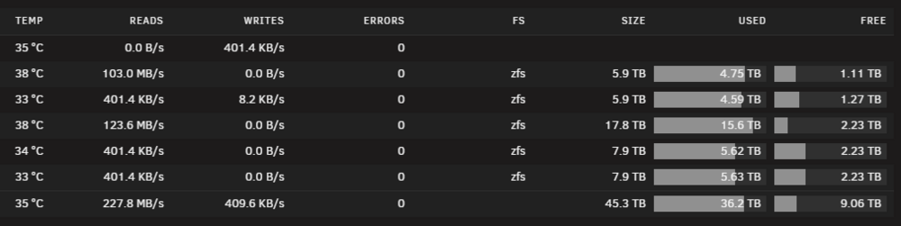

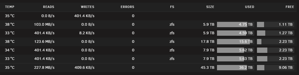

  11. Sorry for the late reply. These are the disks while Docker is enabled. And these are the disks while Docker is disabled. Not really sure what is running the disks for 255 MB Read

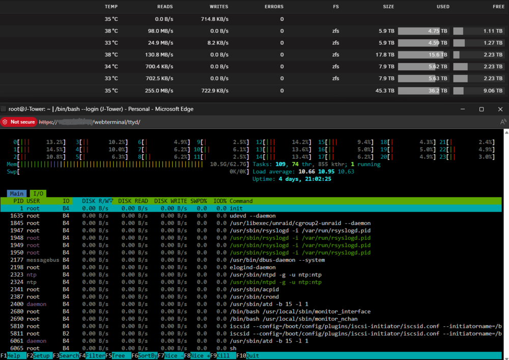

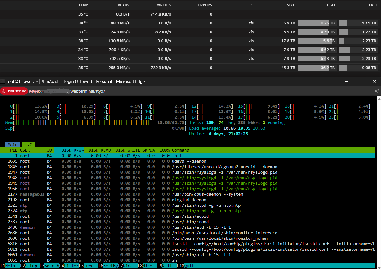

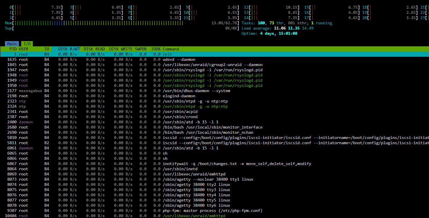

  12. I saw that a single container was restarting from the uptime like you mentioned. I stopped it for now. I have a scheduled restart for a multiple of my containers on daily basis at midnight but I don't think this is affecting it. NOTE: I have tried to stop docker engine and VM Manager to see if by stopping everything will it help or not. Unfortunately, it did not. This is what htop I/O tab looked like

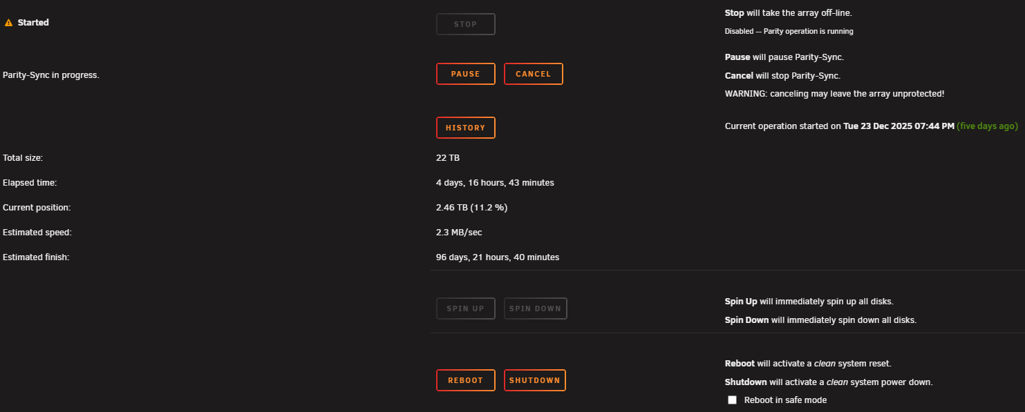

  13. Hello All, I have started the process of upgrading my parity drive from 18 TB to 22 TB. I have used the following steps on swapping the drive Replacing disks in array | Unraid Docs Which was simple 1. stop array 2. remove parity 3. start array 4. stop array 5. replace drive 6. start array 7. start parity check So far, 5 days have passed and only 11.1% from parity completed. My average speed looks around 1-2 MB/sec I was using my server as usual "downloading/reading/playing media" and while trying to troubleshoot the issue I read in the forum that read/write while doing the parity check will affect performance. I have currently disabled docker and VMs and the speed is still 1-2 MB/sec. Is there anything else I should look at? htop system load disk performance j-tower-diagnostics-20251228-1026.zip
  14. jeezany started following Slow Parity Check
  15. Hello, so far the system is up and running. looks like it was the power state option in the bios that created the issue. Thank you for your help @JorgeB
