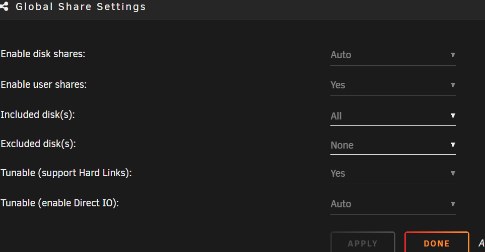

  1. Unraid OS 6.12.4 media array disks 2, 3, 4, 5 - all 10tb drives. Configured Min free space 30GB, Allocation Fillup, Split only top two directory level, included disks 2, 3, 4, 5, excluded none, Array shows total of 28tb free space. Has been working fine until tonight. Disk 2 @ 195MB free, Disk 3, 21.9GB free, Disk 4 8.6TB free, and Disk 5 empty 9.8TB free (was added to this media tonight). Started bult transferring media to array and it failed for 'no space". Began transferring one by one and noticed that they kept going to disk 2 instead of cascading as they had been to disk 4. So disk 2 is at 196MB and I can't add more files to the array. I don't know what I have set up wrong. Need some guidance.
  2. thank you Kilrah for that information. I kept expecting when I created the share w the multiple drives that it would create the share name/folder across each of the drives in the included disks. So this doesn't happen except when the first disk in FILL UP mode is full. I shall begin my transfer process now w the settings I have made changes to in the share

  4. I still need some assistance and clarification. Thank you for everything so far. When a user share is created via Shares - Will the share be created across all the disks that named in "included disks"? When I created the share it only went into the first disk? I am using allocation - Fill-up and a split level of 2.

  9. Need some help. Equipment: Unraid 6.10.3 with media share config: Fill Up, No cache, minimum free 35GB, split top level only, include disks 2, 3, 4, 6 - all disks are 9.1TB Doing a rsync copy command I got a 71% warning, then several 9x% warnings (which are fine those are default settings). Rysnc twice has terminated No space left on device (28) with a few other lines of text which i assume are part of the same error message. nated because of not enough space. disks 3, 4, and 6 are empty. So what could be going on that these files do not continue copying to the next disk in the share? Rsync error message- first few words are part of the actual file it stopped on. 996 1080p Bluray Remux DTS-HD AVC 5 1-decatora27.mkv": No space left on device (28) rsync error: error in file IO (code 11) at receiver.c(378) [receiver=3.2.3] rsync: [sender] write error: Broken pipe (32) I am copying from a SMB share; //diskstation1/plex_media to the share. Command is rsync -avh /mnt/remotes/DISKSTATION1_Plex_Media/Movies/ /mnt/disk2/movies/720p_1080p I THINK I JUST ANSWERED MY OWN QUESTION. I will test this theory. Above i choose disk2 instead of user!!! I was following spaceinvaderone tutorial and I don't recall now if he used the disk or the user for the destination. Nope that wasn't it. It crashed just the same when using /mnt/user/movies/720p_1080p as the destination. This is the share config
