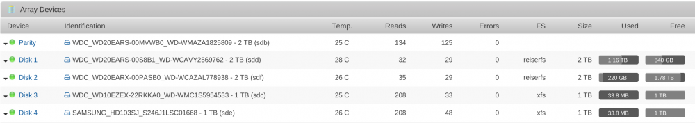

  3. So to make sure I understand the concept that I'm going to do: I have an empty 1TB drive (with xfs) and a 2TB drive (reiserfs) with a small amount of data on it. Therefore copying data from 2TB drive to the 1TB drive. Format the 2TB drive just used. That gives me a 2TB drive with xfs. That drive will then be able to be the receiver for the data stored on the other 2TB drive I have Then format the other 2TB drive. Job done...? Is that fundamentally what's going on here? This is obviously an action that takes some planning - Google brought me here after I noticed that the two 1TB drives I added were in a different format (my upgrade path was 4.7 -> 6.1.9). Screenshot attached for ease of reference.
