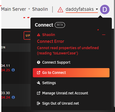

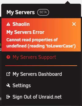

OK, wanted to spread the knowledge of the solution to the above problem. I essentially had a corrupt flash drive, meaning there were the following line was: shareNFSEnabled="y%s" but should have been: shareNFSEnabled="no" or shareNFSEnabled="yes" Especially since I didnt have NFS shares turned on in settings. This was what was causing the error. Not sure how it happened but here is how it was fixed. 1. go to Settings -> NFS. NFS is probably disabled, please enable it and Apply. Then disable it and apply. 2. open a terminal and run: grep shareNFSEnabled /usr/local/emhttp/state/var.ini and it should output: shareNFSEnabled="no" And fingers crossed, the problem will be resolved. <----------- very important. Thank you to unraid tech support, especially to ljm42 for working the problem out with me and showing patience.

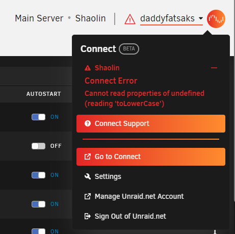

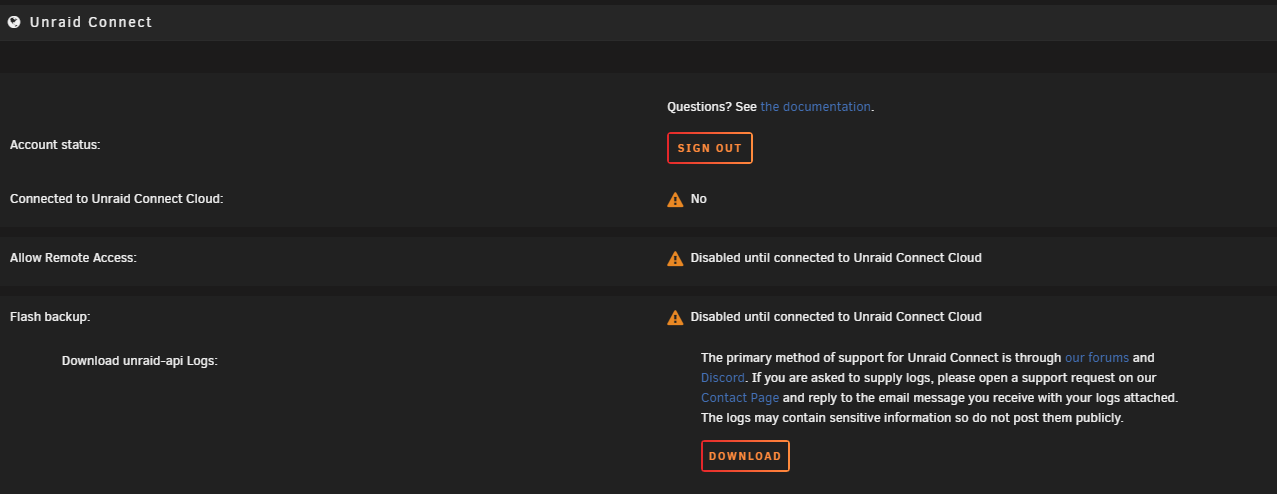

Installed the latest update for unraid connect. but nothing new. Still get the same error as above. I never heard back or got confirmation that my logs were recieved, viewed or helpful. So I guess this is the end until I find or hear something. Unfortunate as my flash backup has been disabled and I will have to find another method of making sure I have backups. This plugin is useless to me at this point, so I believe uninstalling it would be the way to go for now since I don't like seeing a big error symbol every time I log in. Thanks for the help.

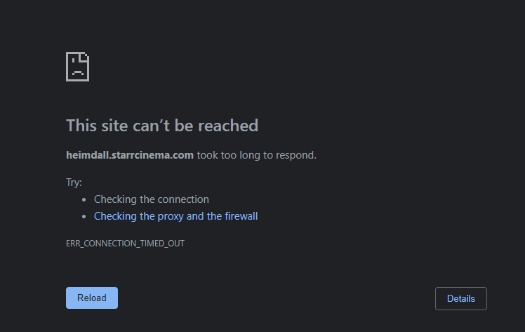

SWAG seems to stop working randomly but don't see any errors in logs
ok I'm a idiot. My issue was resolved by going into cloud flare (using for DNS) and updating my ip address under DNS --> Records in the DNS management for my domain. Hope this is your issue as well. I did notice SWAG has some updated .conf files. I would recommend using those if you haven't. May help.
I am having the same issue as well. Mine started about a week and half ago. My next steps are to reinstall the container. Hopefully that fixes it. At first I had a couple of sites that would not connect but it has since spread to all my sites. I get a timed out message.

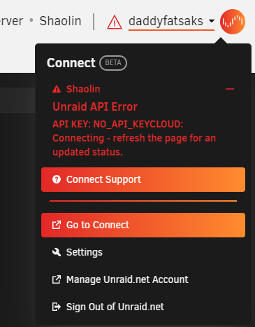

Looking at my logs I noticed this in my unraid-api.txt: Logging in user: daddyfatsaks Failed loading state file from "/usr/local/emhttp/state/var.ini" with "Value "y%s" is not false/true or no/yes." UPNP Enabled: (undefined) Wan Port: [Will Generate New WAN Port] <-----UNRAID-API-REPORT-----> SERVER_NAME: Shaolin ENVIRONMENT: production UNRAID_VERSION: 6.11.5 UNRAID_API_VERSION: 3.1.0 UNRAID_API_STATUS: running API_KEY: NO_API_KEY MY_SERVERS: authenticated MY_SERVERS_USERNAME: daddyfatsaks CLOUD: STATUS: [ok] MINI-GRAPH: STATUS: [PRE_INIT] ERROR: [API Disconnected] </----UNRAID-API-REPORT-----> When I go to sign out of unraid connect I am able this time but when I sign back in I still get this: I tried to sign out again and its back to not letting me. I also did an unraid-api restart. no change.

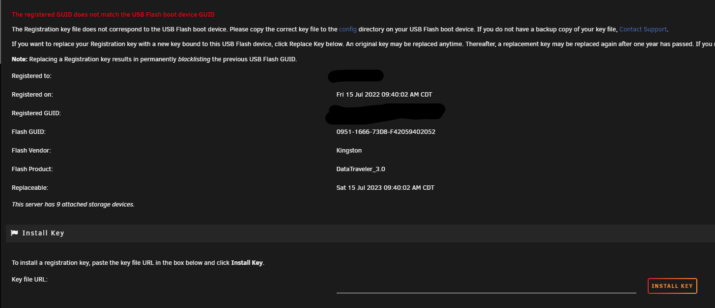

Even without the registration it is telling me the same error but lets see when the key gets tranfsfered sometime soon I hope, since my server and all its services are down.
cannot read properties of undefined (reading 'tolowercase')

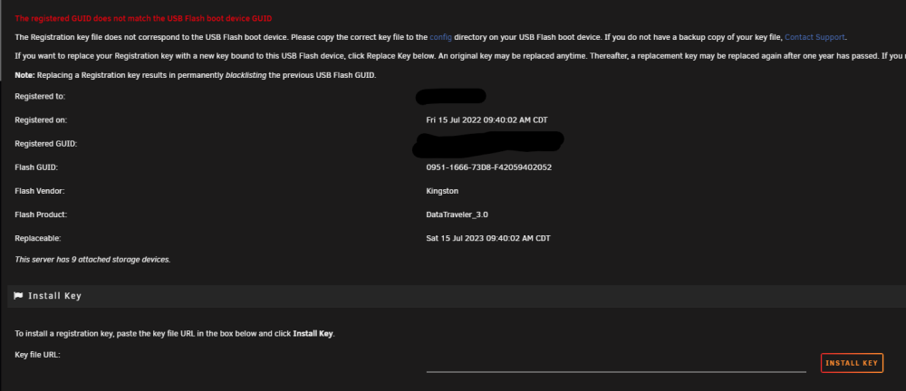

Still working on it. It appears I had a USB fail last year in July. So I have to email customer support to be able to register a new one.
By the way here is the output of the terminal command: <-----UNRAID-API-REPORT-----> SERVER_NAME: Shaolin ENVIRONMENT: production UNRAID_VERSION: 6.11.5 UNRAID_API_VERSION: 3.0.0 UNRAID_API_STATUS: running API_KEY: NO_API_KEY MY_SERVERS: authenticated MY_SERVERS_USERNAME: daddyfatsaks CLOUD: STATUS: [ok] MINI-GRAPH: STATUS: [PRE_INIT] ERROR: [API Disconnected] </----UNRAID-API-REPORT----->

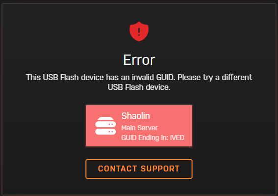

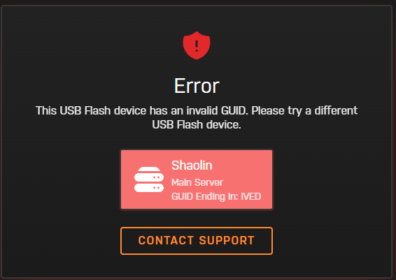

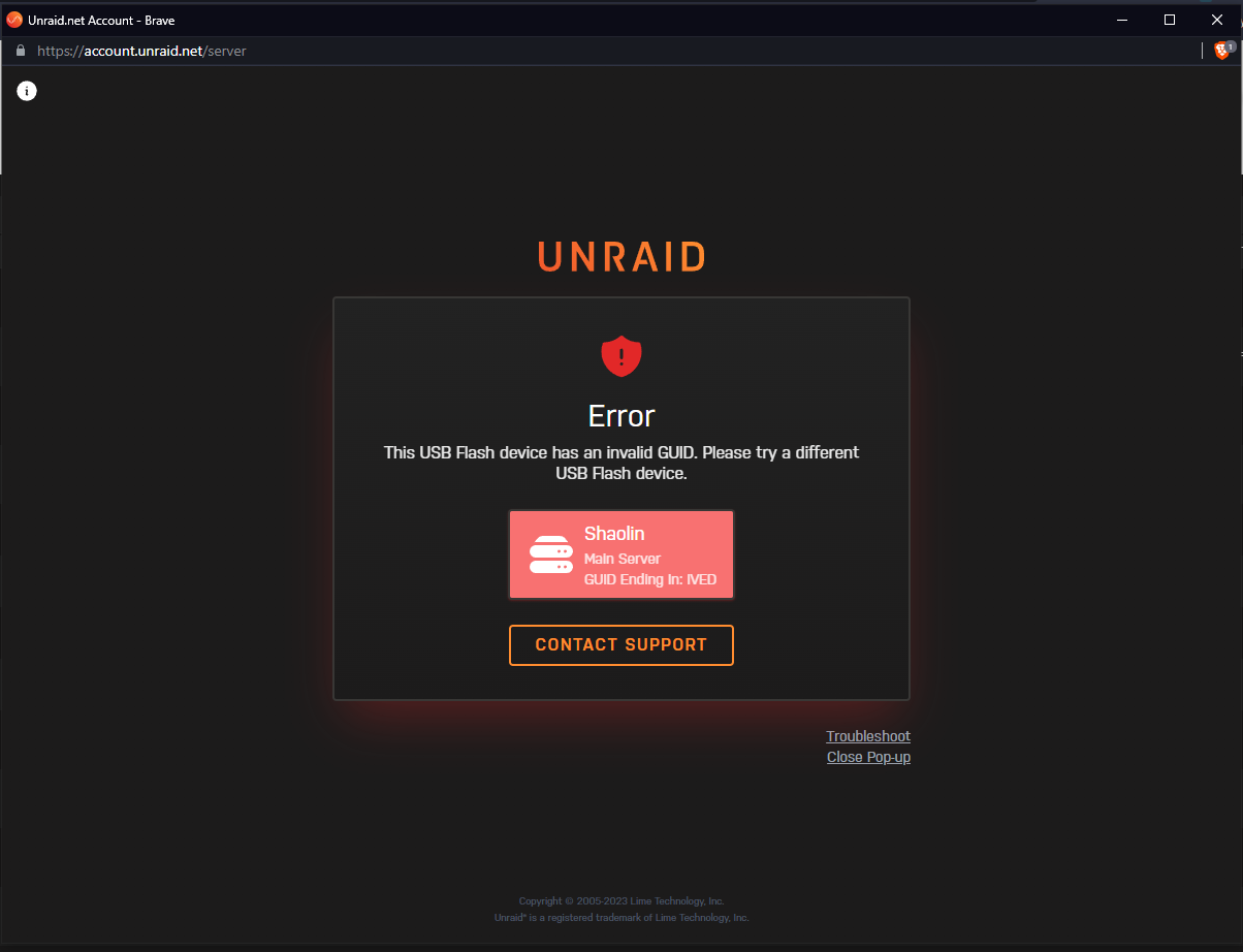

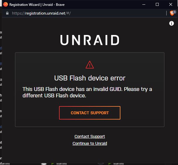

Well that seemed to do something. Its telling me my GUID is invalid. It was about time I guess. I will fire up another USB with unraid and get everything back up and running. After that I will sign back in and see if that fixes the problem.

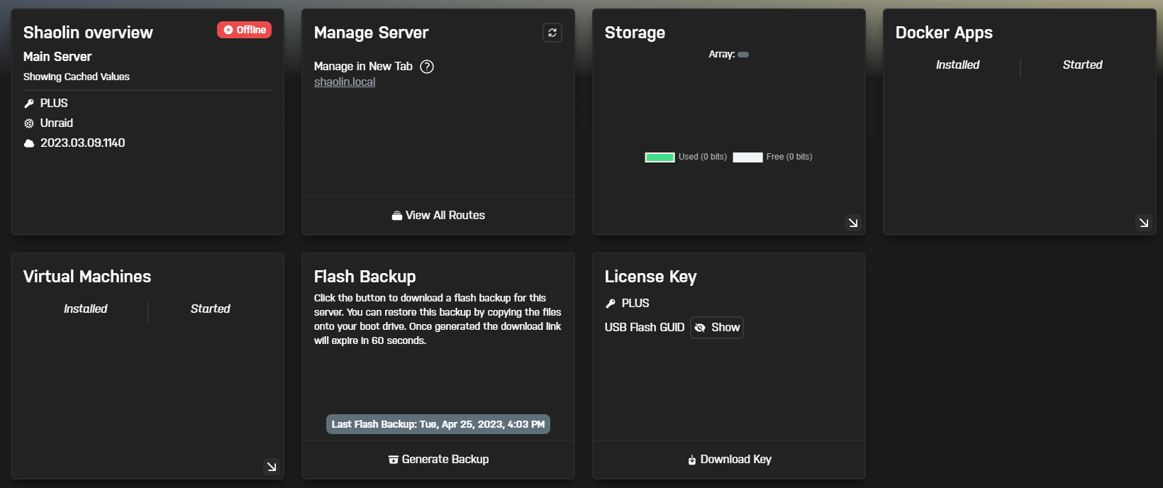

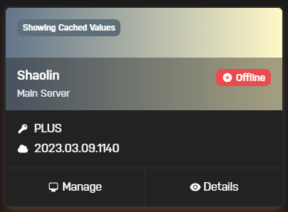

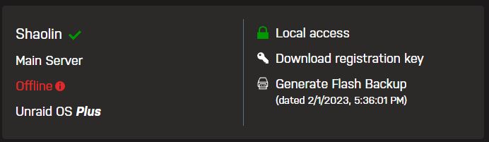

THank you for the update and awesome interface. Unfortunately, my problem still persists. I updated and my connect tells me my server is offline. See below

Greetings, Received and update for the My Servers plugin but it still gives me the same error as below: Any changes or progress?

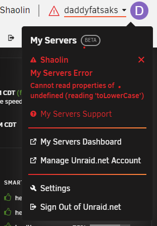

Greetings,after updating to unraid 6.11.5 I see the Myservers error "cannot read properties of undefined (reading 'tolowercase')". I have never really been able to get the myservers plugin working and I was excited to see there were some fixes in the latest update but now I see this error and still have no the no connection to mothership for myservers. I also noticed when I tried to sign out of unraid.net I get a popup window saying "This USB Flash device has an invalid GUID. Please try a different USB Flash device.", and I feel this is all related. Should I swap the USB for a new one? I have tried restarting the server with no positive results. Any thoughts would be greatly appreciated.
