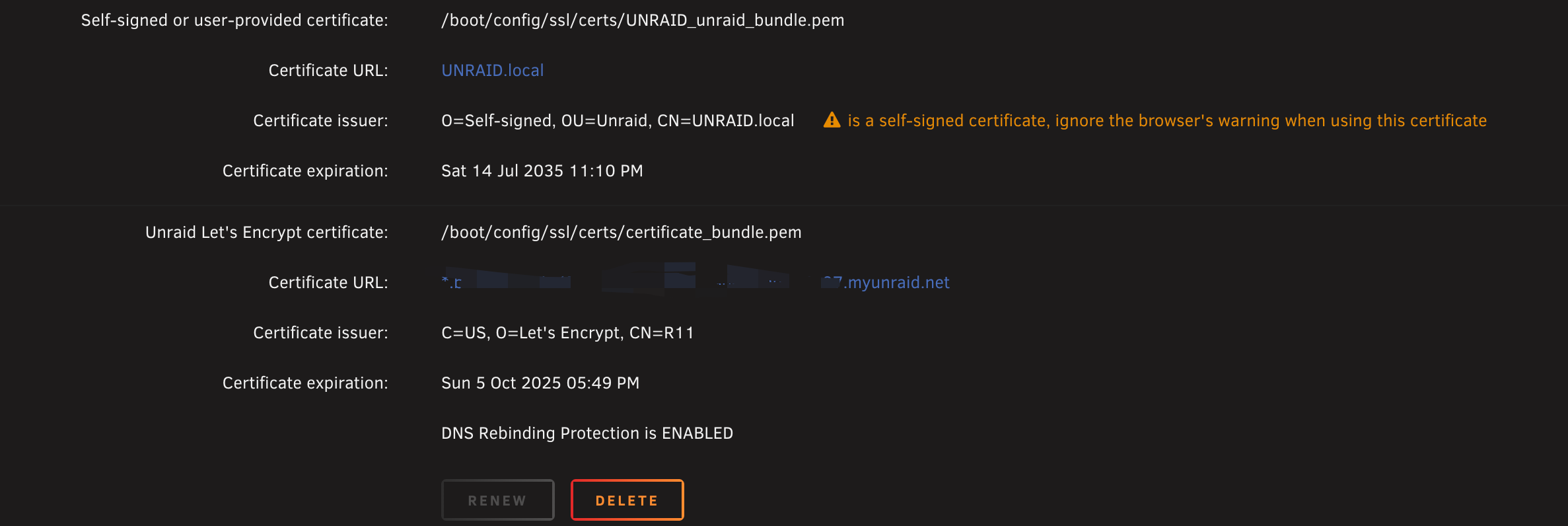

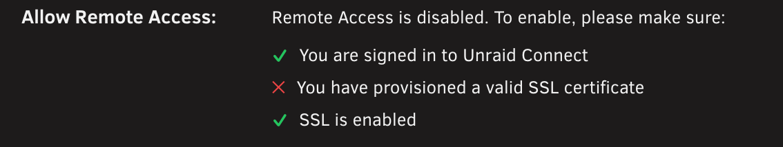

  1. Hi everyone, I recently upgraded my Unraid server to version 7.1.4, and since then, I haven't been able to enable Remote Access. In the Management Access , it shows the message: I tried to delete the cert and re-provision, it doesn't work. Has anyone else experienced this or found a fix? Thanks in advance for your help!

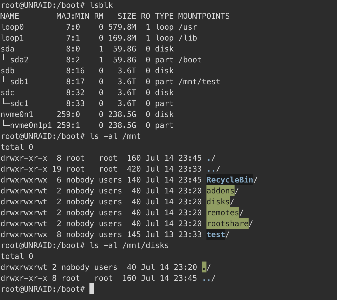

  4. Hi everyone, I'm currently facing an issue with my Unraid server: it's stuck at the "Array Starting" stage and won't proceed any further. I've tried waiting for quite a while, but the array never actually starts. Here's a bit more context: Unraid version: 7.1.4 Symptoms:UI shows "Array Starting..." Drives spin up and are recognized No error messages or alerts Just never proceeds to "Started" or mounts shares disks are not mounted, but can be mount manually(/mnt/test) What I've Tried:Rebooted the system multiple times Checked the logs (nothing obvious stands out to me) Ensured all drives are connected and detected in the dashboard No recent hardware changes No plugins that seem obviously related unraid-diagnostics-20250714-2332.zip
