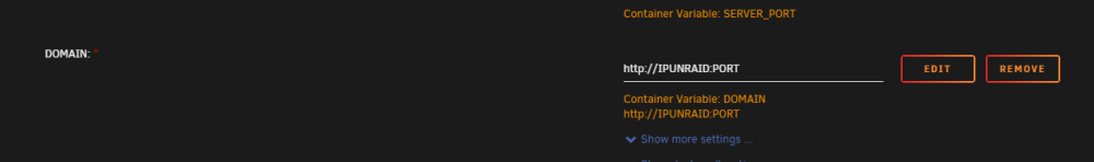

  6. So change it to the IP your unraid server is on example "http://192.168.1.123:5000"
  7. Network error is caused by this. Default login btw is admin:admin @Kudjo

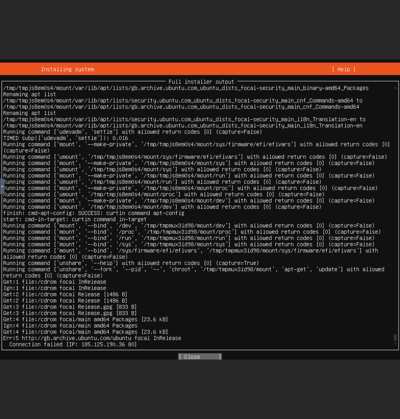

  9. Hello Unraid community, Here's a weird one, I had no problem with making Ubuntu VM's on 6.11.0 and 6.11.1 but now suddenly I'm presented with errors I haven't encounter with a VM running Ubuntu server, it seems like my VM isn't getting an internet connection but I can ping other websites from that VM no problems. I also get this when making a new VM followed by a connection failure to http://gb.archive.ubuntu.com/ Once the system does boot I cannot even perform basic commands like "sudo apt update" as this just results in waiting for header 0%. So I tried using the desktop version with the same static IP configuration I had setup on server version and not a single problem at all. So instinctively I assumed by Ubuntu server iso was corrupt or something, nope same result. I cant tell if its something to do with Unraid or me, but like I said at the start of my post, not a single issue has occurred until today. I have even tried a clean install of unRAID and the same result. I look forward hearing from someone who can help with my situation, thank you.
  10. Resolved, just wiped my USB drive, installed unRAID, restored my config folder and worked like a charm.
