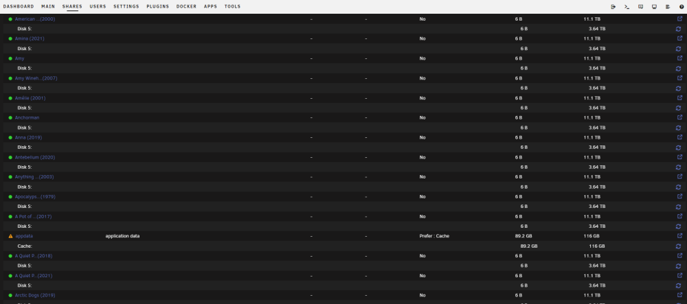

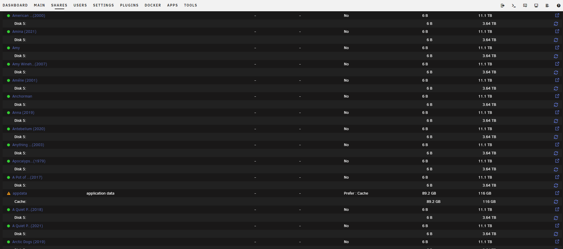

  3. Trying that now - I *THINK* that worked, aside from deleting an important folder by mistake. So.. what happened there do you think?
  4. Bizarrely, yes. LS'ing /mnt/user is all the real shares and what should be content of the Movies directory. I can see the files correctly by ls on the /mnt/diskX/Media/Movies. That's where I'm saying the linking is at issue. the files are in the correct directory, just that the link to the user folder is wacky unraid-diagnostics-20220930-0942.zip
