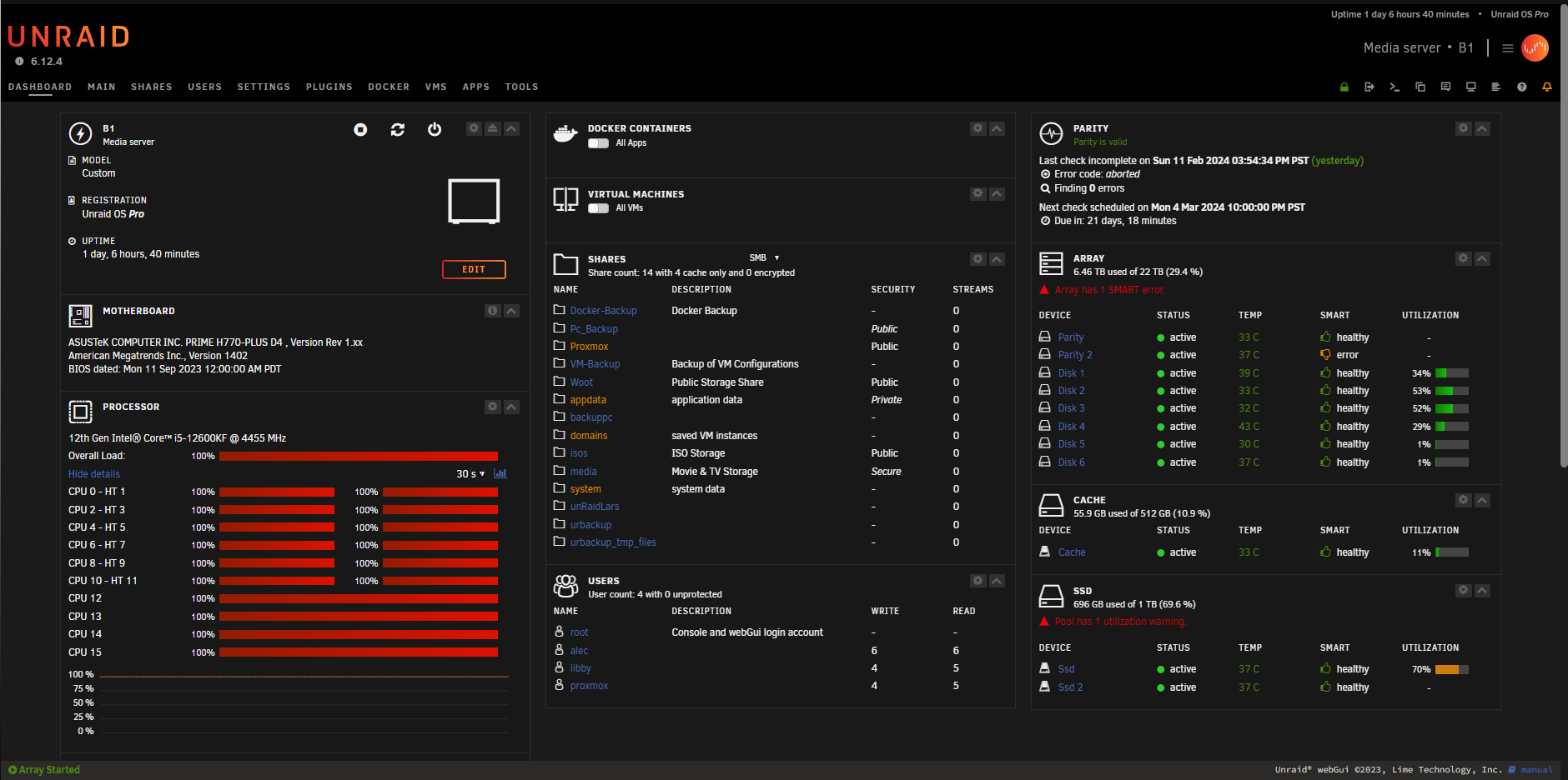

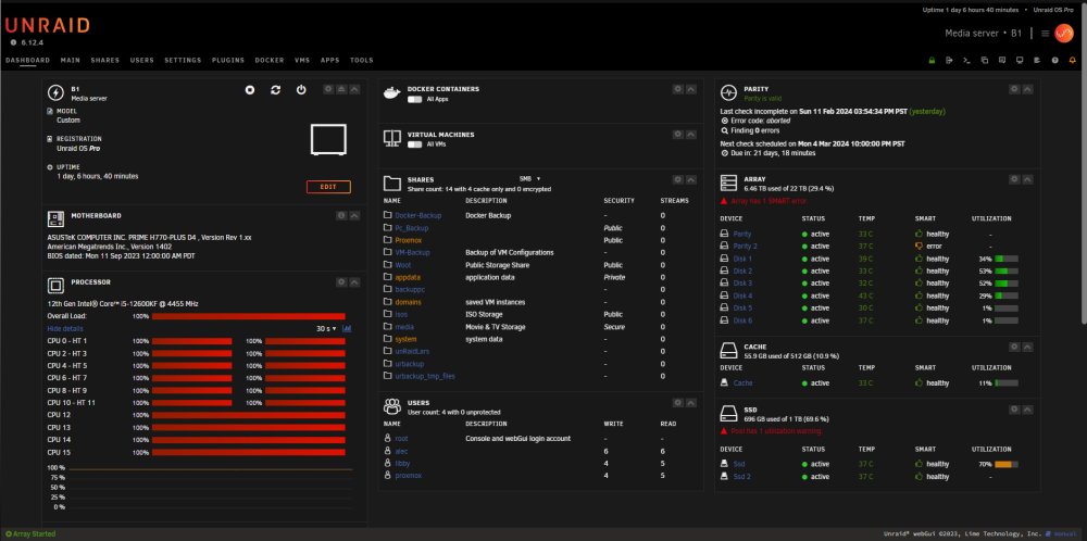

  5. Hi I am looking for a recommendation for a PCIe card that has 8 Sata ports that fits in a x4 slot. I need an additional 8 ports but my board only has x1 and x4 slots available. I would get a SAS card but I've only seen x8 SAS cards. I have tried https://www.amazon.com/dp/B0B2WRDXQJ?psc=1&ref=ppx_yo2ov_dt_b_product_details but it was causing my system to crash. Does anyone have any experience with a card that does work?
  6. I have been having trouble with unraid where all the CPU cores will hit 100% and then the system will hard lock. It happens at least once every 24 hrs, requiring me to do a hard reset. I am unable to find the cause of the issue. I have tried several solutions to no avail.I have updated to 6.12.8, I have macvlan turned off in docker, tried booting in safe mode and running with out docker and vms but it still crashes sometime in the middle of the night. I have even tried rebuilding my boot drive incase that was the issue. The diagnostic has the last few days of system logs but I haven't notice any cause of issue. b1-diagnostics-20240219-1138.zip
  7. I don't know what caused the issue, but updating from 6.12.0 to 6.12.3 fixed the issue.
