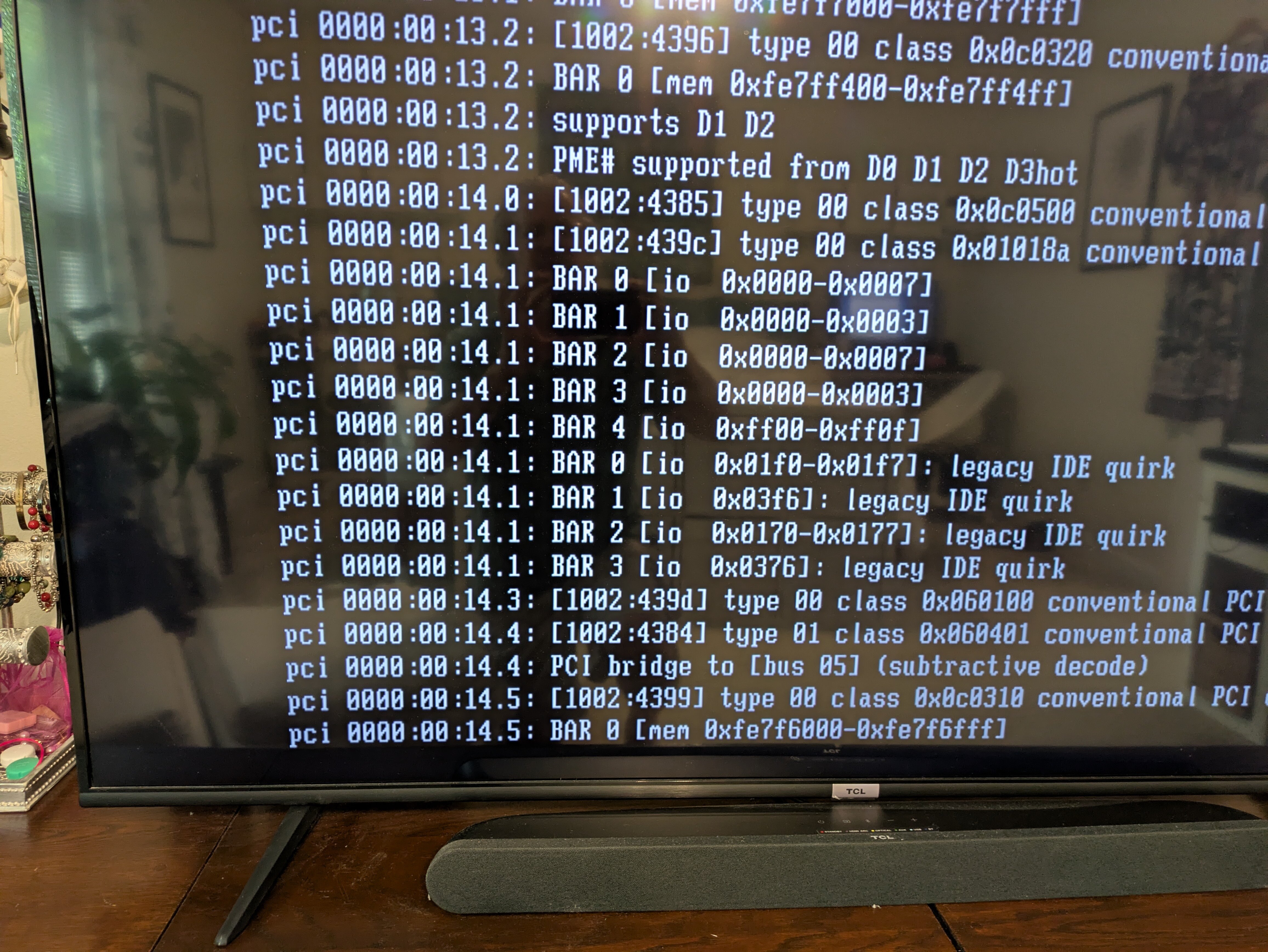

  2. Hello. Booting my backup server (bottom in my sig below) and it's been stuck at least 30 min now per the image attached. Can anyone tell from this what the issue might be? Also any choice now except to hard power down? I assume there's no way to get it to shut down gracefully or do anything else since it's not even booted yet but if it would be better to wait and hope that it's doing some in background and might still finish booting I'm open to that too. Thanks in advance for any help.
