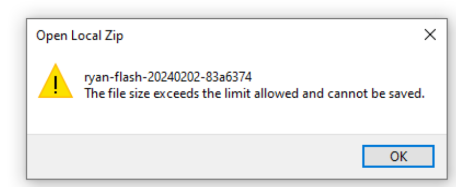

  2. Hello everyone, when running the USB Creator tool on Win 10 I get the attached cryptic error message upon selecting a flash backup on my disc. How can a backup, that is done by unraid be to big for the unraid usb creator tool to work with? Does anyone know what this means and how to fix it?
