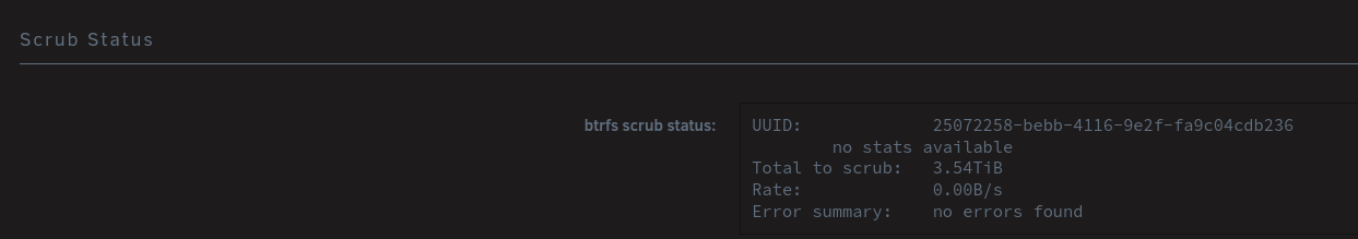

  1. The scrubs are finished. One interesting thing is mentioned in the log on only one file and one disk device (Disk2). It also increased the corrupt count by one. Sep 9 19:09:36 Mountain kernel: BTRFS error (device md2p1): scrub: unable to fixup (regular) error at logical 2516431667200 on dev /dev/md2p1 physical 2479865724928 Sep 9 19:09:36 Mountain kernel: BTRFS warning (device md2p1): scrub: checksum error at logical 2516431667200 on dev /dev/md2p1, physical 2479865724928 root 5 inode 50073 offset 473669632 length 4096 links 1 (path: /Local/path/to/a/file) Sep 9 19:09:36 Mountain kernel: BTRFS error (device md2p1): bdev /dev/md2p1 errs: wr 0, rd 0, flush 0, corrupt 90, gen 0 UUID: 2a0d2f19-28b0-482d-9ca7-b9a36c7557a1 Scrub started: Wed Sep 9 13:42:53 2026 Status: finished Duration: 7:32:51 Total to scrub: 3.12TiB Rate: 122.19MiB/s Error summary: csum=1 Corrected: 0 Uncorrectable: 1 Unverified: 0 What I do know about this file its not touched that often, but can be on occasion. The HBA monitor on the PHY endpoints didn't report any issue, also the HBA viewer had no other report or any error. It is a disk but was introduced in the system about 1 year plus a bit more ago. So may be linked. But hard to say. I'd think I can try swapping it out, or remove the specific file that is unrecoverable? It would be something to try. I have two SMR disks in the system this is one of them. No SMR disk should be used as parity as I'm aware. But as normal operational run, could it cause these types of instabilities? Or would it look like a HBA problem, I can also just click the disk into another bay as a test. The disk 2: WDC WD60EZAZ-00ZGHB0 (Smart data also attached) (1 year and 5 month runtime) used as another disk was failing after 9 years. The disk 6: WDC WD60EZAZ-00ZGHB0 similar type (2 year and 5 month runtime) used as data extension at the time. The rest are all CMR's thoughts any thoughts on this. @MowMdown The memtest running for 3 cycles, was I believe over a few days as it takes a while run a full cycle of all test patterns. WDC_WD60EZAZ-00ZGHB0_WD-WX12D207TEVJ-20260910-1303.txt
  2. Hello JorgeB. Thanks for the quick reply and input, I updated the HBA just now as per your input to latest I could find on Broadcom's site so 16.00.01.00 and also the Bios of the card is updated. I'll run the scrubs, I missed the BTRFS error counters somewhere. Its scrubbing monthly (or at least should.) but never reported any errors in the BTRFS scrub status as far as I'm aware. Its I guess its logged in the kernel log location than this one below. But If I look in the log I can indeed find the error counts, so those are these right now. So I'll keep these under observation. Sep 9 13:27:18 Mountain kernel: BTRFS info (device md1p1): bdev /dev/md1p1 errs: wr 0, rd 0, flush 0, corrupt 4, gen 0 Sep 9 13:27:21 Mountain kernel: BTRFS info (device md2p1): bdev /dev/md2p1 errs: wr 0, rd 0, flush 0, corrupt 89, gen 0 Sep 9 13:27:26 Mountain kernel: BTRFS info (device md3p1): bdev /dev/md3p1 errs: wr 0, rd 0, flush 0, corrupt 255, gen 0 Sep 9 13:27:30 Mountain kernel: BTRFS info (device md5p1): bdev /dev/md5p1 errs: wr 0, rd 0, flush 0, corrupt 5, gen 0 "but it does not rule out a PSU, power-distribution board, motherboard, or BMC-triggered reset." Agreed, I can try to see if running on one of the two supplies or checking if one can solo run the board would be informative at some point. My concern was that both supplies where running from the same battery backup and I started doubting whether it would drop or sag in voltage. Still not fully confirmed this, but I'd expect IPMI to alert on this at some level here. I didn't import any IMPI syslog as no event, nothing interesting was logged except that it re-updated the DHCP IP of its own self. Until I manually pulled the plug of one of the supplies and switched it over. BMC version is not fully the latest. Firmware Revision: 03.91, CPLD Version: 02.a1.00, Redfish Version: 1.0.1. Though I can check to update this as well. I did do an offline memtest at some point, but not to the length as maybe should i.e. ensured 1 run I recall, but maybe I only checked that all address / data lines where at least hit once with a checkerboard pattern. The last one was run on active live operating system so claimed ~100GB. But not everything. So I will revisit this perhaps. But for now lets see what it does with updated HBA firmware and addition checking on the BTRFS counters. Thanks already for the input.
