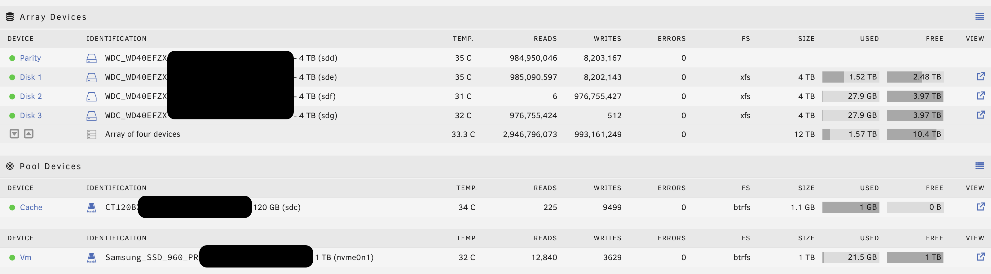

  13. Ahhh.... I see. Is there a recommend size for cache drive? I also have a 1TB m.2 drive in the system and a second 120GB sata drive available, although it's a different brand and age of the other 120GB. What is the best way to get VMs/Docker onto the flash storage? I only have one docker container running right now and I've noticed it doesn't save preferences, each time I launch the app it's like the first time it's run. I would like to use a few more docker apps and a VM at some point. re: "Parity is not a substitute." Parity protects from a single disk failure, correct? I also understand that my server would be vulnerable to physical/geographic issues, fire, flood, theft and plan to eventually back up the entire server to Backblaze/glacier/something. Doesn't the mover service copy the data from all pool devices to the array nightly? Thereby protecting from a single (pool or array) disk failure? Diagnostics attached. I had to re-zip it after the download. If that causes a problem I can post again. boxx-diagnostics-20230118-0642.zip

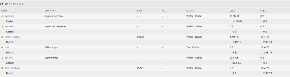

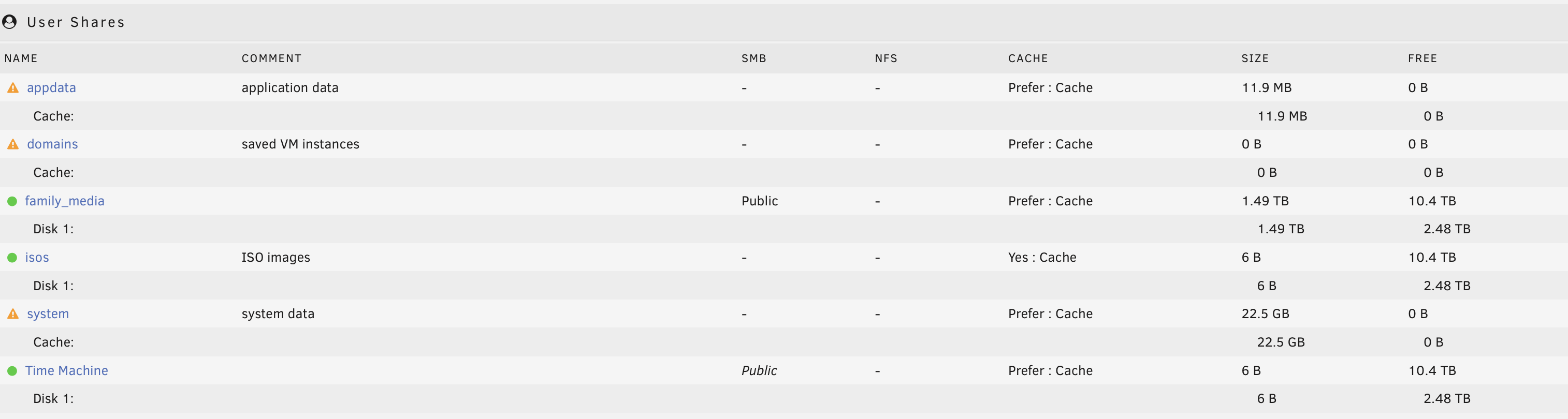

  14. I have 4x4TB drives (1 parity, 3 data) as my main storage array with a 120GB sata SSD for cache. I followed the basic setup instructions but even after a few days the cache drive is always completely full and my shares appdata, domains and system show as "unprotected". I've RTM a bit but I just don't see what I'm missing. (PS-why is blanking out the serial numbers of a disk something? I don't immediately see how that data could be a security issue, could someone enlighten me?)
