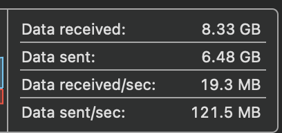

  2. Harder to read as my only laptop is a mac, however I was seeing transfer speeds of 120MB/s when connected directly to the switch the server is on. That's fairly conclusive, it has to be powerline or network related. At least I can now do more troubleshooting.

  4. Client to Server Server to Client That took a while, first time both hearing about iperf and running it! Even I can tell however that is quite conclusive, but I'm not sure how to remedy it. My PC has 2.5G networking, the server has Gigabit, my switch is 1GB, and my powerline adapters at 1200Mbps. I'm honestly not sure where to go from here.
