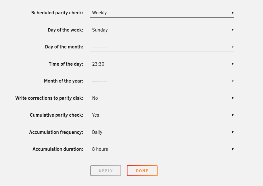

  1. Thanks, I did some reading on that option and now understand it. It takes 8-9 hours now at 200-250 Mb/sec.

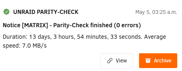

  2. Recently noticed my parity check not completing overnight. I'm running an array of 4 x 8 TB drives. What speed should it run at? This is from the last event log: I'm pretty sure it used to run well over 200 MB/s. What could be wrong and where should I look?
