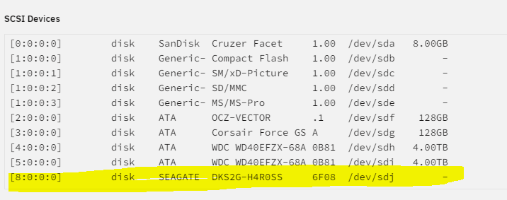

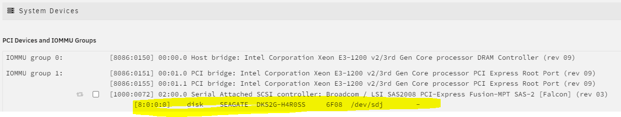

  14. Hi all, I have just installed an LSI SAS 9212 with a SAS drive. It was supposed to come flashed to IT mode - but was not, so I have now flashed it. However, when I check in the UNRAID GUI, I cannot add it to a pool or see it as an unassigned device to format it - but it is recognised in the system devices. Where should I start to sort this?
