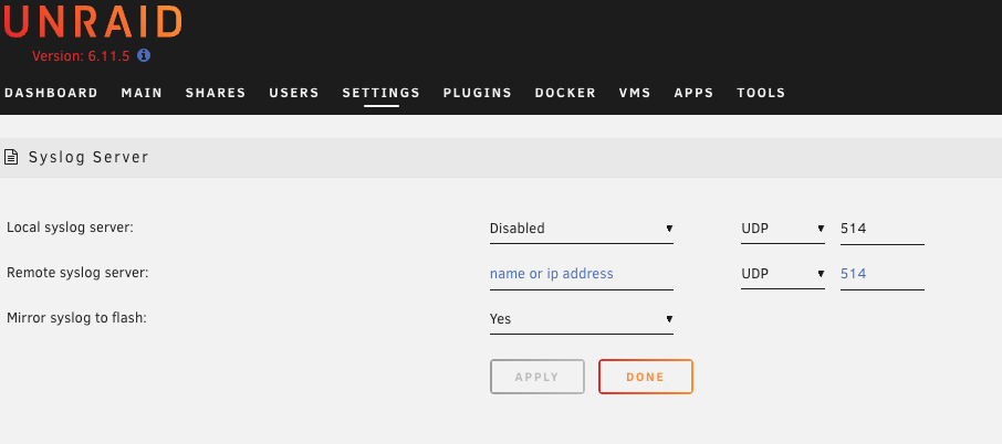

  3. Thanks @JorgeB. I did set up syslog mirroring to the flash. For some reason, when I run: tail -f -n 500000 /var/log/syslog I am still only seeing messages directly after reboot. I am not seeing logs persist prior to the crash or reboot. Maybe I am not looking in the correct spot. I am going to continue to read the syslog messages while the server is operating and hopefully catch the condition before it crashes next time since the logs are not persisting.
  4. Yes @JorgeBI enabled syslog to mirror to flash. For this, should I set up an external syslog server? Does the diagnostics I uploaded include the syslog that was mirrored to flash?
