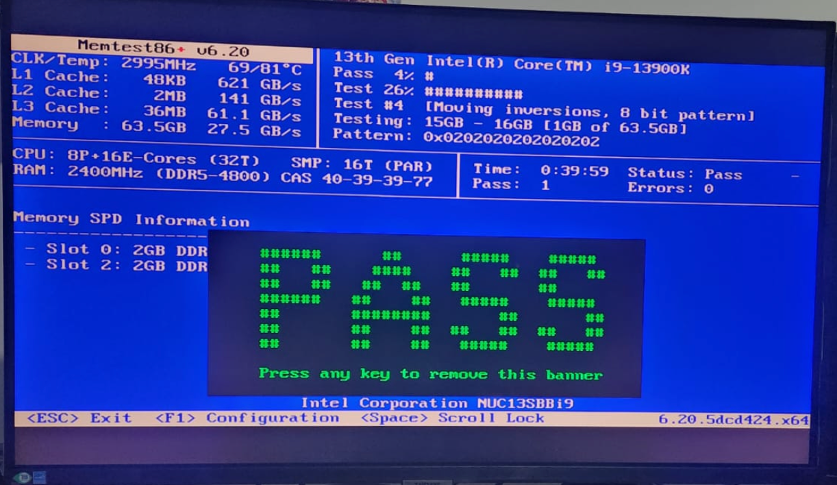

Having an issue after the computer reboots when it was shutdown via NUT
After the memtest, the RAM seems fine. Since the server booted again after the memtest, everything went back to normal. Like I said, this problem only happens when the server shuts down via NUT. I have no idea how that makes it any different.
I forgot to add the complete boot sequence from a minute ago, here it is. I'll perform a memtest now, and post the results.boot_kernel_error.txt.zip

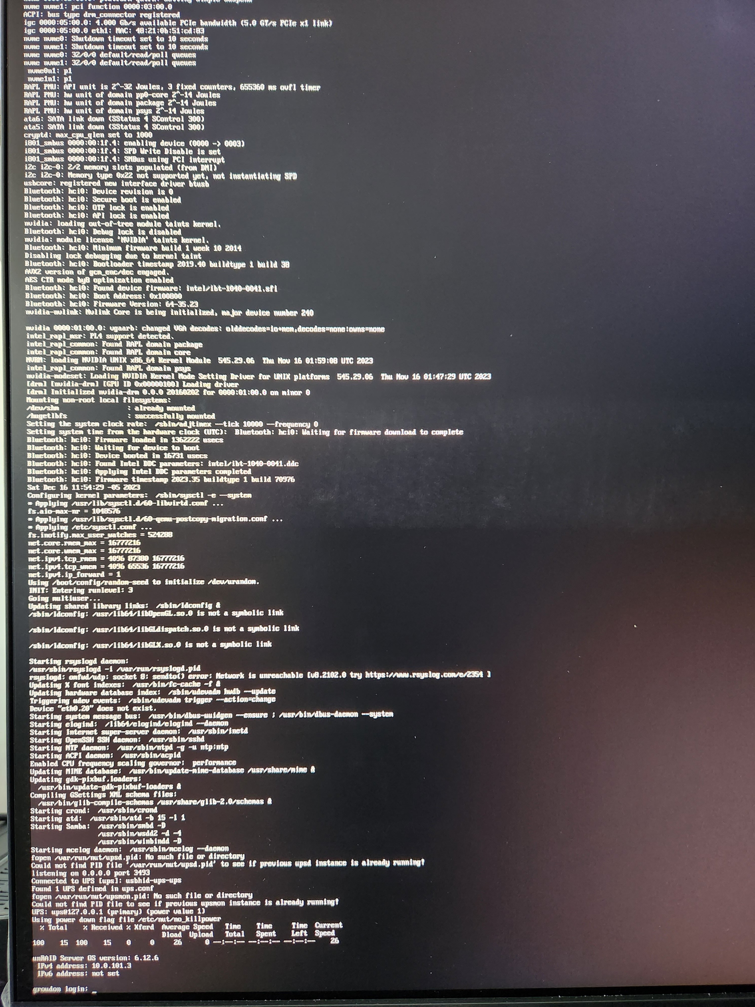

I replicated the event in a controlled way. I was in front of the server the moment the server booted up and the message before it fails relates to a Nut related pid. I'm the image you can see the prompt. However, I can't type anything and the cursor does not even blink. In this state I have no ways of cleanly shutting down because neither ssh, http or the command prompt (with a monitor and a keyboard) work. Does the boot up text provide any further clues?
