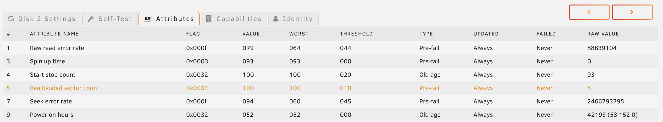

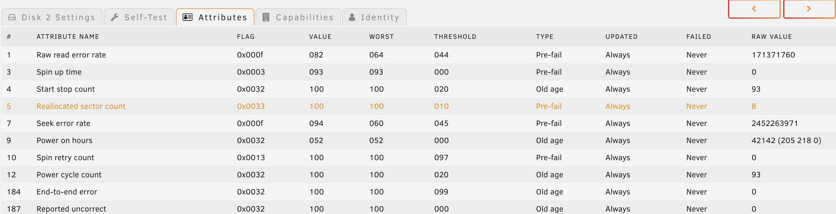

  4. Hi all, Thanks for the support. Parity has been copied and disk1 rebuild was succesful. Next I need to replace disk2, before I replace it should I do a parity check? It currently says parity is valid but the last parity check only took 6 seconds so I'm assuming this is from when I told it to accept parity with the new config? The SMART report of disk2 isn't as bad as disk1 was, however this is how disk1 started before it got worse: Thanks, Frank

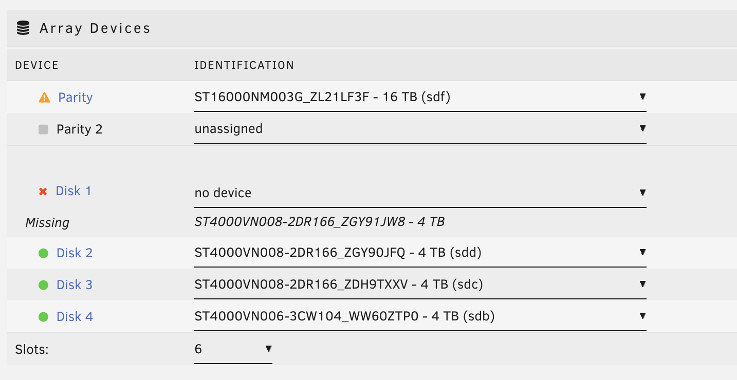

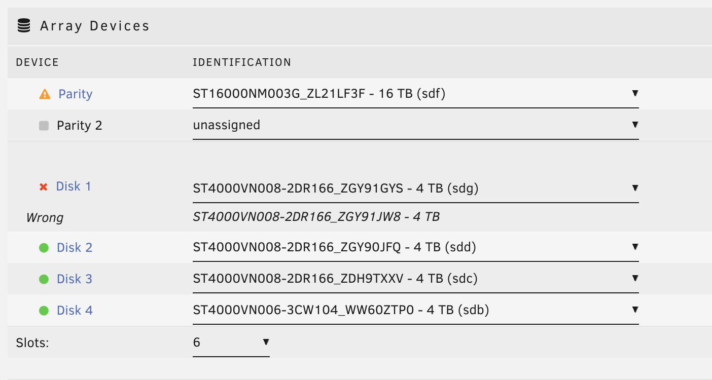

  5. Thanks everyone for the help so far! I've done a new config with the original drives with the parity valid box checked. Seems like the array is back to normal now: I've attached the diagnostics zip file: frank-diagnostics-20260225-1611.zip How do I go about starting the parity swap procedure? Thanks again! Frank
  6. Ah, no then I do think it's still intact. I replaced the parity drive with the new 16tb drive and let it run parity sync until it started showing errors. I then cancelled parity sync and tried to put back the old drive as parity. I have started the array with the old drive back in place but cancelled the parity sync as soon as it started running. No data was written to the array since.

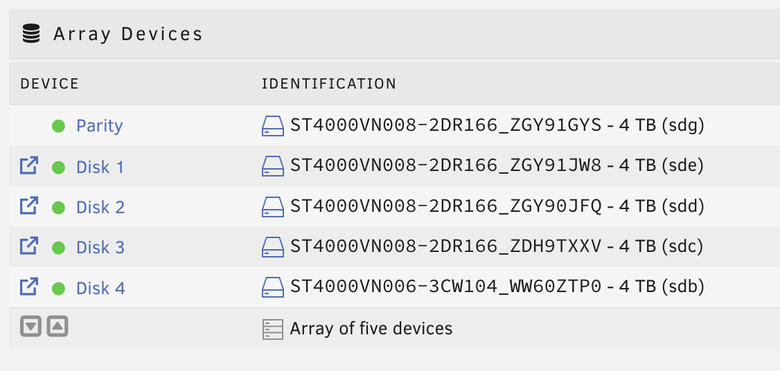

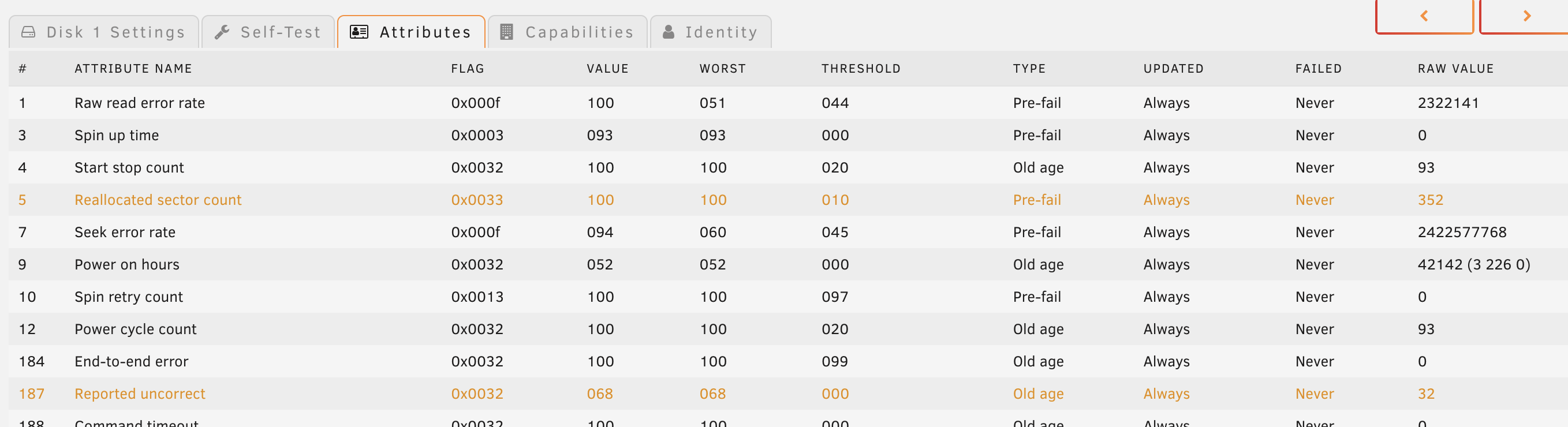

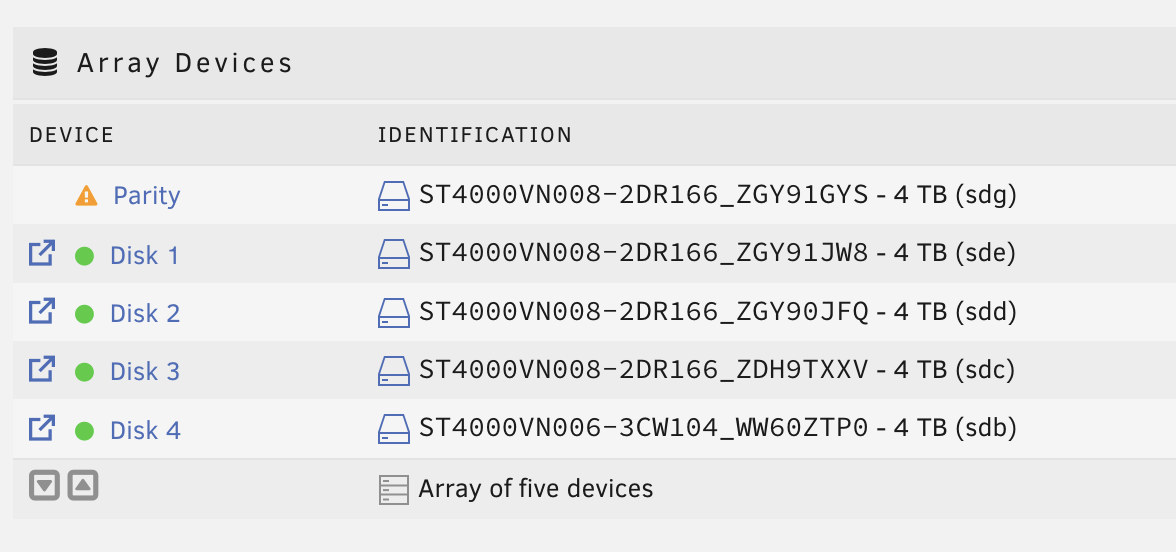

  7. If I try to reassign the previous parity disk as parity it wants to start parity sync, so I assume no..
