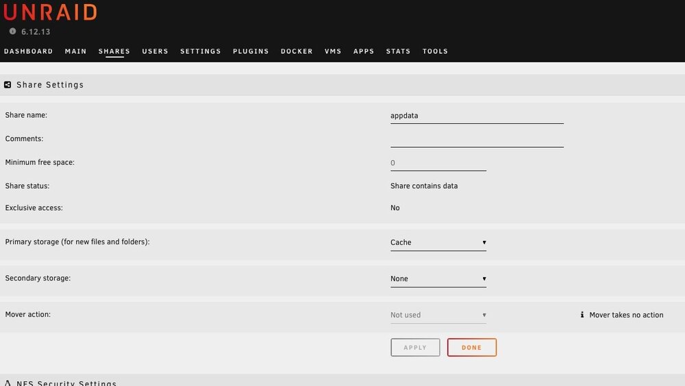

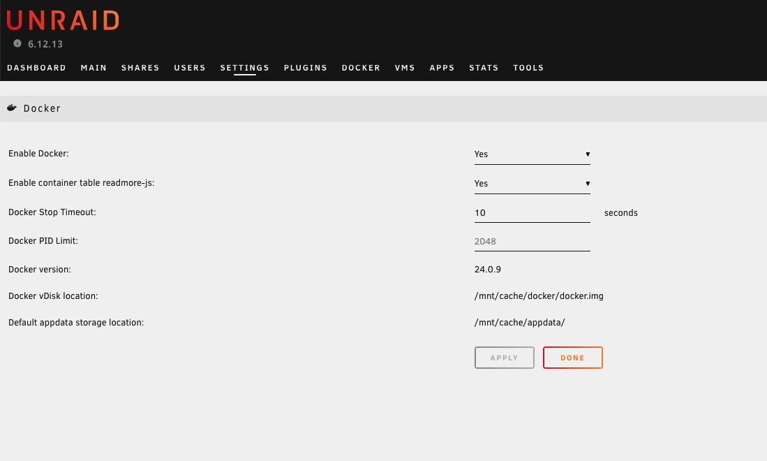

  14. The way you have set it up is that appdata is using two locations. Primary location is cache drive and secondary location is an array. Most likely you have files residing in both cache/appdata and disk#/appadata What you really want is appdata to be exclusively on cache drive In addition docker image should be outside of an array too as Unraid constantly calculates parity
  15. You can make this changes when you setup container template. Config folder can be set either to appdata on cache drive or in the array. You can edit location. From my own experience I can tell you that you will get better performance when appdata is outside of an array. Maybe create another share on cache called appdata1 and select it for config folder when installing cointainer
