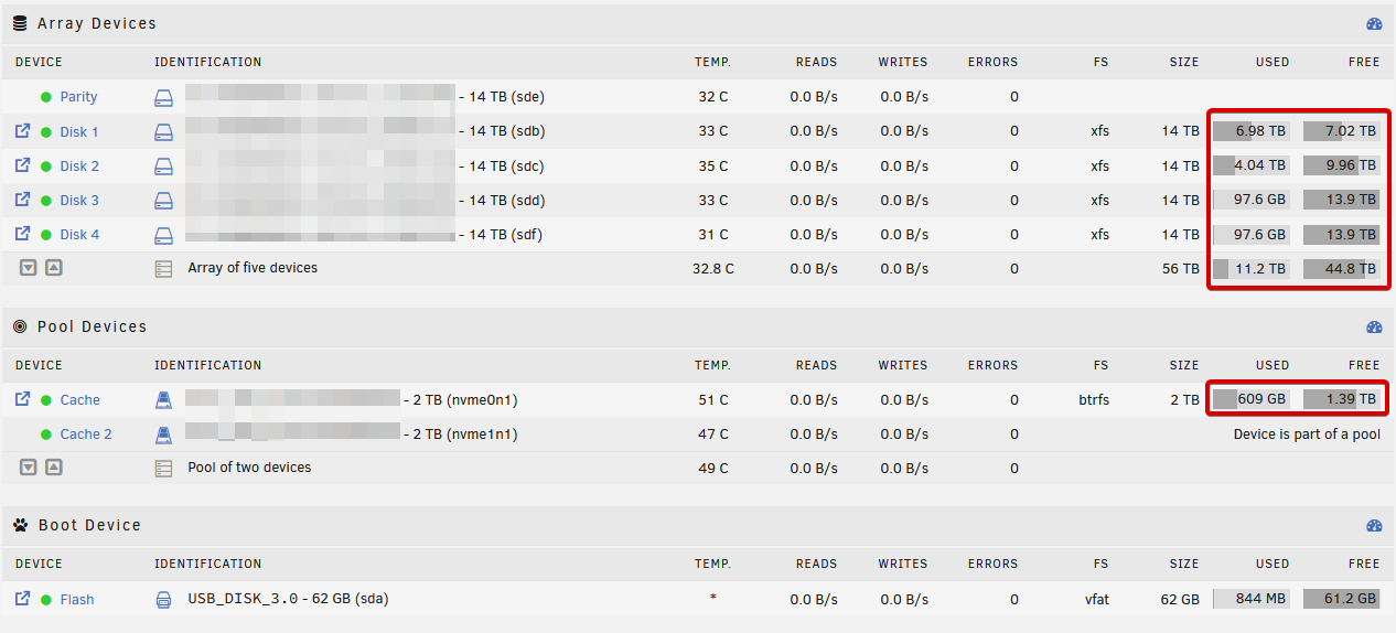

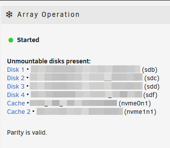

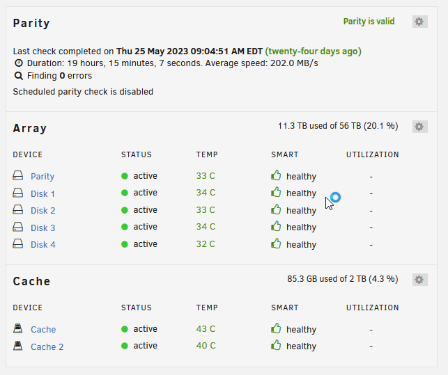

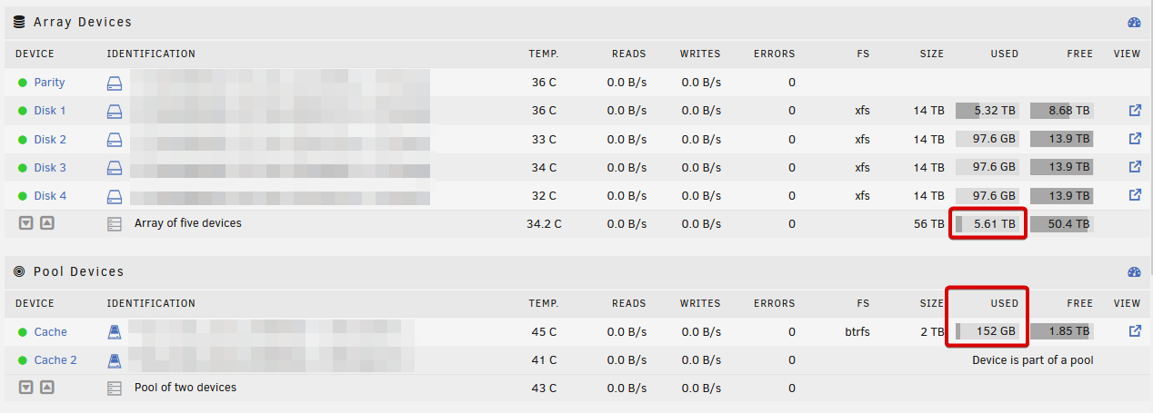

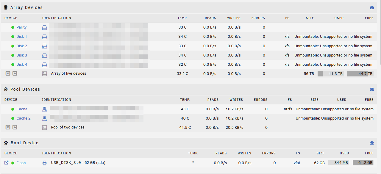

  6. Thanks in advance for reading this. I'm hoping it's a quick fix. After restarting the server following an update from 6.11.5 to 6.12, I manually started the array as it doesn't come back automatically. I then started all of the docker containers again, as they didn't start automatically. No worries with that. I noticed, however, on the "Main" page that I can no longer see the usage per disk. I now see "Unmountable: Unsupported or no file system" for my drives. It's worth noting that the Docker containers are running and I can play media through Plex, so it appears to be working. The only difference is the error that has taken the place of the used/free space for each drive. Diagnostics are attached, as well as screenshots showing the before and after of the array, the array status showing all is well, and the array operation area. Before: After: Array Status: Array Operation: Diagnostics: unraid-diagnostics-20230618-1610.zip
