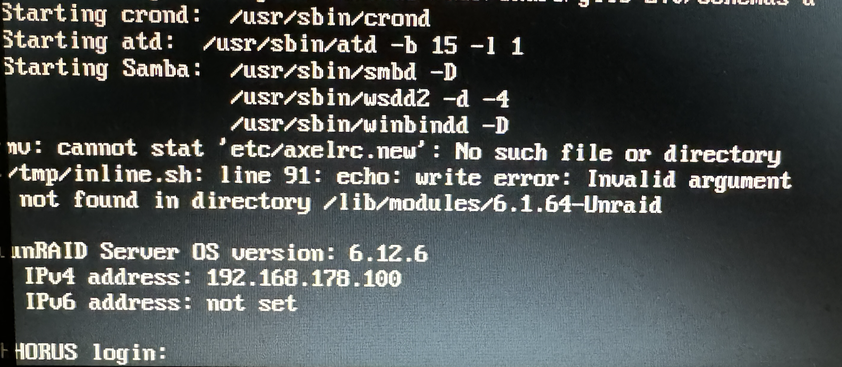

  3. All right, I deleted the plugin at "config/plugins/theme.engine" stored it on a separate disk). Unraid boots as expected, displaying familiar error messages similar to those captured in the provided screenshot. While all Docker containers and virtual machines are functioning properly, the web GUI remains inaccessible, showing a blank page when accessed via the assigned IP address. I think we can exclude a plugin error from Theme Engine.

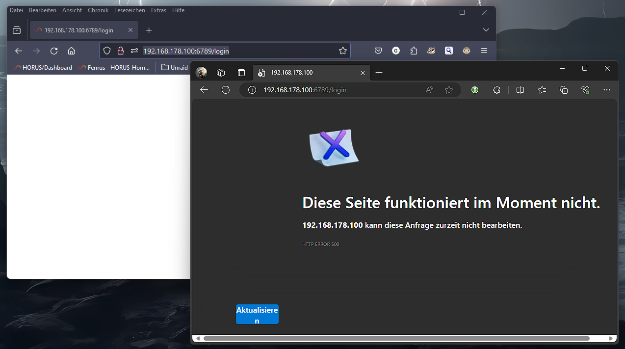

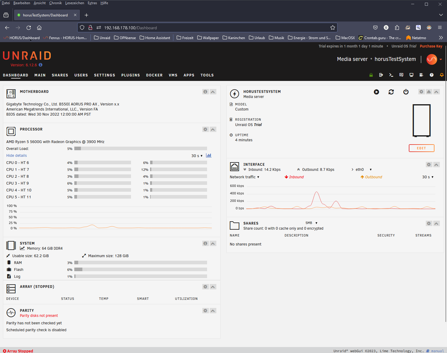

  5. So I boot with a new flash drive, Unraid boots without any problems. The web GUI is also showing up. I used the same IP address for testing.
  6. I get a white page on Firefox and an Error 500 on Edge.

  8. Hello JorgeB, thank you for your support. I edited the dynamic.cfg and set the theme to white, like you said. After a reboot the GUI still isn't there. I noticed some errors while the system is booting. Maybe that could be the main problem? Thanks allot.
