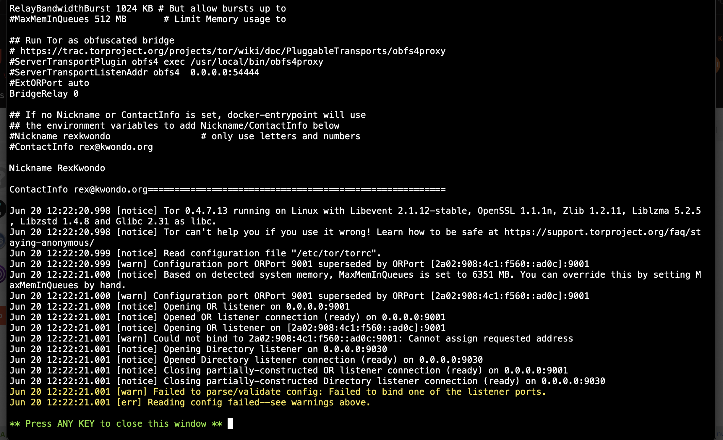

  9. That was it! Thanks so much for your feedback. Turns out I didn't even have ipv6 enabled on the server at all (and for some reason the option to enable ipv6 was greyed out and unavailable). Adding the correct ipv4 address to torrc fixed it and now the app runs.
  10. I installed tor-relay and followed the instructions but the docker application won't run and I get the following error when I check the log: Jun 20 12:22:21.001 [notice] Closing partially-constructed OR listener connection (ready) on 0.0.0.0:9001 Jun 20 12:22:21.001 [notice] Closing partially-constructed Directory listener connection (ready) on 0.0.0.0:9030 Jun 20 12:22:21.001 [warn] Failed to parse/validate config: Failed to bind one of the listener ports. Jun 20 12:22:21.001 [err] Reading config failed--see warnings above. Any idea what's going on or how I can fix this? I edited the config file and it looks fine, and port 9001 is set correctly (as far as I can tell) in the docker settings in Unraid. Attached is the full log image.
