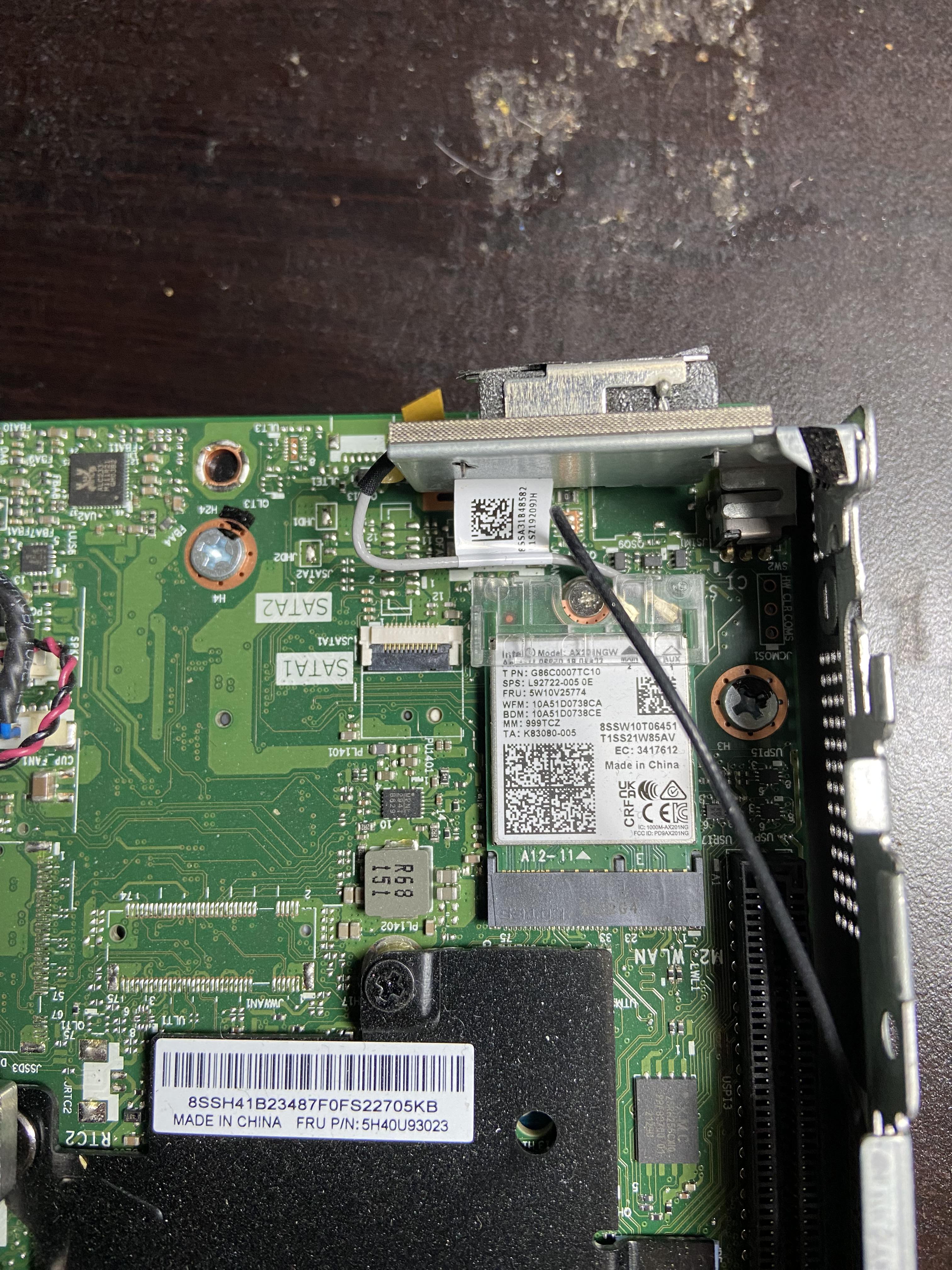

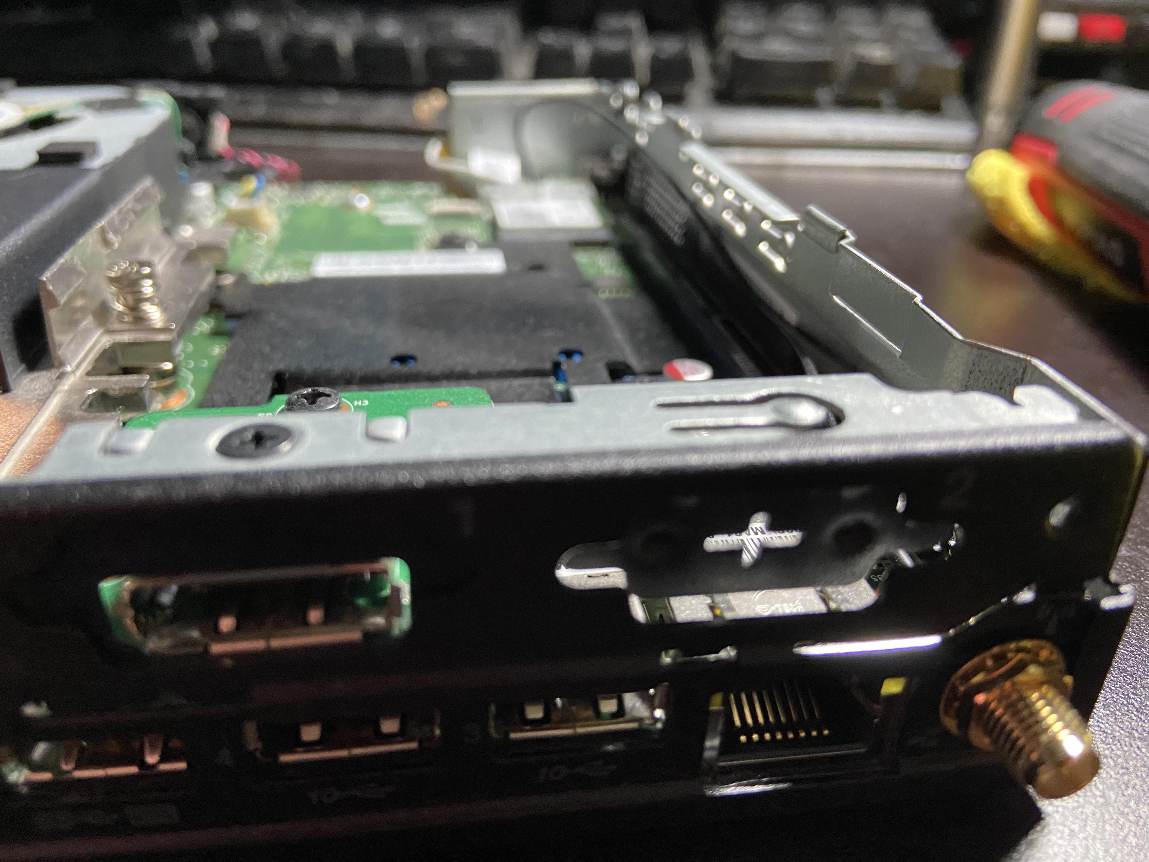

  3. Since deciding to go with UNRAID, I've had problems with it crashing. It runs fine, sometimes for days, and then I'll go to log-in to the web interface and I can't connect. The computer is still on, but I can't access it. There's nothing in the syslog to indicate why this is happening. Unfortunately, I started getting into UNRAID without doing enough reading beforehand, so I have it running on a Lenovo Think Station P150 Tiny using a USB hub connecting 6 external drives (4 x 16TB (including parity drive, 1 8TB, 1 4TB, all external) and 1 internal SSD 2TB used as cache. Since I can find no errors in syslog, I assume the issue I'm having is hardware related, and I've since learned that USB can drop connection, and that I should really be using SATA, I'm thinking maybe that's the problem causing the crash. So, first things first, I need to see if I can add an expansion slot to this board. It's a mini-pc, so I don't know what special versions I need to still fit in the case. I see the board has SATA1 and SATA2 printed on it. I've got what could be a PCI or PCIe slot in there. Can someone with more knowledge than me tell me what is best to do. Ideally, money no object, I'd build up a whole new PC that has many SATA ports with space for many drives and I'll plug each drive directly into the board through individual SATA ports using no multipliers or eSATA configurations. But what can I do with this setup and all these external drives? I've thought of pulling the external drives from their cases and getting an enclosure, and using eSATA, but only if I can add it, since I don't have an eSATA port. I assume any USB to eSATA adapter defeats the entire purpose, but I need to connect at least 6 drives. attached are some snapshots of my board and the manual for the think station p350 tiny. p350_tiny_hmm.pdf
  4. Looking at various 10-bay drive enclosures, it doesn't seem like any of them have a SATA out port, so what's the best way to do this?
  5. I've been reading that you shouldn't use USB connected drives for UNRAID, but only direct SATA connections, because USB can drop out, which causes problems with UNRAID. Not knowing this, I already have 8 drives on a USB hub connected to a Lenovo think station. Would it be any better if the drives were placed in a drive enclosure, and all SATA connected there, but the enclosure then connects to the think station via USB 3 cable? Is that exactly the same risk of USB dropping? Would I need to crack open the think station and create a SATA connection and get a drive enclosure that connects to the think station via SATA? I don't know when I'll have the money to set all that up, but when I do, I want to make sure it would actually make a difference.
