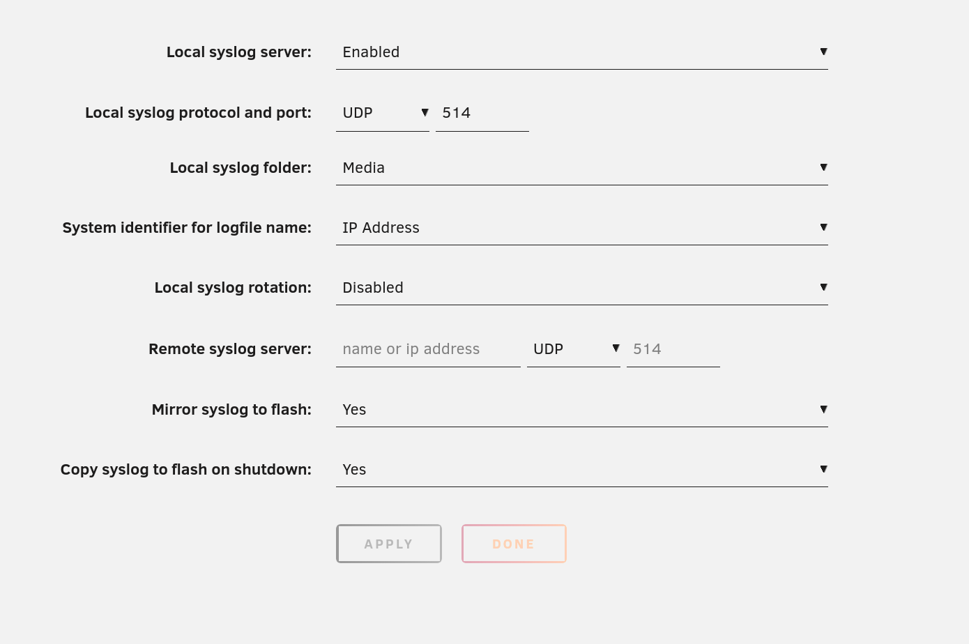

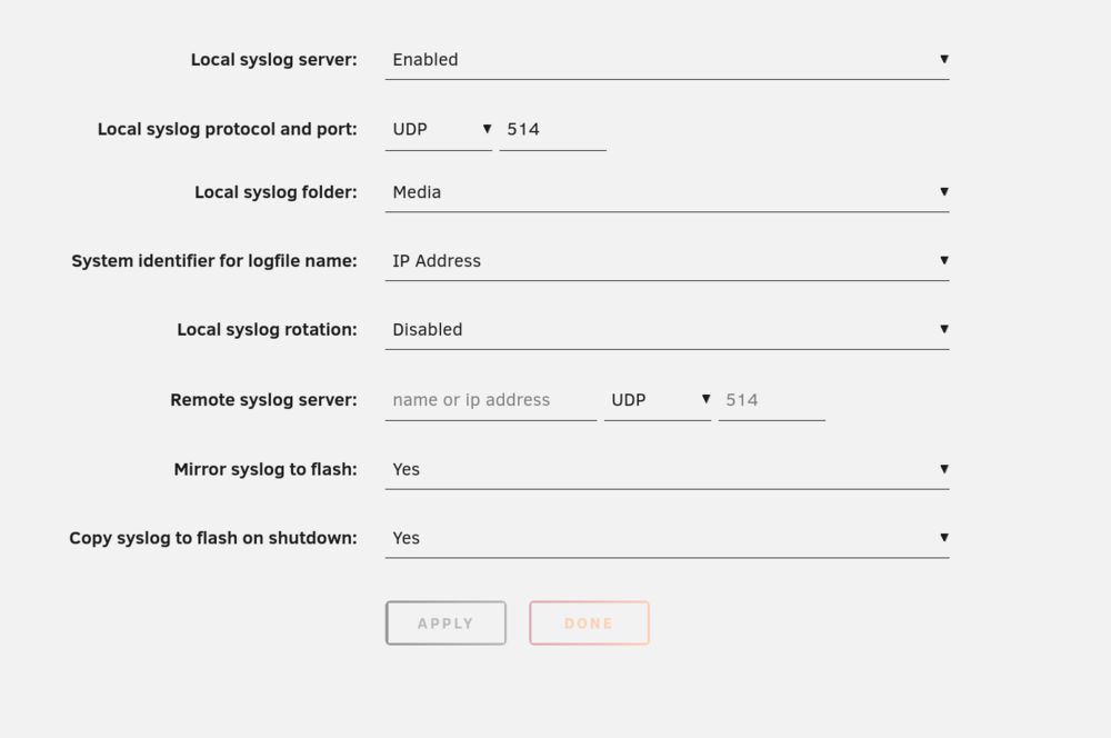

  4. Sorry I'm not entirely tracking this. You said setup a syslog server (which I have done and it's writing to boot USB which I'm fine with). Did you get all of the logs you needed? I can try in Maintenance mode, that's something I haven't tried. I just had another freeze (not rebuilding, that was paused, I was moving some stuff via ssh and nextcloud was syncing some stuff over samba). EDIT: I'd imagine you mean safe mode nor maintenance mode. Doesn't look like a rebuild will work in maintenance mode from what I'm reading.
  5. I thought the post (two ago) that has syslog and syslog-previous is a syslog server....I have that enabled and writing to my boot drive (USB). Those are the logs. I'm not writing that much, a bit but yes, the rebuild hasn't finished. I currently have it paused and the server is still crashing. My syslog screen is attached.
