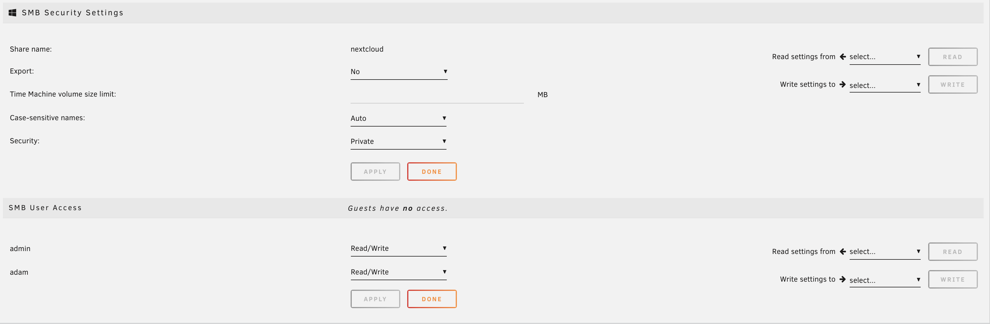

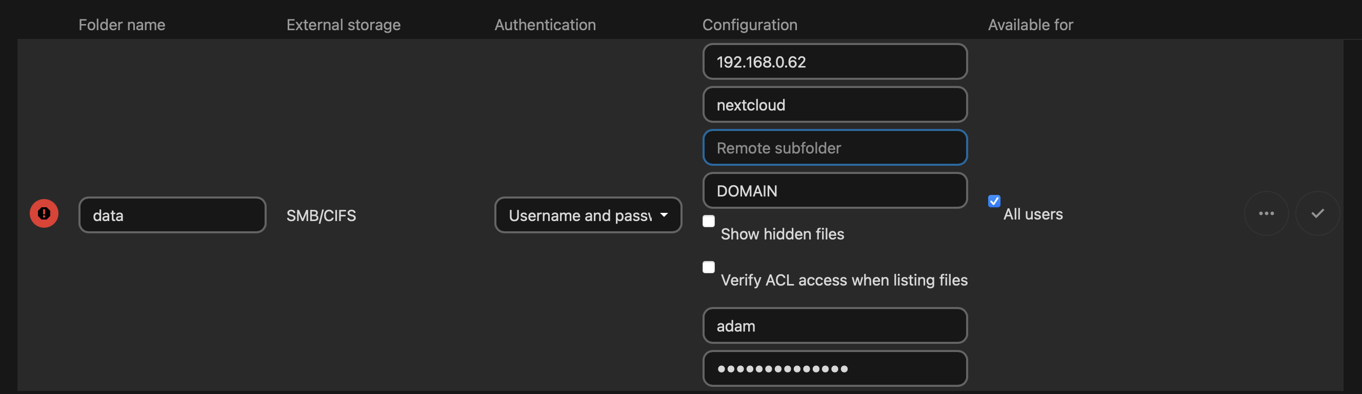

  4. First time setting up Unraid virtualized in proxmox. It's running fine and I can access the GUI, setup array and create shares. I created a shared user and set a share to private with the user having read and write access. However, I can't seem to connect to this share via Linux, Nextcloud external storage or on my Mac. I can ping the VM running Unraid not problem from the other containers running on my Proxmox server, so network connections seems fine? Debian 11 running nextcloud: mount -t cifs -o rw,vers=3.0,credentials=/root/.smbcredentials //192.168.0.62/nextcloud /root/unraid-nextcloud mount error(2): No such file or directory
