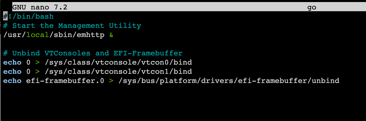

  5. Problem solved. Installed Unraid ver. 6.10.3 on exactly the same server (I have 2 exact same ones) Basic settings applied to syslinux (intel_iommu=relax_rmrr video=efifb:off) and NVIDIA moved under a separate group. Pass through worked out of the box. Freaking fu$%^& insane if you ask me. How can you break one of the main functionalities/ advantages of Unraid and not look into it considering many people are clueless...

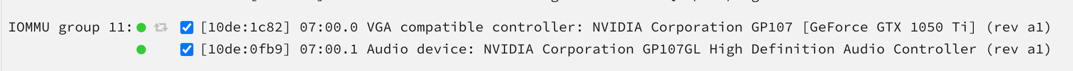

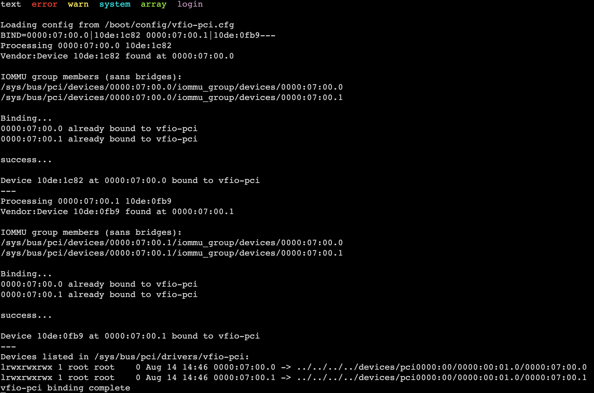

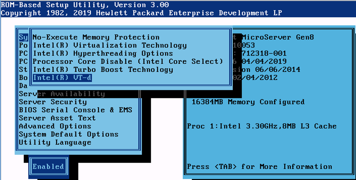

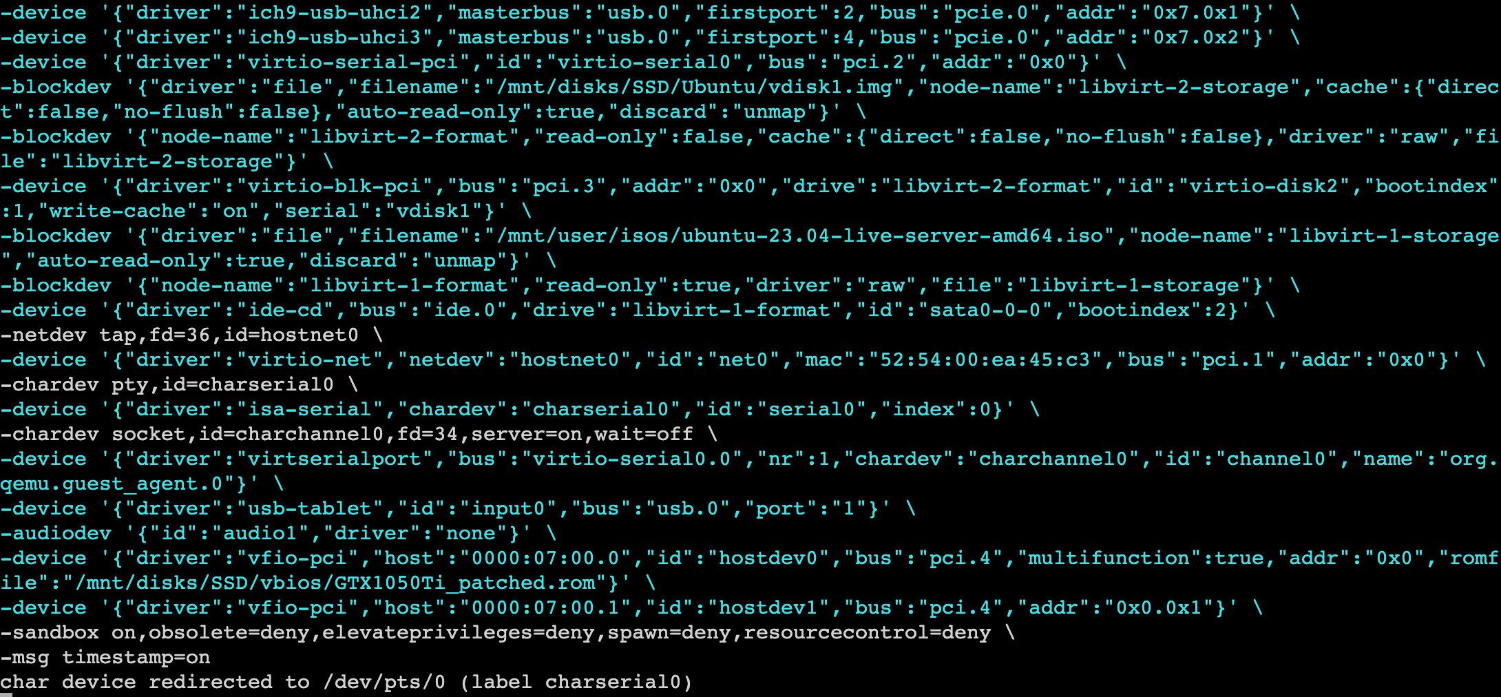

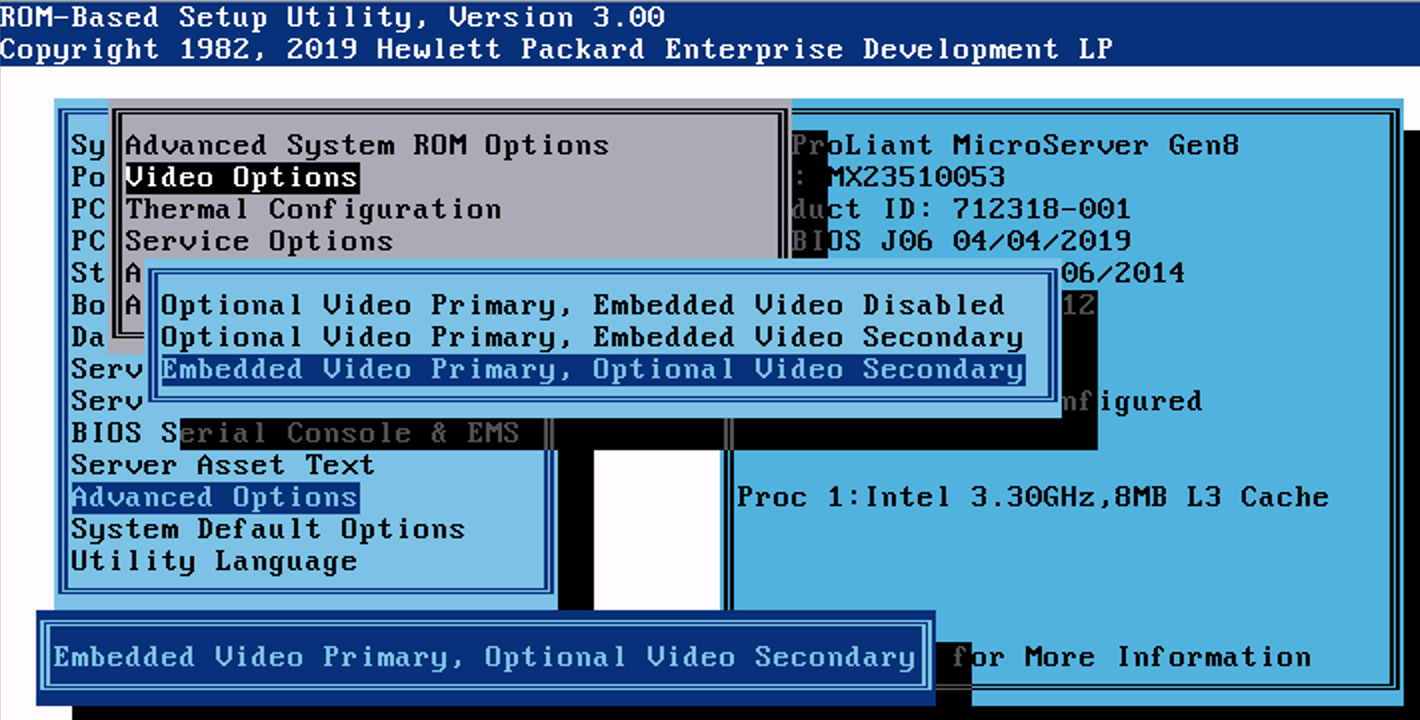

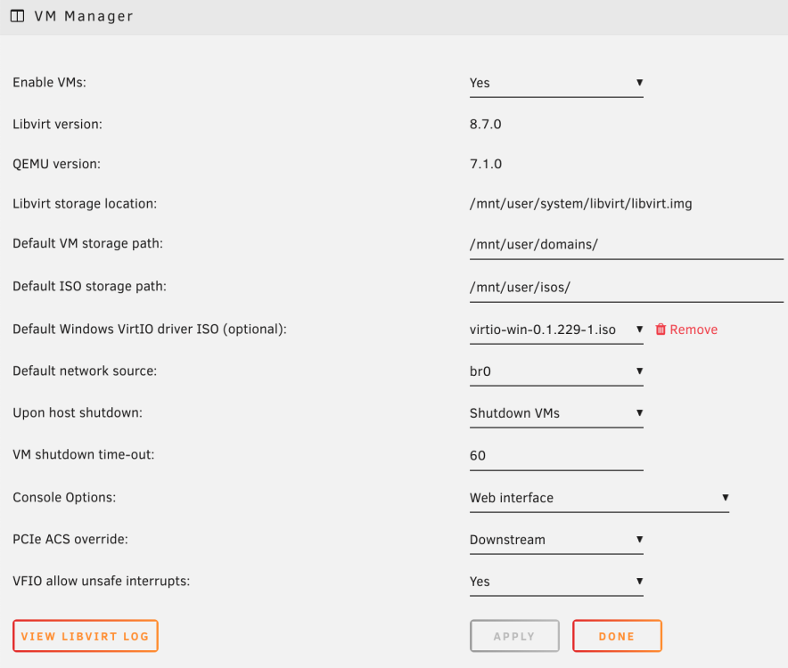

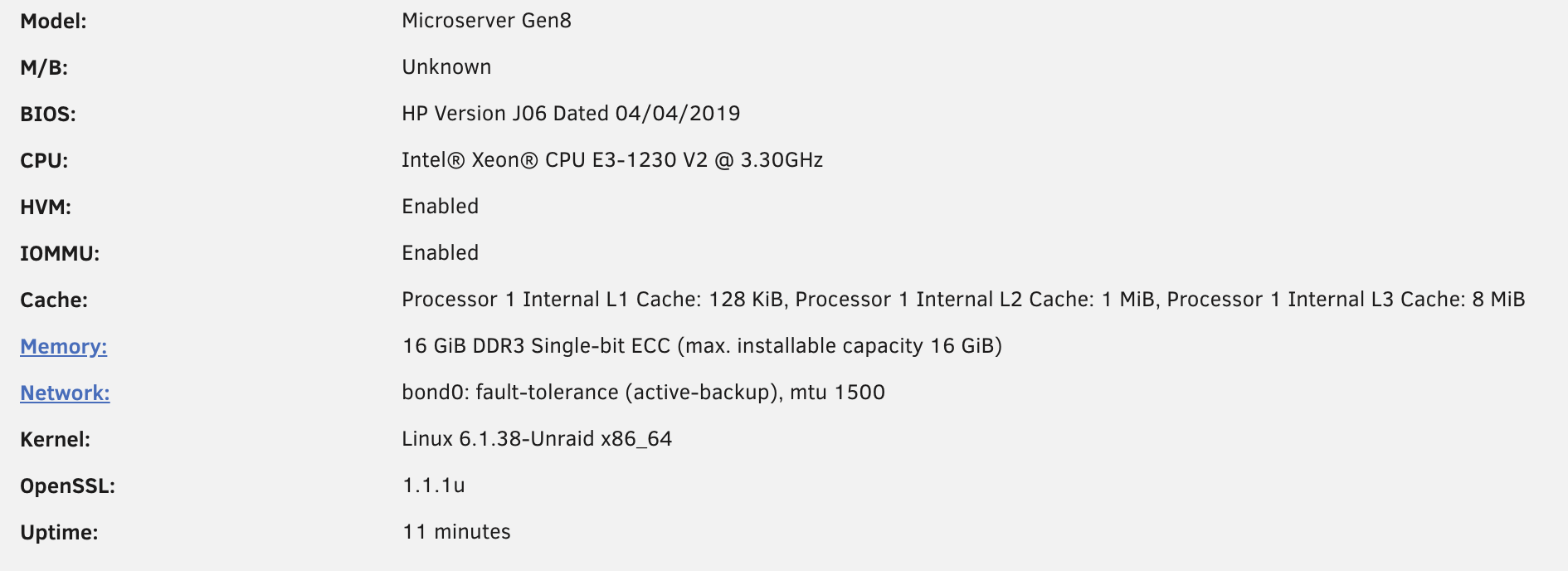

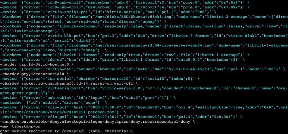

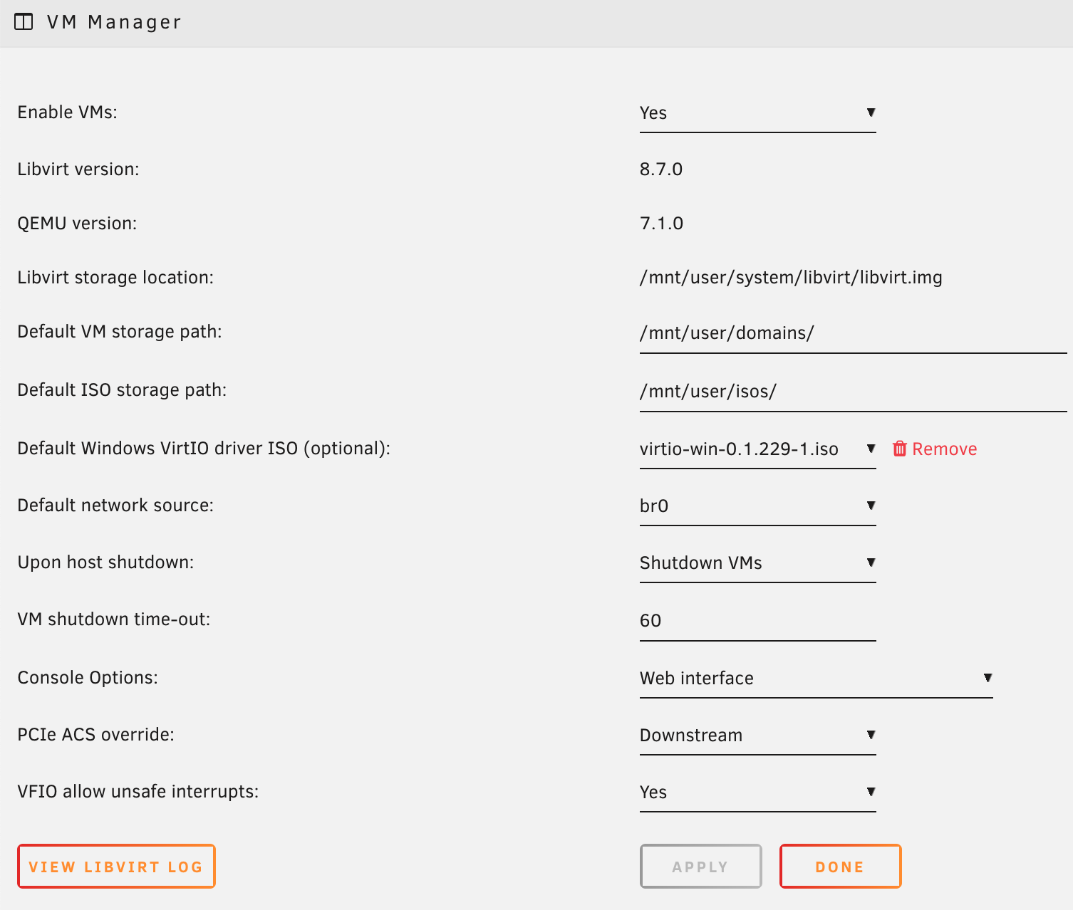

  6. Wonder if anyone have any ideas? Thanks
