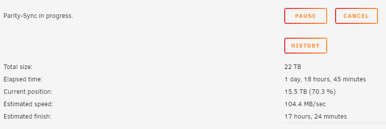

Parity sync is complete. Turning on Docker and going to run Plex and all the other services, and see if I can get it to crash again, now that it's not stuck in some Parity sync/check loop while the containers are going. Will report back if/when it crashes.

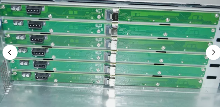

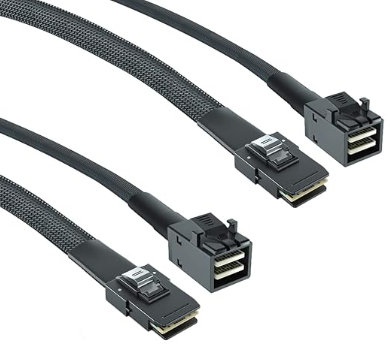

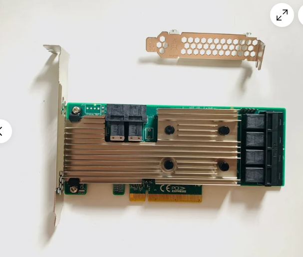

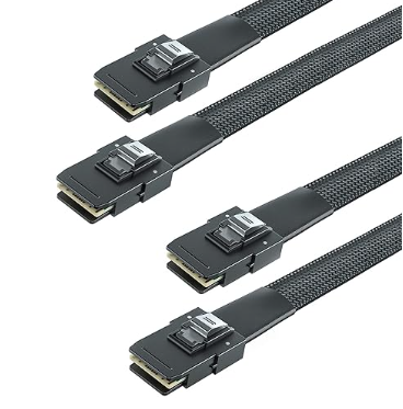

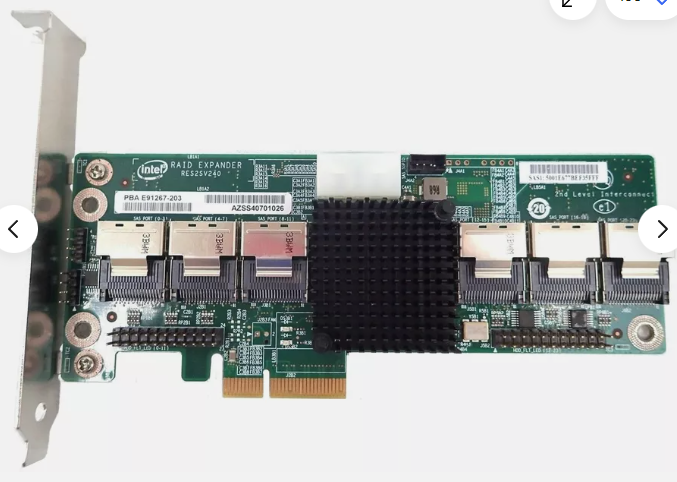

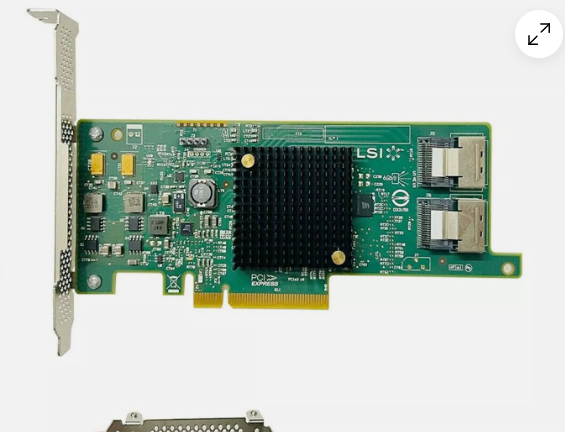

Hey guys and gals! I'm looking to update my system, and was wanting to limit the amount of Raid cards/Expanders I have in my system to limit possible hardware failures. My 24 hard drives vary from 16tb to 22 tb WD Red Pros. I'm using a RROYJ 24 Bay rackmount chassis, and it has a total of 6 backplanes, with 6 total SAS SFF-8087 ports. Currently I have a LSI 9207 8i, and an Intel Raid Expander res2sv240. So right now, I have 2 SFF-8087 cables going from the LSI 9207 (one going to one of the SAS backplanes, and another cable going to the Intel Raid Expander card). Then I have 5 cables going from the Intel Raid Expander, to the other SAS backplanes. I want to know if there is a single card I can use that will work right out of the box, that has 6 ports to connect to all 6 backplanes of the HD bays without needing to use an Intel Raid Expander card. I was looking at possibly getting this 9305-24i 12gbps IT mode card. This uses the SFF 8643 cable I think? I did see they made an SFF 8643 to SFF 8087 cable. Will this card and type of cord work alright? If so, I can just get 6 of these below cables, plug everything in and be good to go correct? I appreciate all the help!

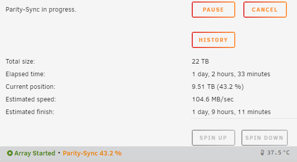

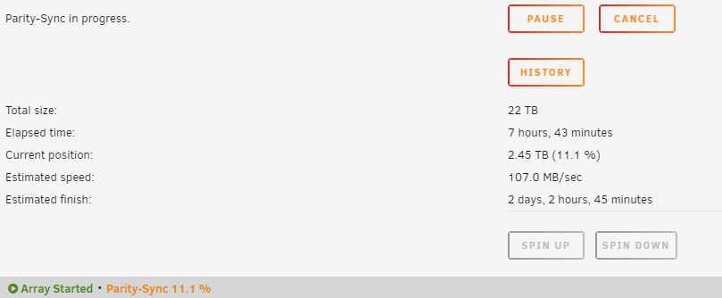

With Docker disabled, it has been crash free so far *knock on wood*. The parity sync is running. 22TB parity sync, at 100mb/s is going to take 2-3 days to complete if the speeds stay the same. Uptime is almost at 8 hours, and it hasn't crashed. I still got quite some time before the Parity sync is complete. I made the mistake of removing parity drives and switching them around, reassigning them, so I have to do this parity sync before I proceed further so the array can be protected.

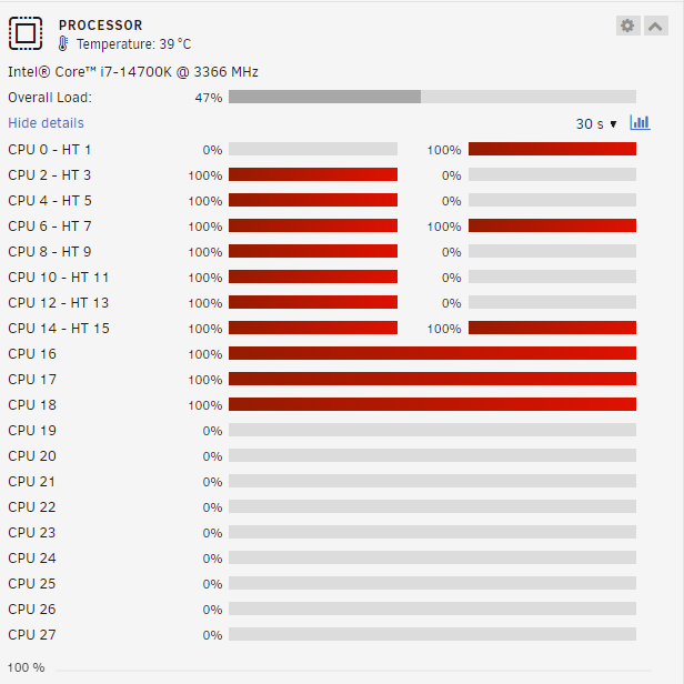

Ok, it only lasted an hour, and it crashed again, same issue and same symptoms as all the other crashes. So I guess it wasn't the flash drive, but I'm glad I replaced it! I did have the WebGui open when it crashed, and I did scroll over to the dashboard, and saw that the cpu was pegged at 100% on many of the cores. I also removed 2 of the 4 32gb ram sticks, maybe to see if that would have any effect. Restarted and am trying again. Will report back.

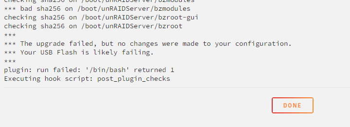

I think i may be onto something. I saw i was running an older version of unraid (Unraid ver. 6.12.8), and I tried to update to the latest version. Attached is the error I got when I tried to update to the latest 6.12.13 It appears my usb flash drive is failing. Luckily I was able to backup the flash drive, so i will be moving over to a new one. Will post an update after I do this! Thanks everyone!
