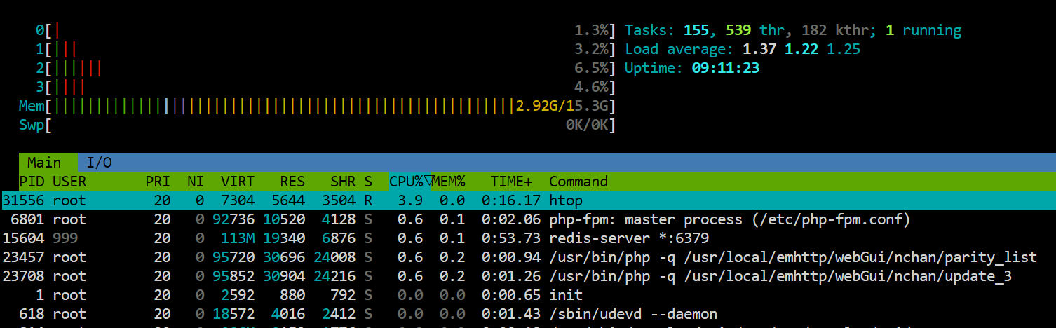

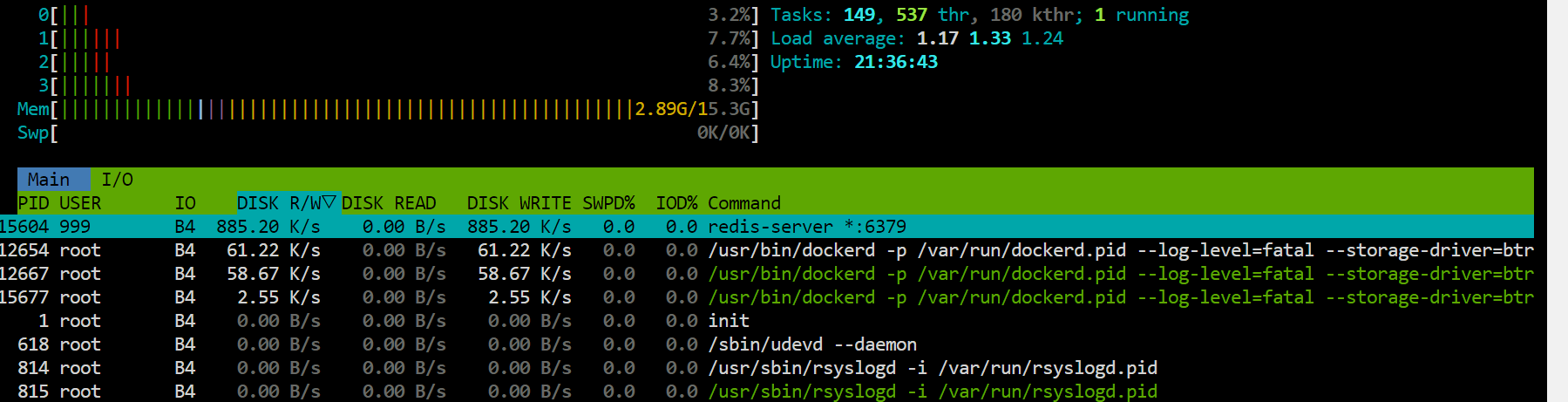

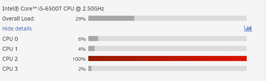

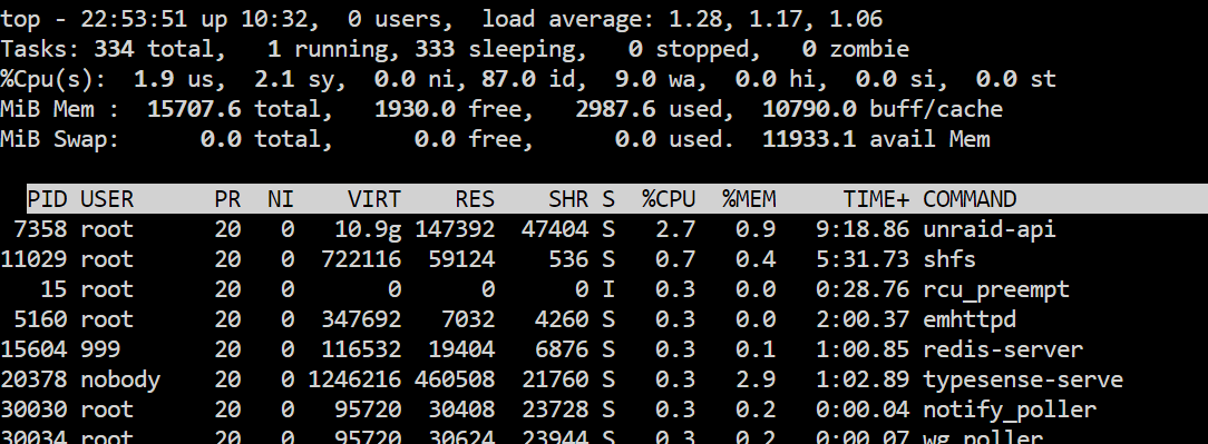

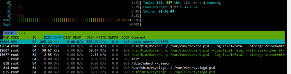

  7. I'm trying to figure out why 1 core alway stuck at 100% . I ran Pihole , Immich, and Krusader docker only. Shares is using cache drive. Set spindown at 1hr I posted on Reddit and got told there is something constantly write/read on my array. Htop and top results (below 1/4 of the bar) are different with Processor % on Dashboard UI (between 25-50%). Can anyone help me to investigate what going on? diag.zip

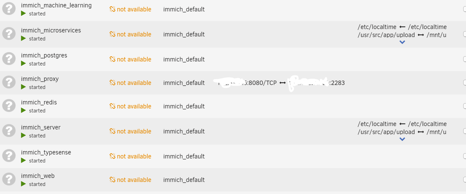

  8. I've sucessfully installed Immich Docker Stack (using Compose Manager) and it's running. But i noticed there are many running Immich dockers/services on the Docker display. Is there a way to combine or group them into 1.
  9. minhdan123456 joined the community
